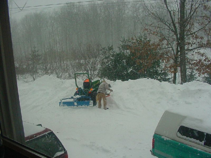

Can't really say I've had any bad experiences. However, the FEL definitely is not the way to go if you've any appreciable snow (> 1"). The loader is good for pulling snow away from the buildings or vehicles. If you're careful, you can get mighty close, then back drag the snow away. Another use is to pile the snow if you need more room to push it.
I also use the back blade to push the snow. This is good to 8 to 10". I never wait for the snow to end...if it's going to be blizzard type conditions, I start when it's about 8" deep.
The attached pic is from the blizzard we had last winter. We got 30 plus inches. I was moving some piles back when the front end sunk in.
As you can see, I did get stuck a couple times (no chains) and the pile in front was a bit too soft to use the FEL to push away. So, a bit of shoveling to get out.
I do love pushing snow though! Bring it on!

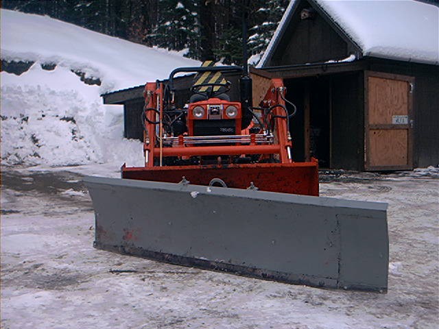

I agree w/Boondox about useing fel to remove snow on long driveway..try it for one season seems it took way to long for clean up. /forums/images/graemlins/crazy.gif
Have you consider attaching a plow to your bucket??..than lower the bucket couple inches from the ground so the plow blade floats.
You can cut the clean up time more than half,plus stack the snow twice as high than the fel...just idea. /forums/images/graemlins/wink.gif
