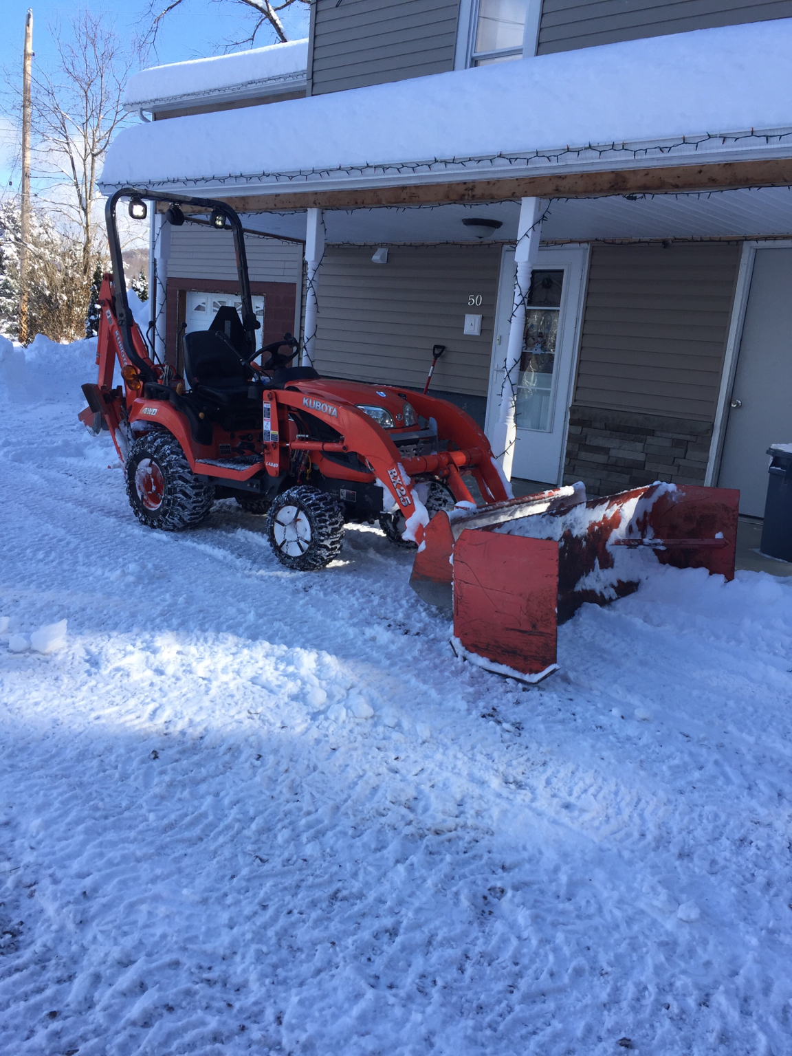

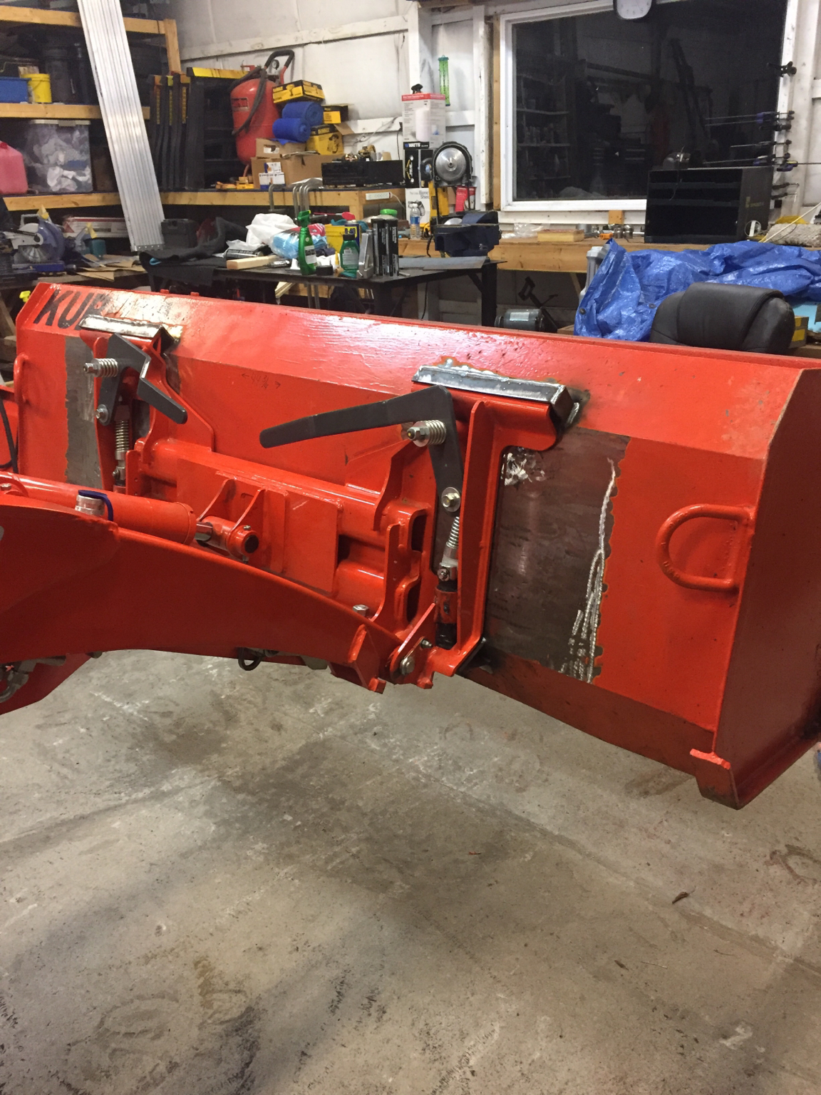

I built mine several years ago for my bx25 then added a back drag. I recently modified it to use on the ssqa on my BX23s. It also works great for pushing piles of topsoil an pushing piles of brush. I made the back out of 3/16 so it will take a lot of abuse.
/ Snow Pusher`s
#26
View attachment 529858View attachment 529859View attachment 529860
NICE JOB...!!!!!!!!
I`m hoping for a similar design like yours with the quick attach. I also have the BX23s tractor...love that lil tractor.
I was thinkin of the same thing, use it to push other things around besides snow.

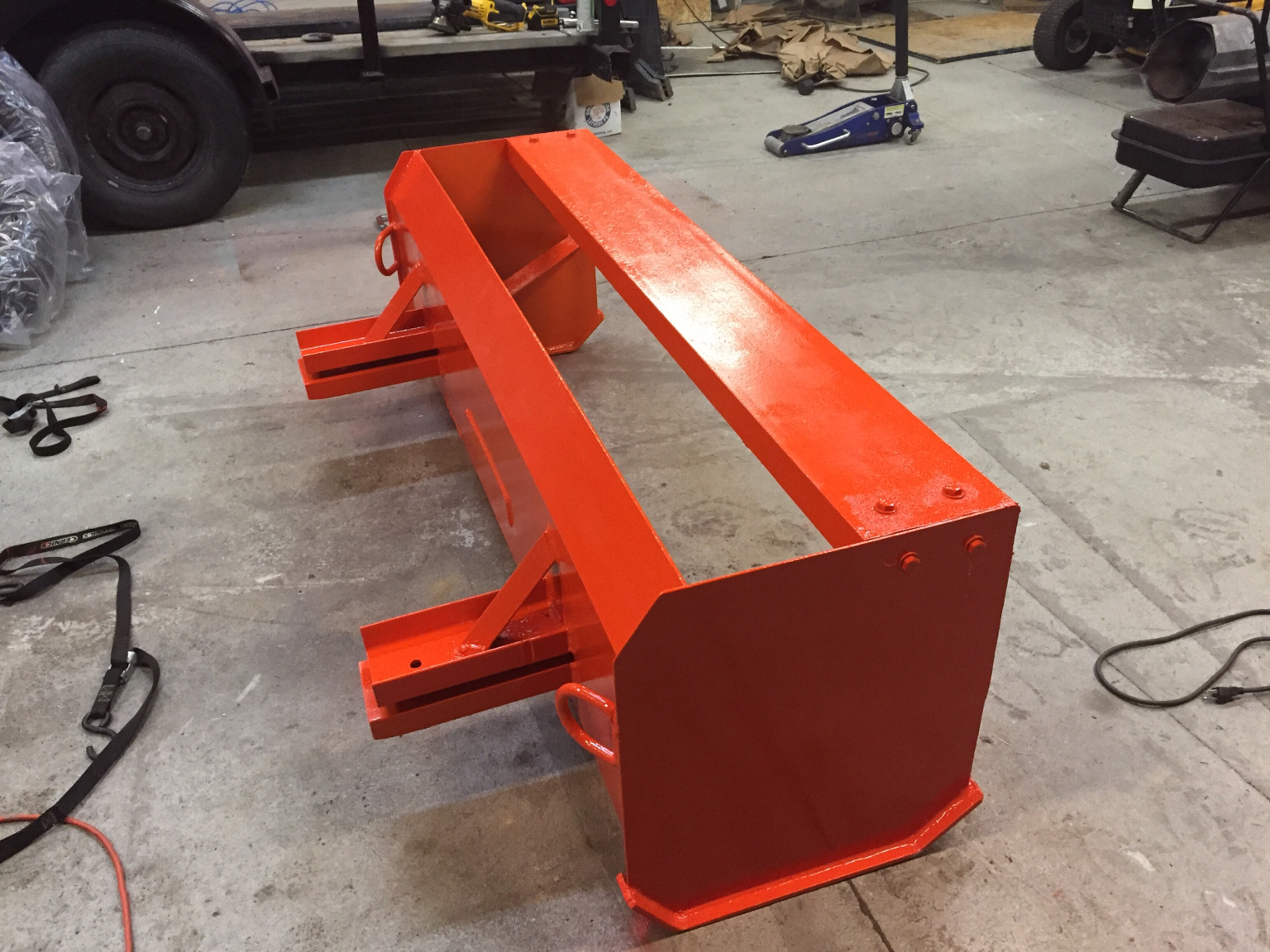

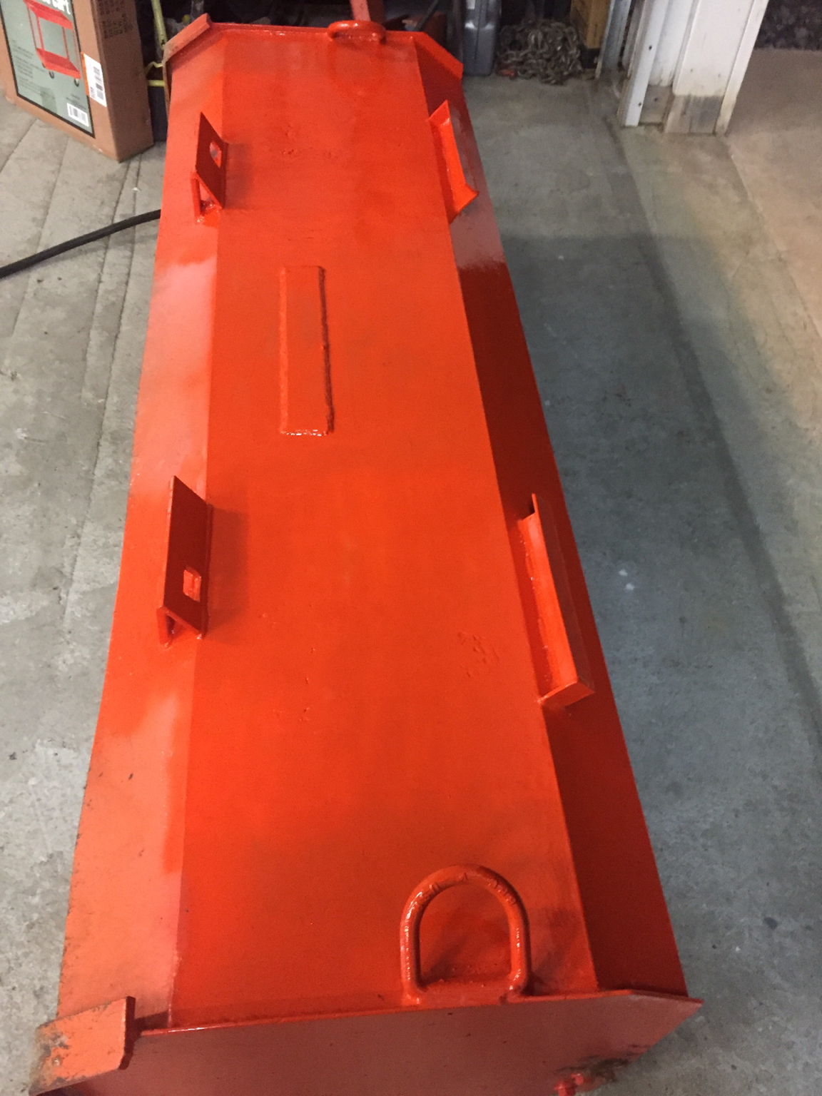

If you live in a farming community like I do, junk yards are full of old farm equipment. My brother found a beat up rusted 84" FEL bucket off some unknown tractor. He cut the bottom and top off, leaving metal in the corners for support. He welded a QA adapter on the back and after a coat of orange paint it looked like a new implement. He's still using it on his L3430. If I get over to his place over the holidays, I'll take some pictures. An 84 incher would be a bit heavy for a BX but you might find an old 72" bucket around somewhere to modify.
Thats a GREAT idea...!!!!! And we do have a couple huge tractor salvage yards about 3 to 4 miles from my house.
I`ll have to go there an look around this weekend... never know what i might find! Maybe even some pallet fork arms might be sitting there.

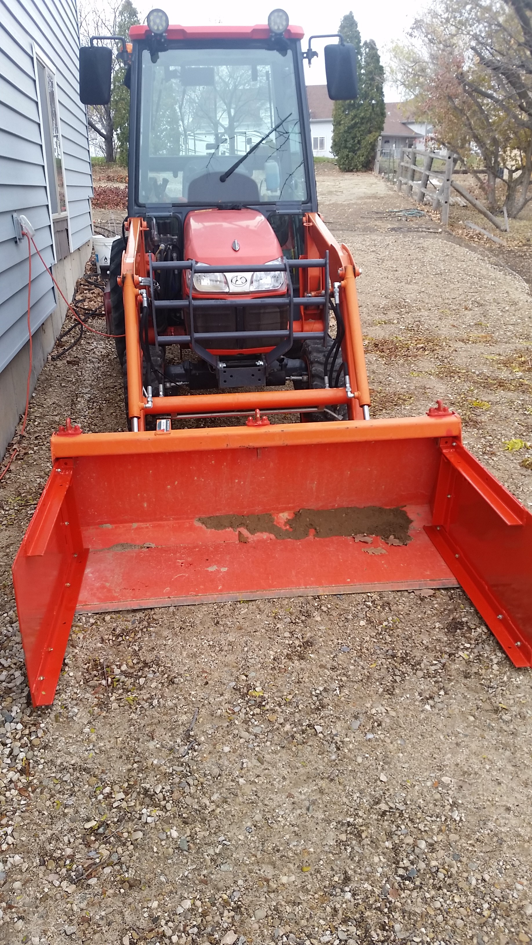

I also took a shot at making a snow pusher by adding wings to the bucket on my tractor. No snow yet but looking forward to giving it a workout.
/ Snow Pusher`s
#31
Post some pictures when you finally get to push some snow around with it. Oh man i wish i had your cab...lol

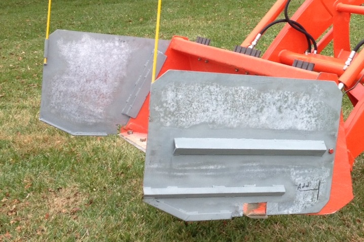

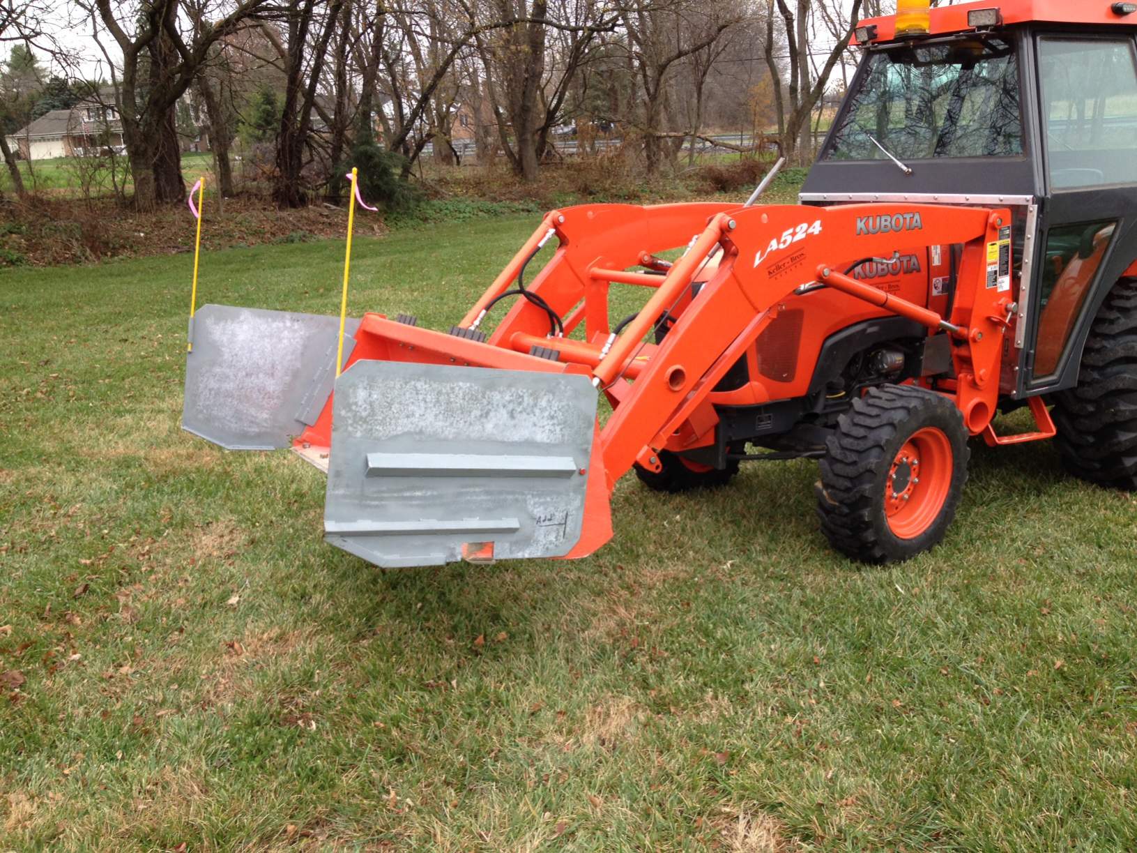

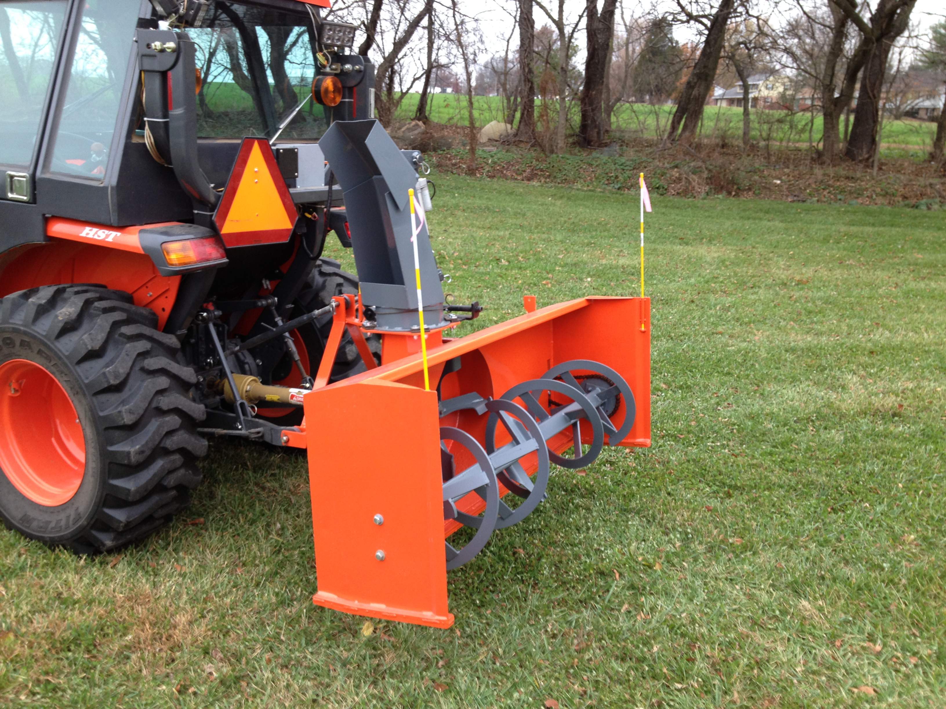

I added extensions to my bucket. This will be the third winter with them and the blower. The wings are made to slip onto the bucket so each one fastens with only one bolt. They are very easily installed or removed.On the other end of the tractor, there's a 64" Pronovost I refurbed (and added electric chute controls). Last week the RFM went into storage and the blower came out. These are pics from when I first completed the work. After actual use, it became apparent those little flags weren't necessary.
