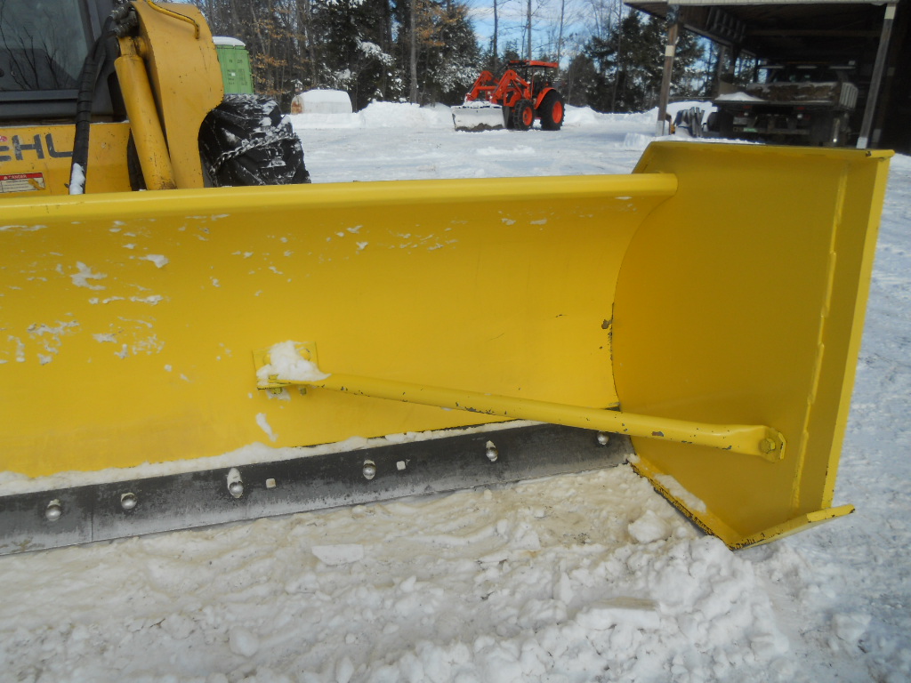

I only built the "wings", and was at an advantage as the plow was built for add on wings (the mounting provisions were there). I had never used a pusher before and was amazed how effective they are plowing an open area.

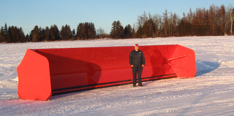

I Like this one but it won't fit in my barn. :)
RUSTY, that is crazy kool... i like that...!!!! Seeing yours, now i know i can finally do somethin with one of my old 54in JD blades...!

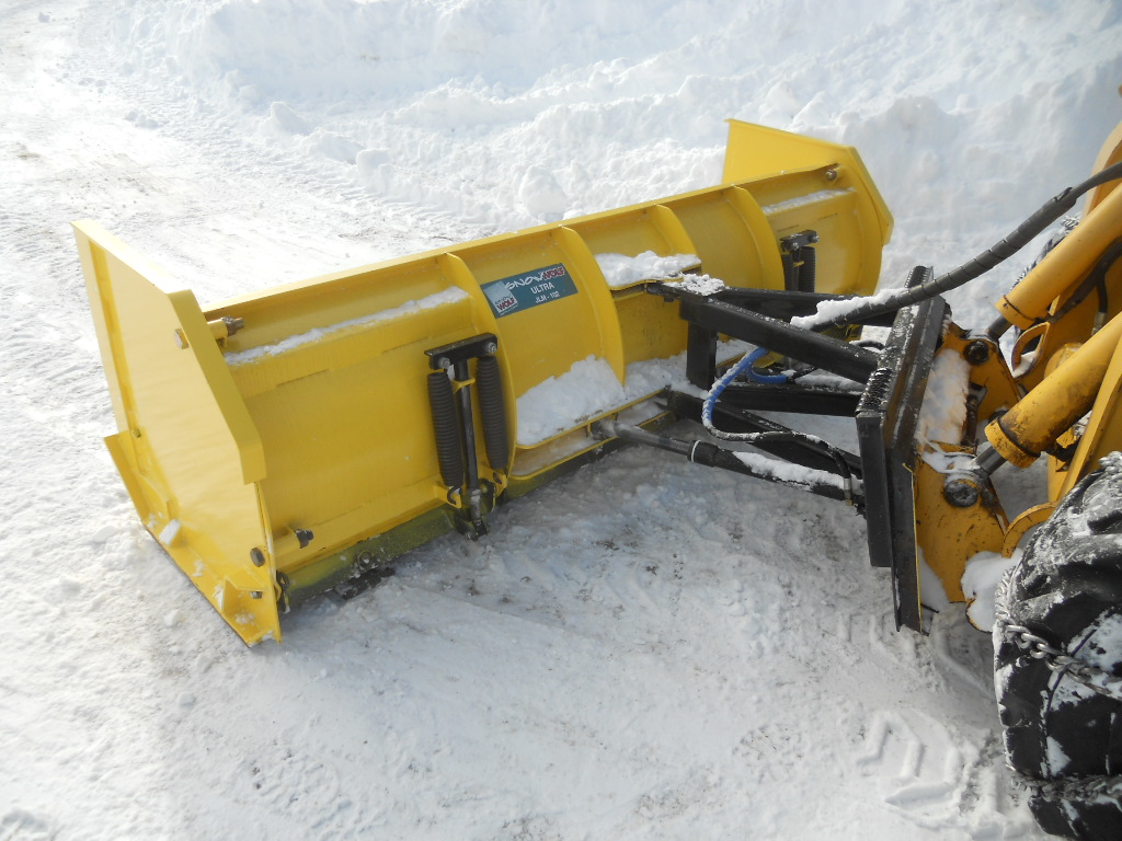

I have not used a normal rigid pusher and this one being able to angle is nice especially "sweeping" into a pile.

THATS exactly what i`m talkin about...!!! A snow pusher that can angle, AND sweep, is a snow pusher that WORKS....!

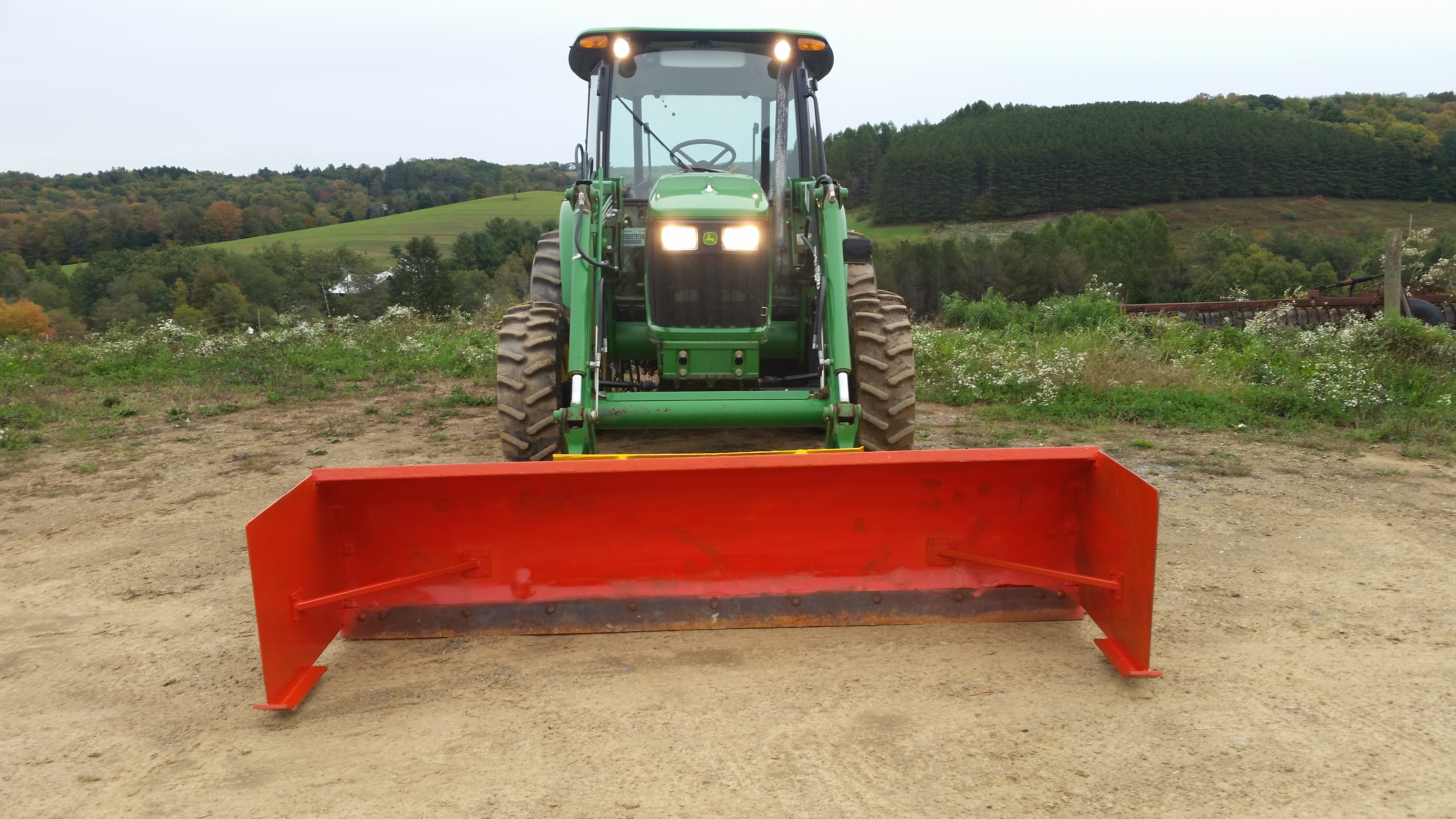

I cheated and started with a 10' plow.
It works pretty well but I need to modify it to float and follow the ground a little bit. It is a ridgid mount currently and I pick up quick a bit of dirt and grass with it. I have only used it up to about 8" so far with no issues. 20151002_155520.jpg20151002_155513.jpg

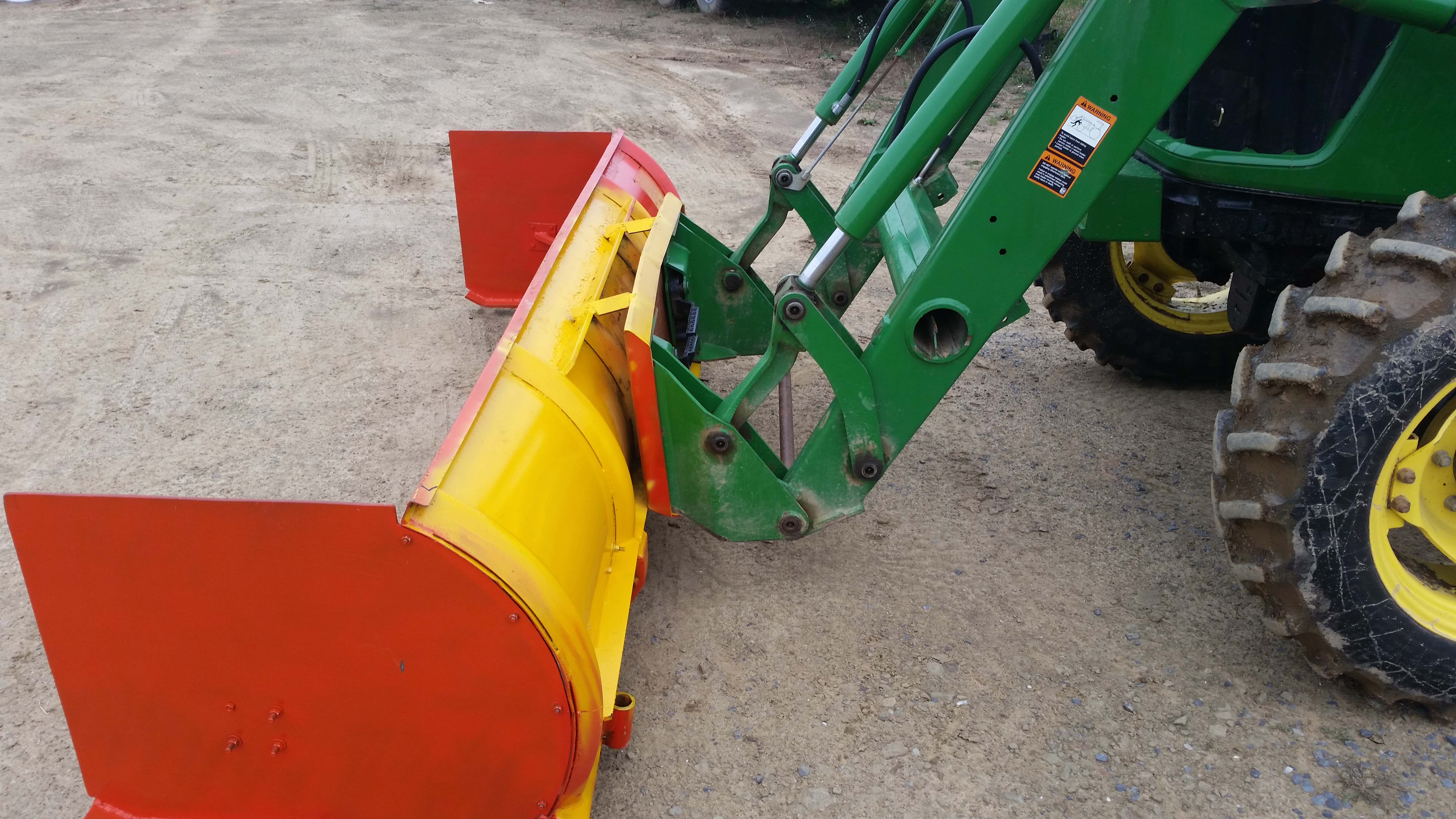

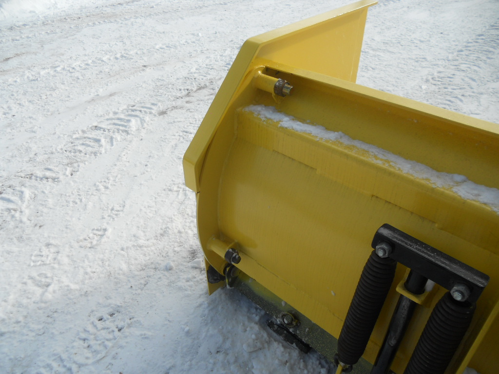

PaPow these pics show the (std. factory) mounting points. They sell the end plates as an option but I did not see the use of them until years later. I very much underestimated how much snow they can carry. These are obviously removable but I like it so much for certain areas like my pretty big firewood area along with all around the shop building that I keep them on and built another angle plow for the driveway plowing. This particular blade is a "trip edge" type and the tripping action is fully functional with the end plates, although I don't remember ever tripping it. It may be the skid shoe's on the end plates.
Rusty, that is a really sweet pusher. So are those side plates original to/for the plow or did you build those... i like how they`re made. I think if that were my rig, i think i would add a top plate back scraper cutter to the front leading edge so that you could flip it forward and get up close to back drag with it in close quarter areas.
/ Snow Pusher`s #12
I built them, "Pusher box's" were a new thing when I bought the plow and I could not imagine that they (pusher box) would carry anywhere near the snow that they are capable of. After some years went by and watching them work I just built them. As for back dragging with a bar across the top, being a traditional (angling) plow it is about 6-7' tall vertically with the wings and my hose's would have to be much longer and be troublesome keeping them out of the way while ''flat'' plowing. I have another plow or tractor/ss buckets for clean up. If it were "tight in" non angling pusher I'd definitely want that backdrag bar :thumbsup:
Obviously, you need a bigger barn. ;)
