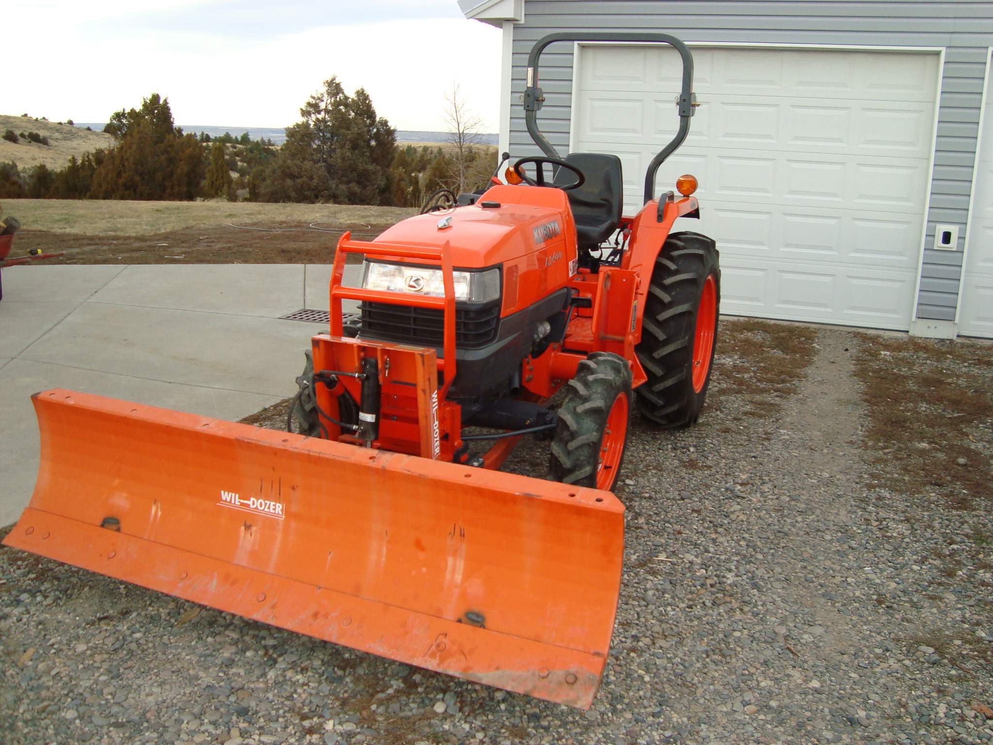

I have a 7' hydraulic angle blade on the front of my L3400 for pushing snow and it works just fine. I can't help but think that an 8' blade on your M7040 would be a good match. The 7' blade is a bit wide for the L3400 but when the blade is angled as far as it will go the rear tires are still in the cleared out snow path. Maybe a plow a bit wider might be a better choice? Hopefully someone here with a tractor close to yours can give you better advice?

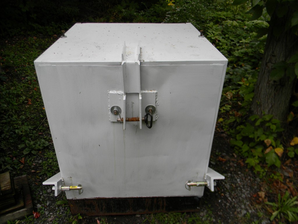

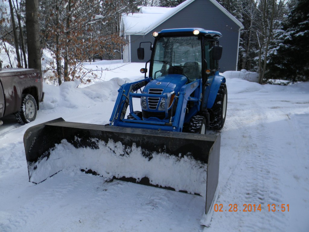

Your M7040 should have no problem with an 8' pusher. I have a 7'6" pusher for my tractor that I use on a gravel driveway. The only problem I have found is when that pusher blade fills up with snow you will lose traction and spin the tires. You need as much weight and traction as possible. I have loaded my rear tires, chains on all 4, plus either an 850 lb. or a 1200 lb. rear ballast if needed.

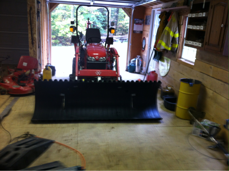

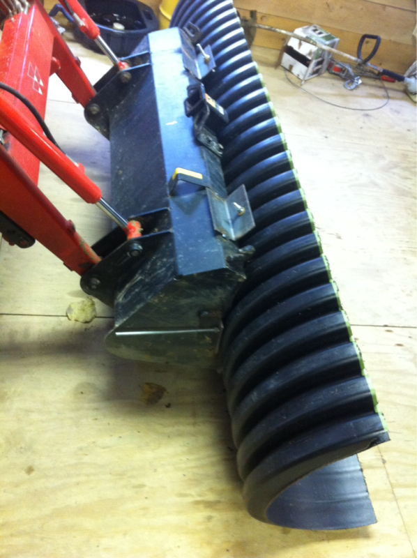

My cheap version , it works well 7.5'

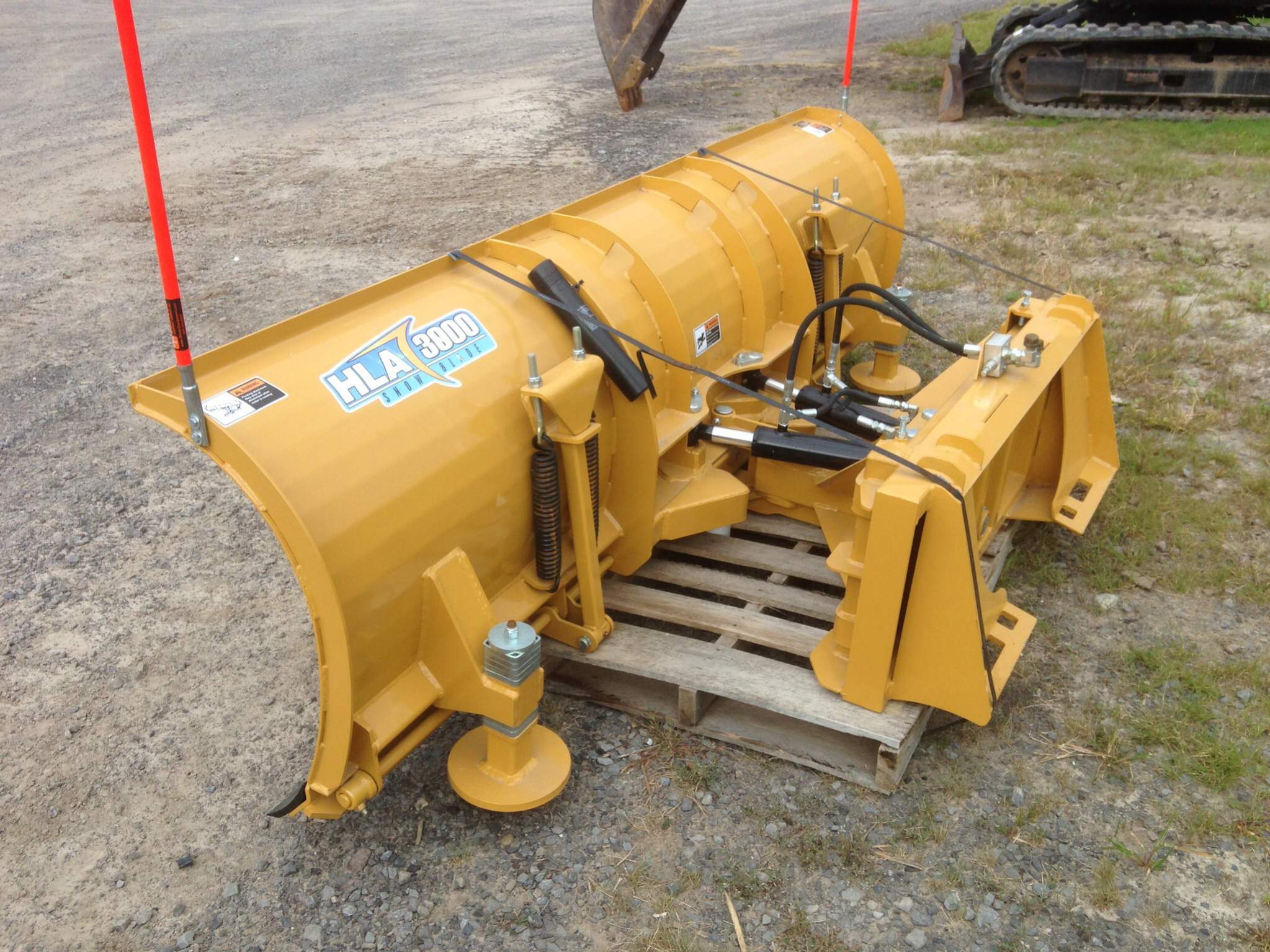

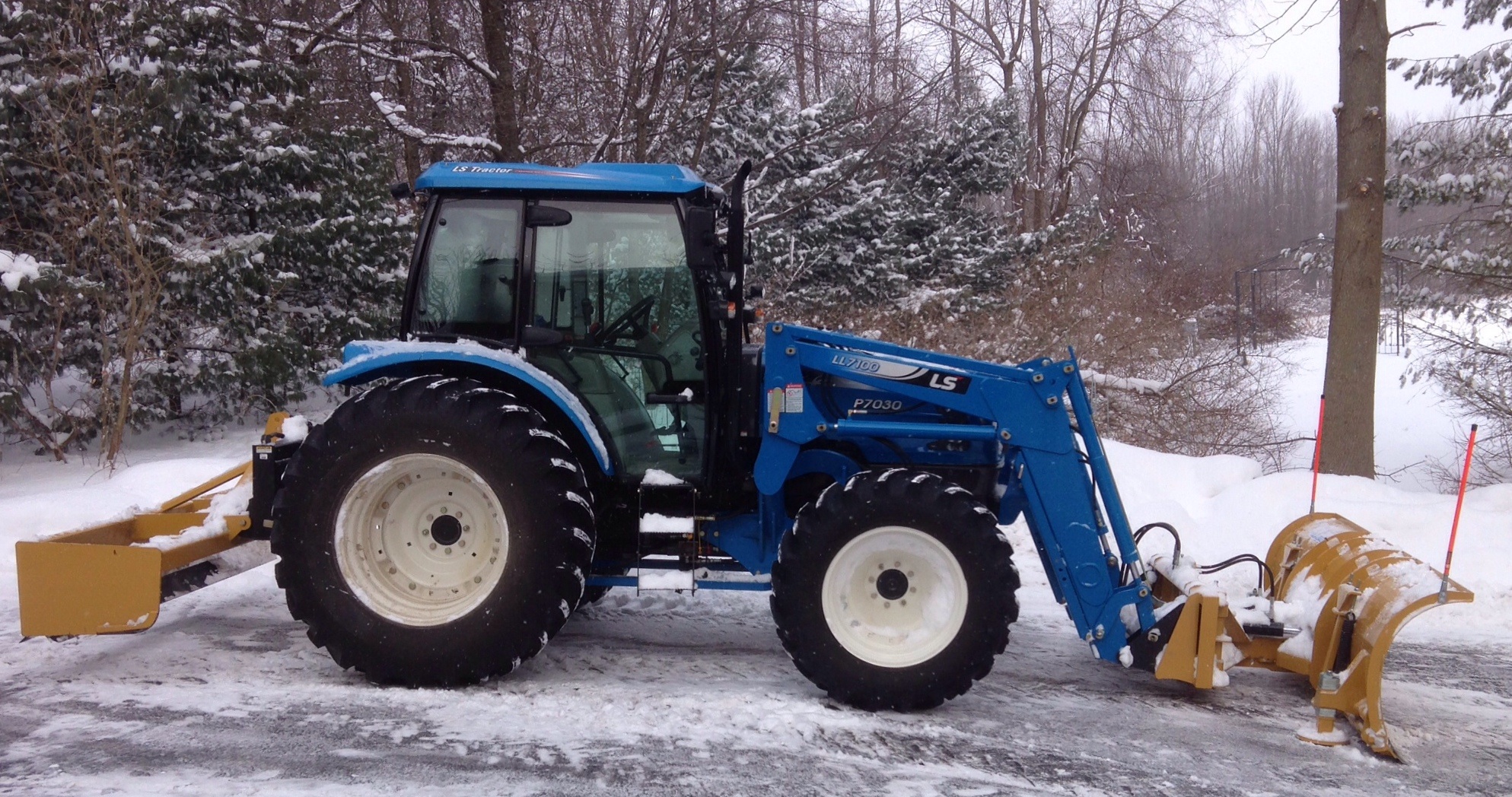

I have a 9' HLA blade, which covers my 90" track when fully angled. (If you go with a plow, a good rule of thumb is 18" wider than your width.) I plow a 1/4 mile driveway so a snow pusher is not what I would own, pushers are best for parking lots where you need to move snow greater distances. Plus you can't move back piles like you can with a blade.
Maintaining traction is easier with a plow versus a pusher because the snow weight is more constant with a plow. Weight is continually building with a pusher and you will need chains on your tires if you elect to go that route.
I run R1 tires no chains or loaded tires with my box blade on the rear. Box blade works great to pull snow away from garage doors etc and adds ballast. In essence, it's an 8' "pusher" that I'm pulling, it's the best of both worlds. (There's a reason you see so many pushers for sale! :))

Neat idea, Taddao,, what size is that that pipe, looks like 12 inches.

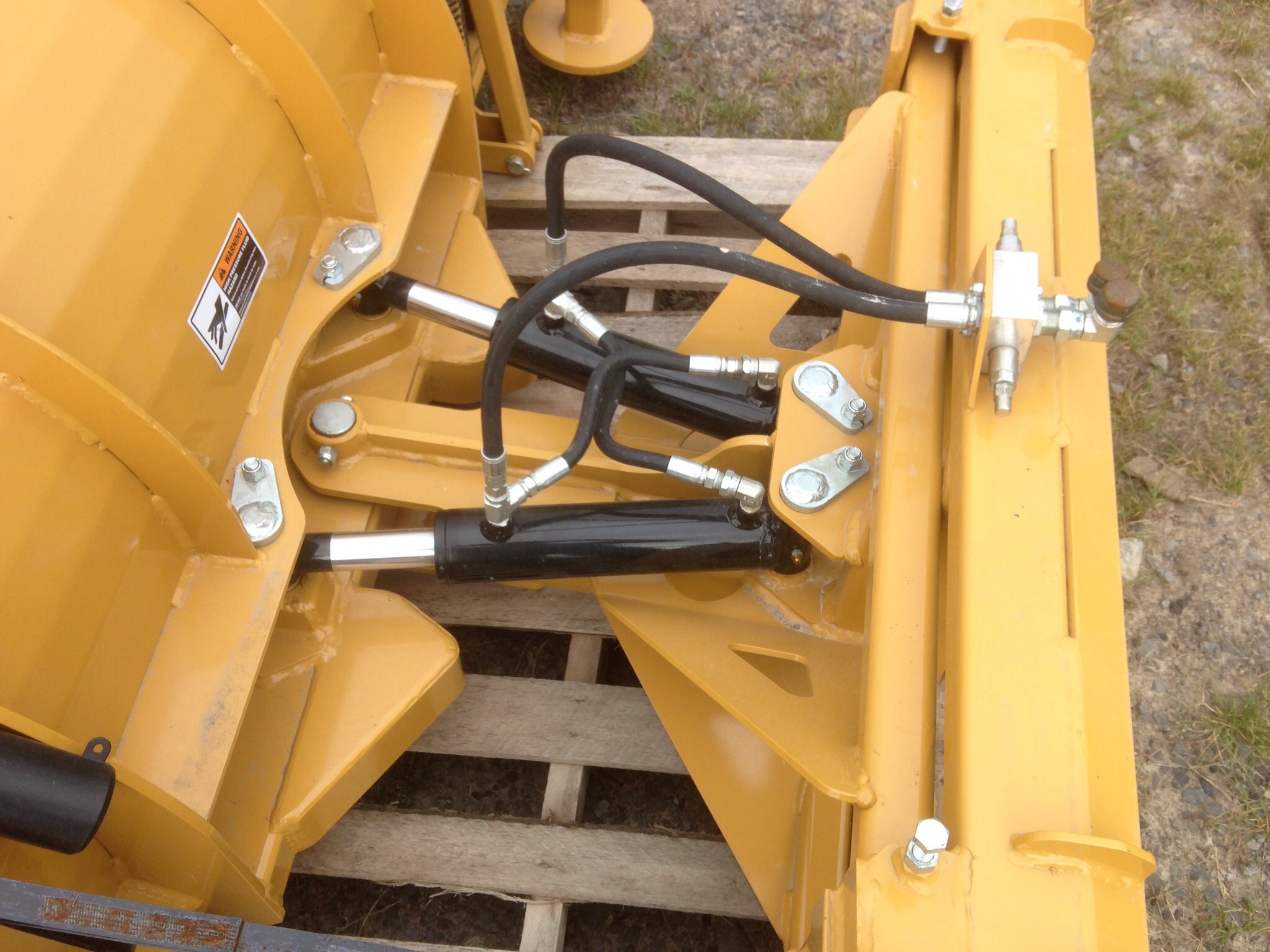

I run an 8 foot v-plow on an MX5100, but it does have a trip-edge and 5 degrees float in both axis. Does the snow pusher have any type of trip or release mechanism? Sure helps when you hit a rock on the outer end of your blade.

I have a 8' snow plow and a 7ft.rear blade on my L4240 HStC and both work well.A snow pusher would be of little use to me,I do 2 miles of woods roads and drives.As stated the only place we see pushers is in large parking lots on huge equipment.
Snow pusher does not have à trip device. But the blade height is adjustable. I have mine set about 1/2" higher than the side skid plates.
