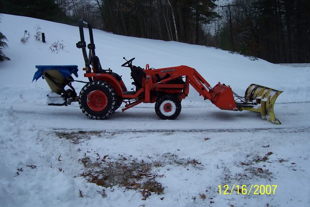

I love this tractor.
/ Snow plow/pics #2
That is one nice setup...you must have sold the truck by now :)
Heads up.... you should reset your mid mount mower deck arm, to the highest position on the nob. They're hanging to low.
Thanks for sharing.
Bird
/ Snow plow/pics #3
Is that a 6.5' plow? At what point does that wide blade hang the tractor up? (4-6" of dry snow, wet snow etc)

It's a 7.5', the tractor has not hung up yet, thurs it plowed 13" of dry snow in high range, then today 8- 10" of snow, sleet mix. Last winter it moved 6-8" of heavy wet snow with no problem, however, I had to put in low range to push the piles back. All in all it works very well.

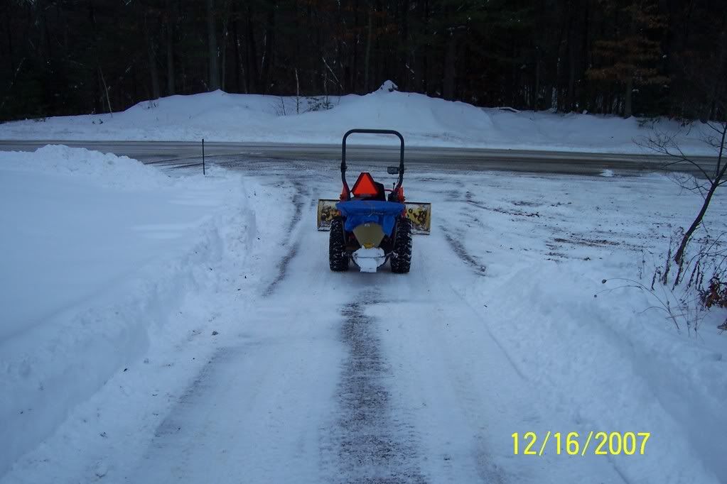

Thanks and happy new year to you too! I used an older frame mount for a chevy p/u, however I modded it to fit the angle section of the bucket on my B7610, it was a little bit of steel and welding + 4, 1/2" bolts to hold it in, that way I can just unbolt the frame hookup for the summer. The plow disconnects from the bucket in about 30 seconds (literally), pull the chain off and slide the two pins, you can see all of in the pictures I already posted, however I will take more detailed pics and repost them so you can see it up close. Just be advised the plow I use is 7.5' off a truck and it is heavy, I have to have the spreader atleast 1/2 full to counter weight it. I welded some angle iron on the top of the bucket, look closely at the pics, it does not stress it at all.
overall it does an excellent job, my neighbor has a M/F with a large blower on it, he can't beleive how this little B7610 push's snow the way it does.
This is the top of my driveway,

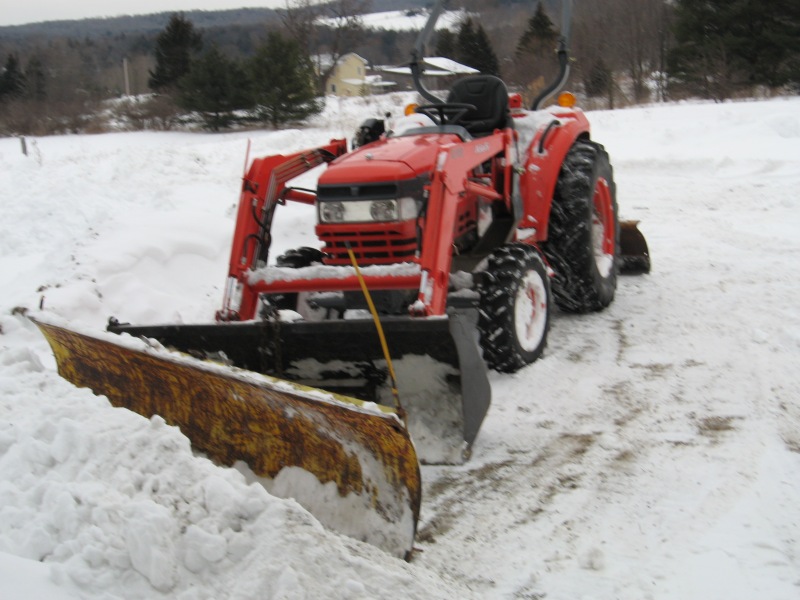

i will be building the same setup soon. i have looked at all the setups on here and chose to keep the loader on for now and then make a QA next year. i have a DK-35 and was going to use a 7 foot fisher, you have a 7.5 is there a difference in height or just length and weight??. more pics would be nice too. thanks

I drilled 4, 1/2" holes in the angled section of the bucket to secure the frame assembly. I will definetly post some more pics for you so you can mock up your set up. I have a 7.5' plow so your 7' should not be a problem at all. There are no hydraulics hooked up on the plow, I put some angle iron on the a-frame to hold the blade straight. I will pull the frame mount out to take more detailed pics, just be patient, more snow coming in sunday so it will be after that.

There is a small difference in weight and width, the length that it sticks out of the bucket will be the same. I chose to keep the bucket also and am glad I did, I can push and stack snow banks 6-8' high with no problems, plus if I need the bucket all I have to do is slide 2 pins and pull the chain, (30 seconds tops).
