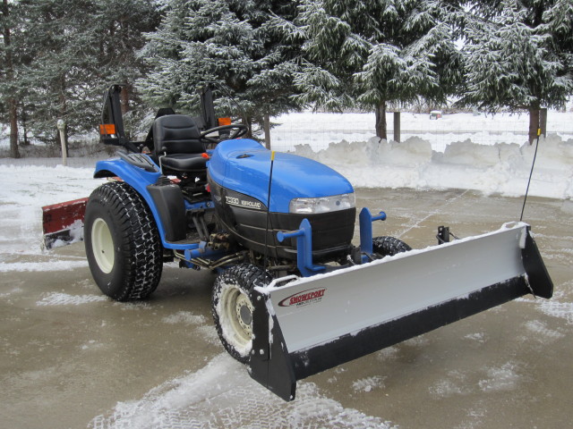

/ Snow plow or blower? #17
My latest snow tool is this SnowSport plow. It fits in a 2 inch receiver and is 100% manual. Once it is down in the plow position, all you do is drive forward and back....the plow does the rest. It has a 1 inch thick rubber scraper so it is great for grass areas. First I made a receiver for the TC33D, then I made one for the RTV900. It is crazy fast (RTV) and easy for me to plow the area between the house and shed. There are many videos showing how these plows work.
