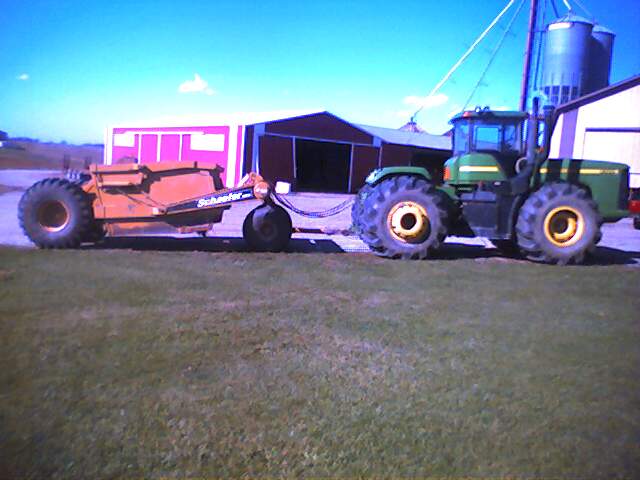

I imagine they're somewhere in OH now. A full day of 40 mph winds with gusts to 48 mph will do that. I was up north of Harlan helping with some ditch and dike work. THAT equipment wasn't likely to get blown around too much (see attached) but driving home had my Tahoe all over the road.

Must have been windy....blew ugly green stuff all over that tractor /forums/images/graemlins/mad.gif /forums/images/graemlins/grin.gif
Didya happen to find 9 cats and a dog in town?? /forums/images/graemlins/blush.gif
