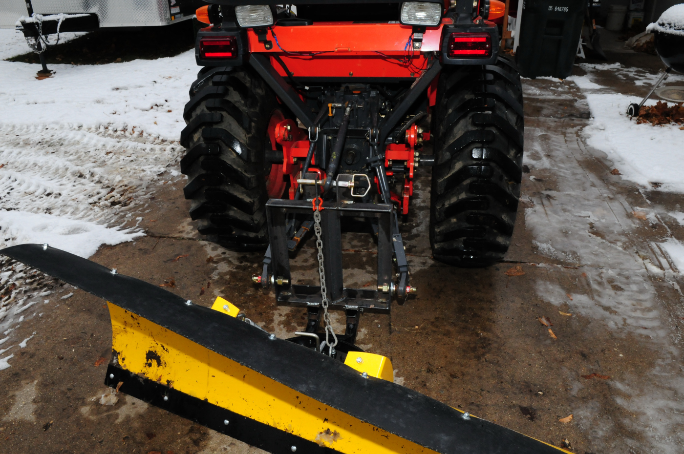

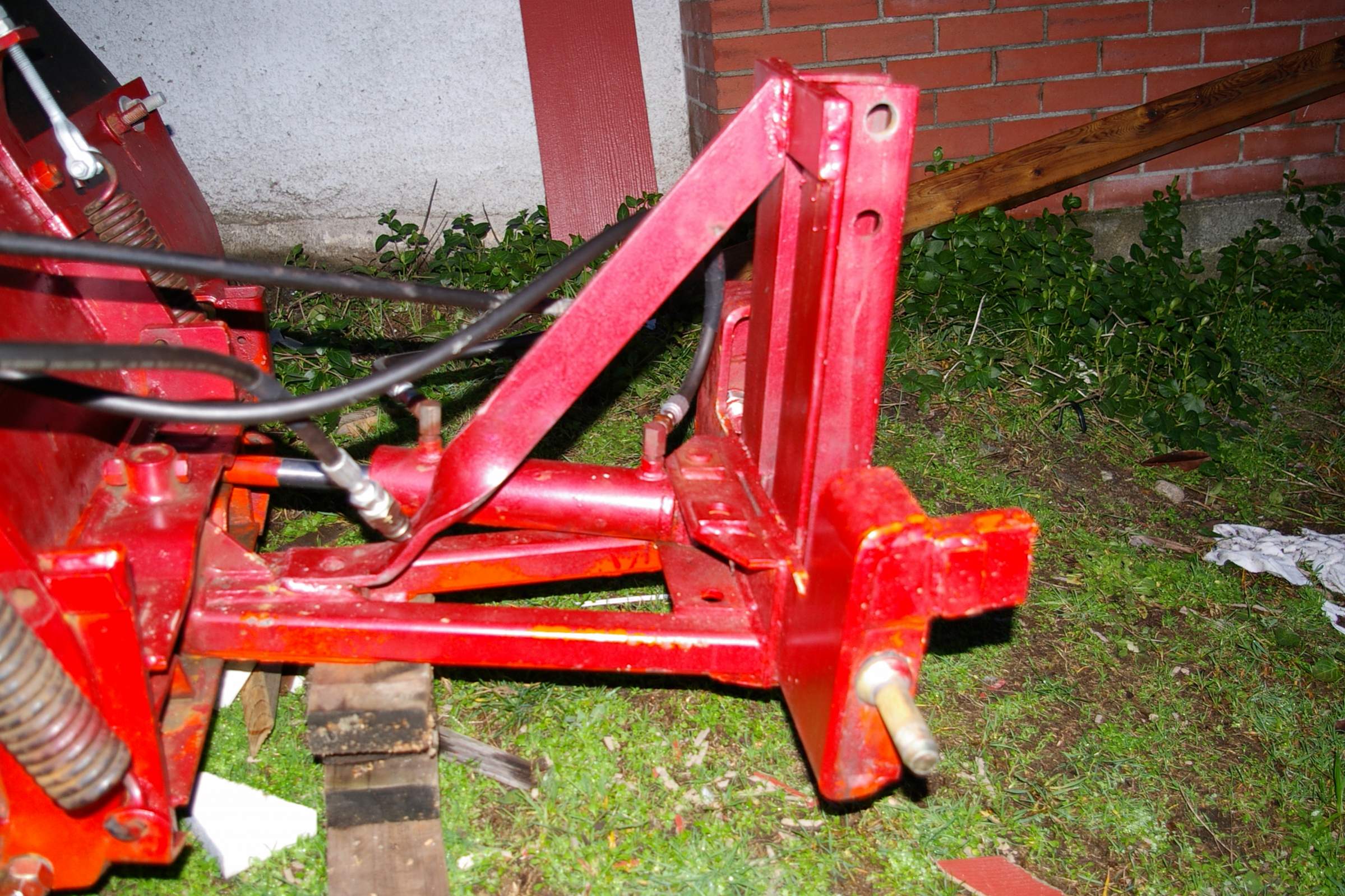

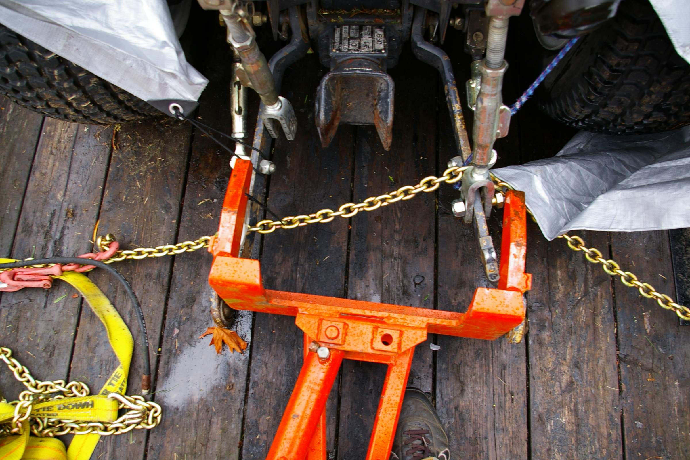

BTW I didn't built the adaptor frame tough enough. (2x2x1/4 angle). Made it through last winter. Still works. Built a new HD 2" box tube frame that I can use as pallet mover, trailer mover, and plow mount.

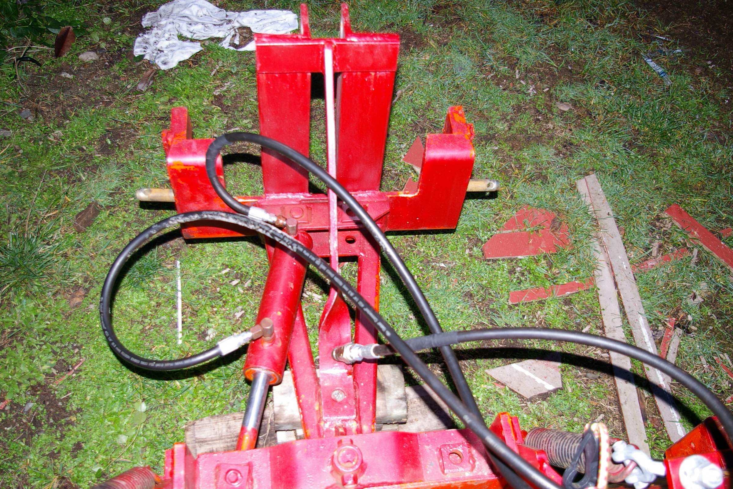

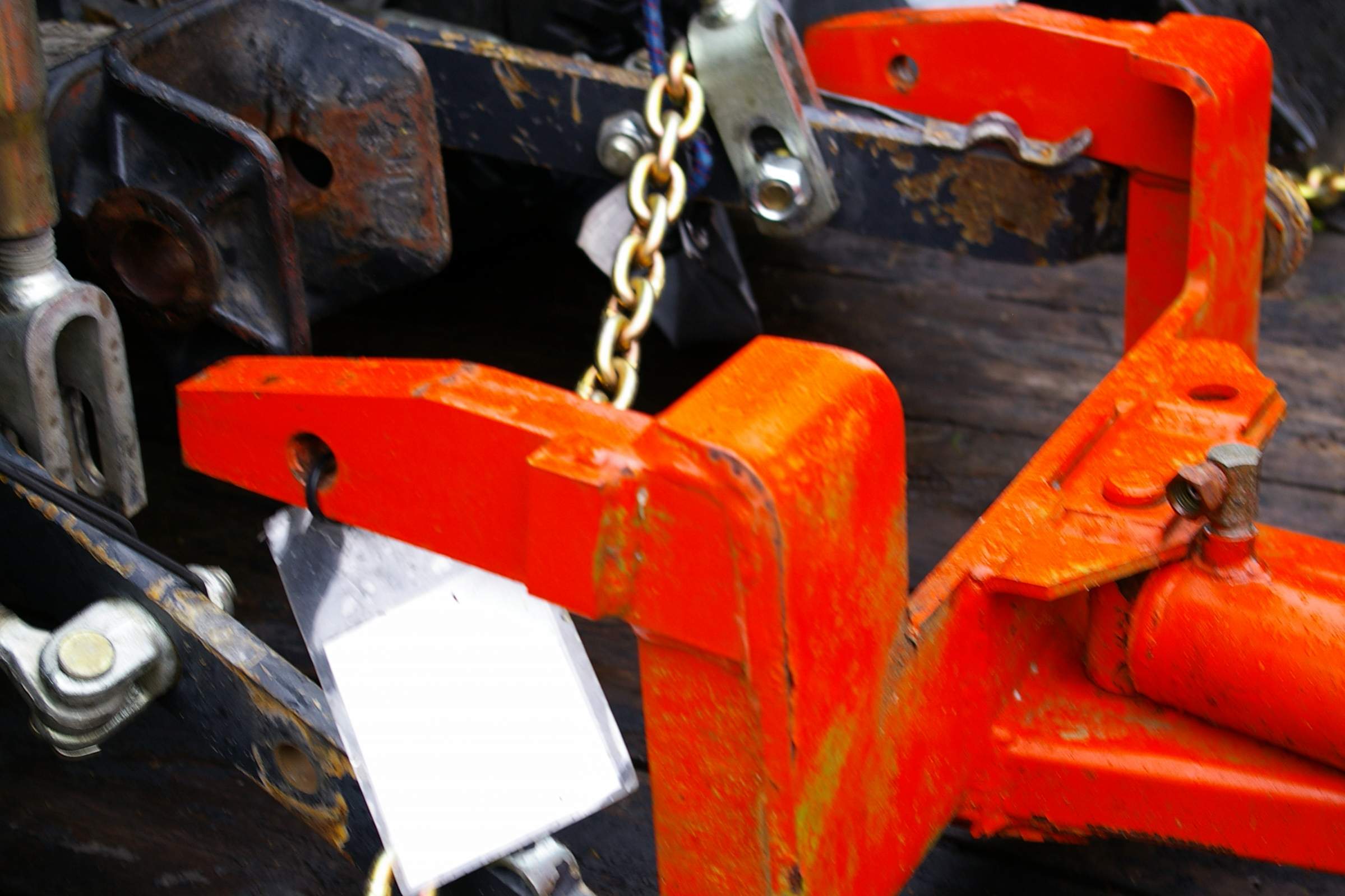

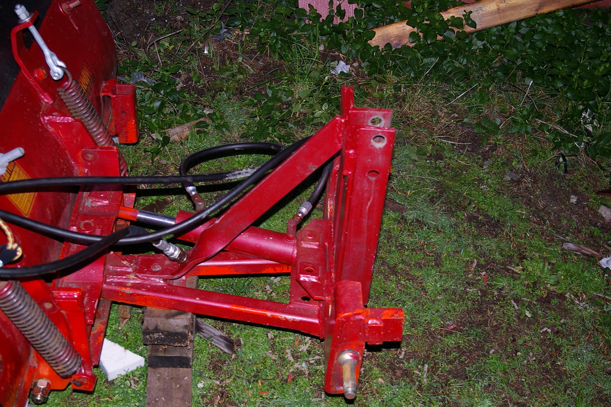

is that link that you put at the base of the 3pt swivel? looks very simple maybe I'm over thinking this. If I went with the 4Inch square pipe stait out the back of the plow I could conect directly into the hitch pin at the angle shown. the plow would be tilted a few degrees forward but the force of plowing would go directly to the frame. I could be wrong though:confused:

   / SNOW PLOW FOR MY 3PT
#13
here is a picture with the thought of the 4"

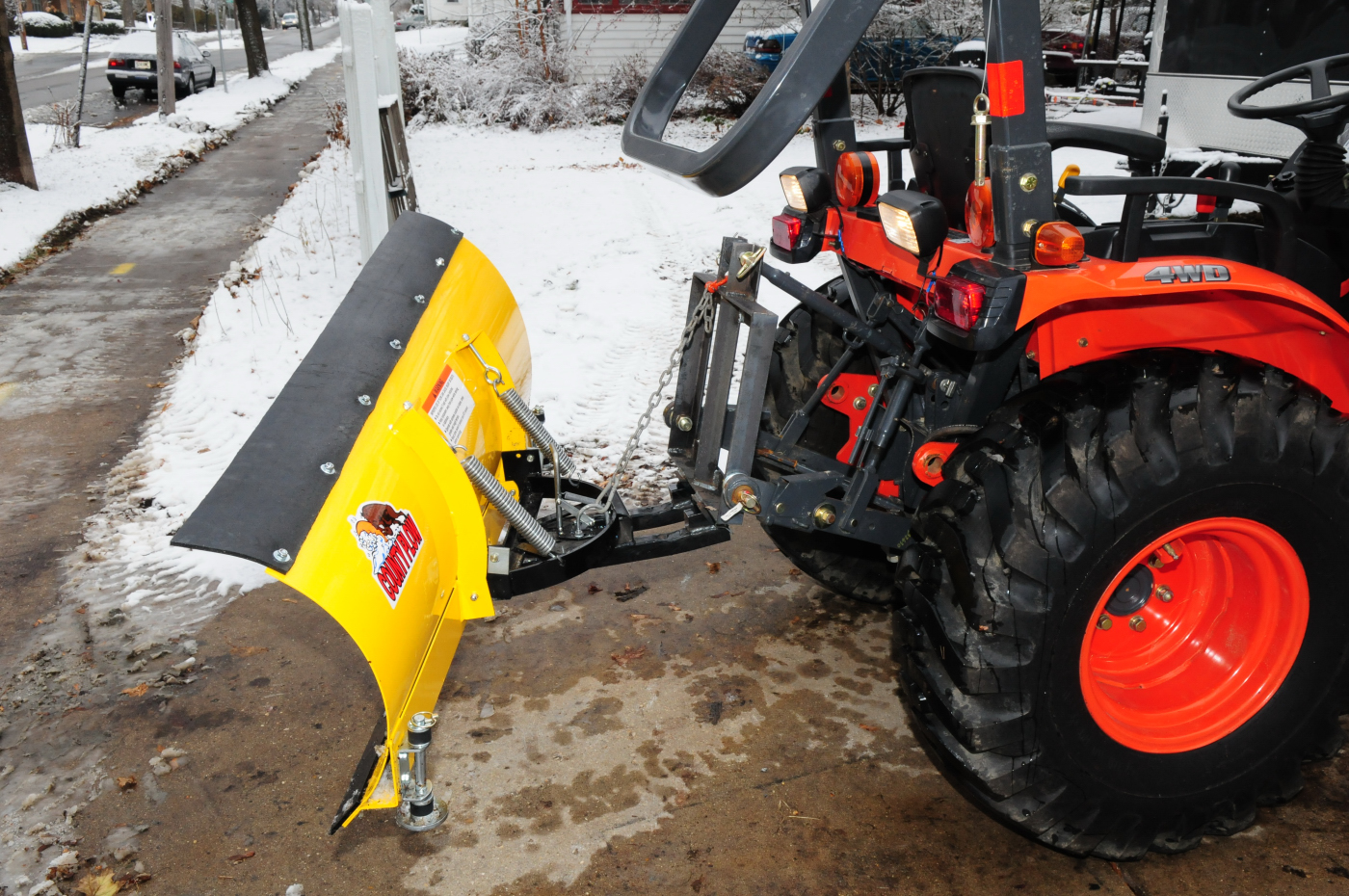

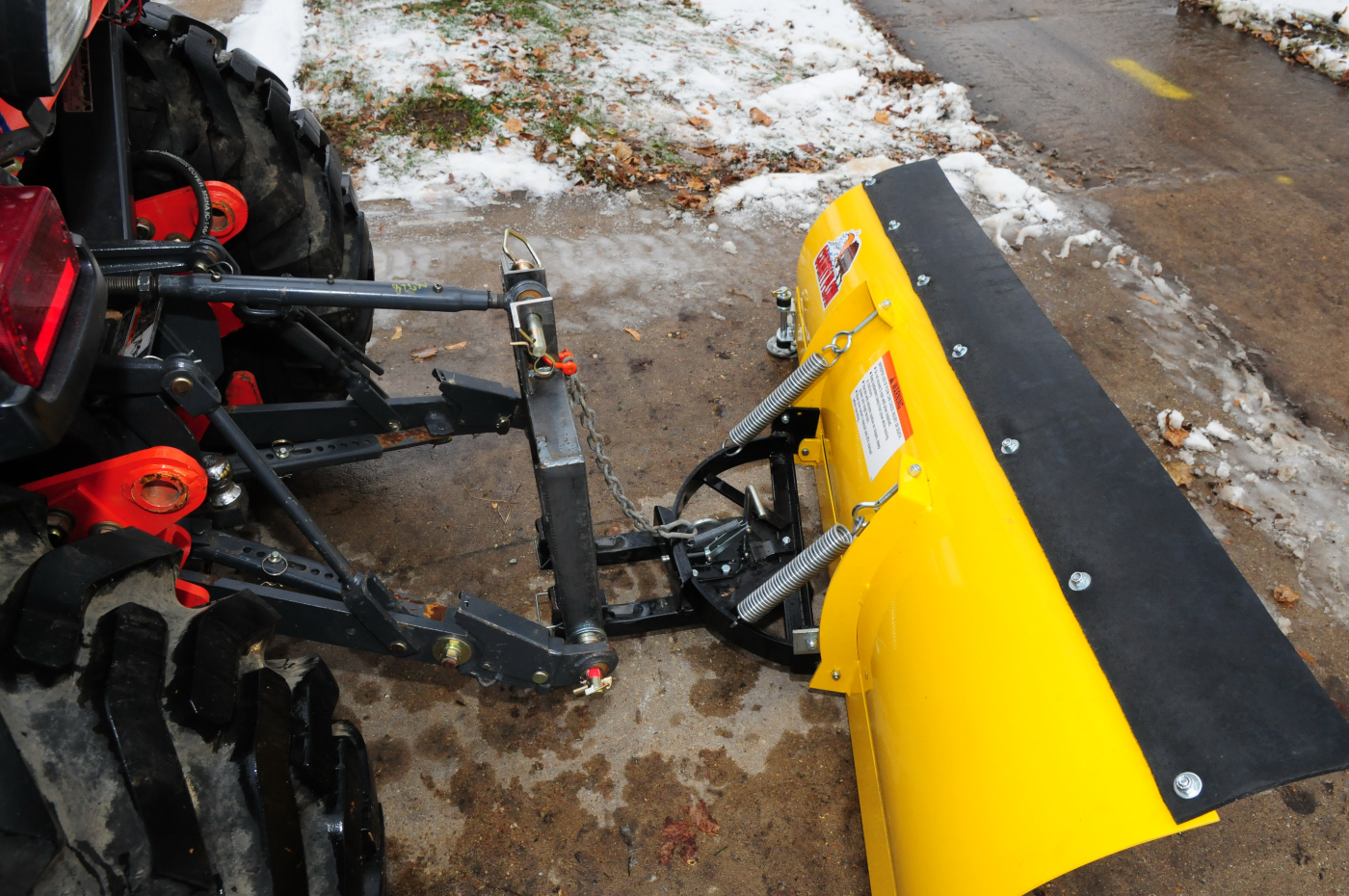

   / SNOW PLOW FOR MY 3PT #14
Here are a few more pics.
No swivles, but those built into the 3ph arms. There is enough play in the whole system to allow the blade to stay flat. I can adjust the cutting blade angle some by adjusting the 3ph height.
The black arms off the blade are the original mounting arms cut down. The arms pin to the angle iron 3ph frame (unpainted steel). The chain picks up the blade when the 3ph is raised.
I like the idea of connecting the frame has some promise. Would like connect to my tractor's frame, but don't have the time.
Last winter I pushed till a lost traction many times. No damage, but I did break the pins connecting the plow mount to my adaptor twice. Thats ok because I had designed them to be the weak point. A shear pin of sorts.
Hope this helps some.
#15
Thanks Bw Wis
I have had a freind over that slapped me up side the head for trying to rethink the wheel on this one.I have gone with his idea of two peices of heavy angle off of the frame in behind the ram. coming up about 12 inches two hold the top link and use the existing holes in the back mounts for the 3pt pins. this would be a standard 3pt hook up and easy on and off of the tractor . this way if a snow blower comes into the picture in the future the switch over would be simple.

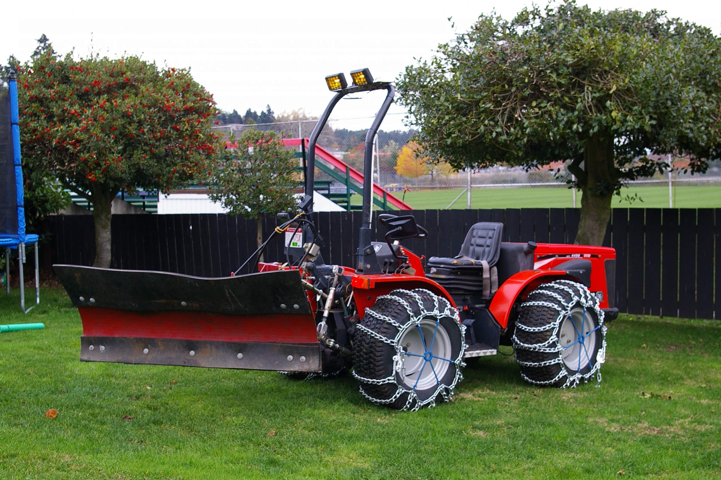

#19
just thought i would finnish this old thread with some pics of the finished product
