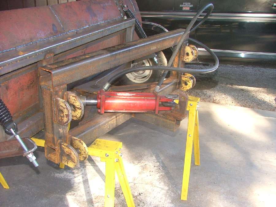

I mounted a TPH snow plow on my FEL. It doesn't have power angle. I was thinking about adding the swing cylinders. Has anyone done this and did you use a single double acting cyl. or two single acting. I am thinking one double acting would be easier to plumb. Also trying to decide how big of a cyl. maby 2.5"?

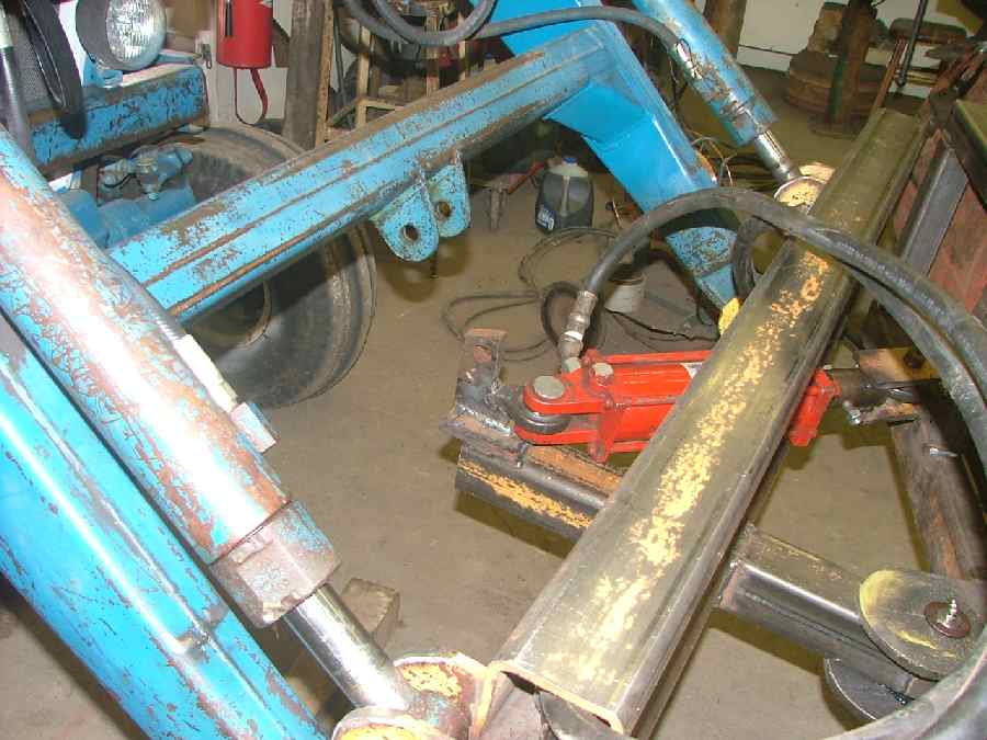

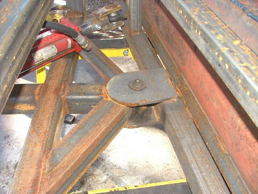

Hooked, here is a front blade that I made for my front loader and used a double acting cylinder for the angle feature.
Maybe this will give you some ideas. As you can see this blade is not an adaptation from another blade, it was built from materials that I had laying around. The blade was made from an old air tank.

Nice job and thanks for the pics. I decided to go with the single cyl. I am just figureing out where to mount it and get the proper angle so I get full swing in either direction.
