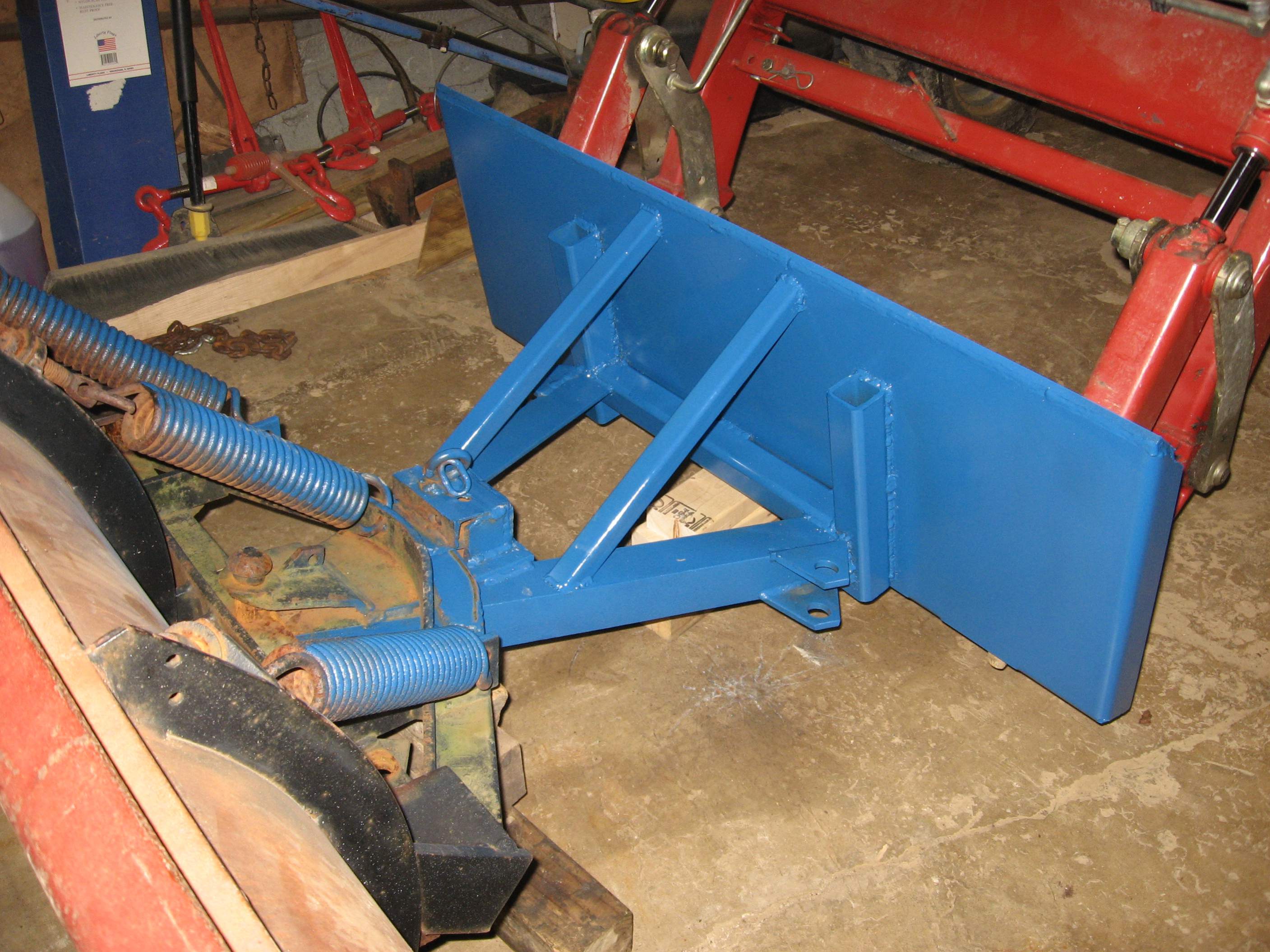

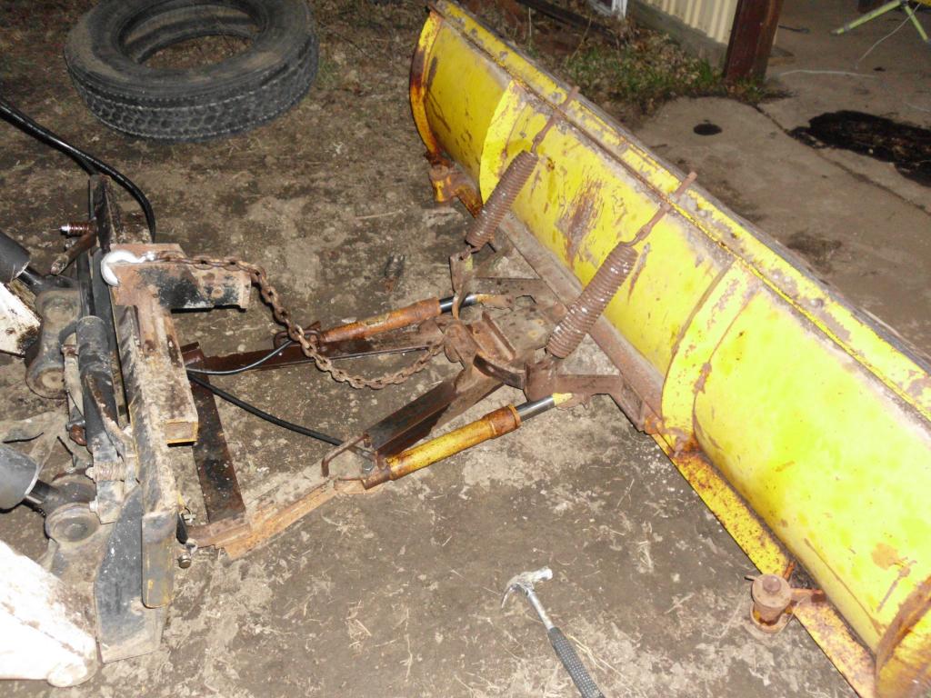

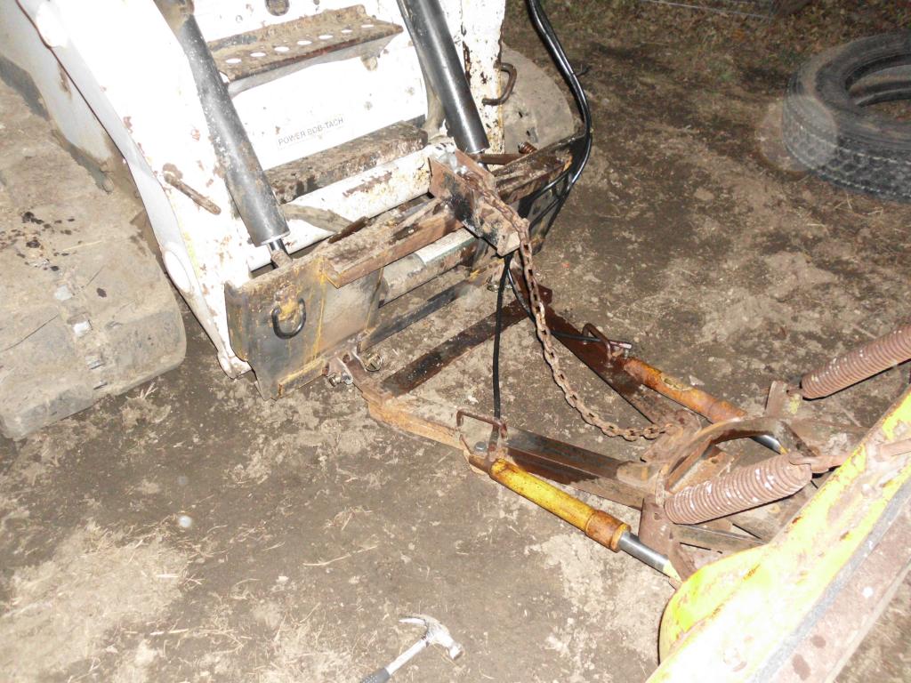

Funny how nature is a mother of an inventor. Over the summer, I saw a 7.5' Western blade and A-frame outside of my buddies shop. You all know how the conversation goes from here....
"What are you gonna do with that?"
"Nuttin. Won't fit on my current truck."
"What do you want for it?"
Thankfully, his wife was close by and yelled "Get it out of here. I'm sick of looking at it."
After explaining my idea, his only words were "I'll help you load it in the truck".
Few months later, I've finally got a few minutes to work on it. Skid steer plate ordered. Tractor has dual remotes. I've already pulled apart and cleaned up the cylinders. Let the fab work begin!!!! LOL Some grainy pictures will follow. The poor picture quality will be to disguise some craftsmanship issues.....not because of a cheap camera. LOL

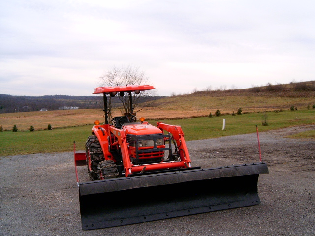

I adapted a 9' Western truck plow to QA for my tractor last year.
It works very well.

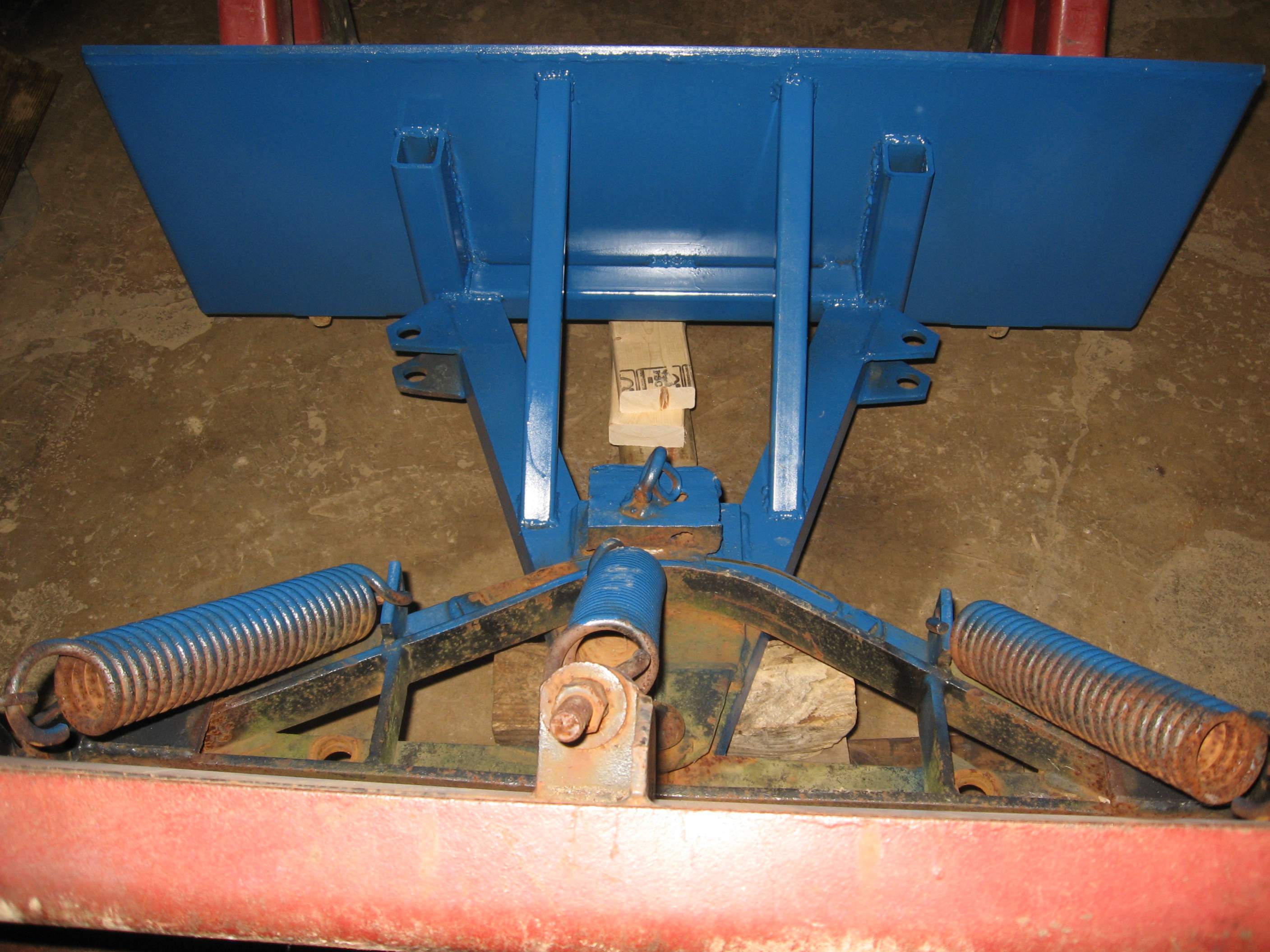

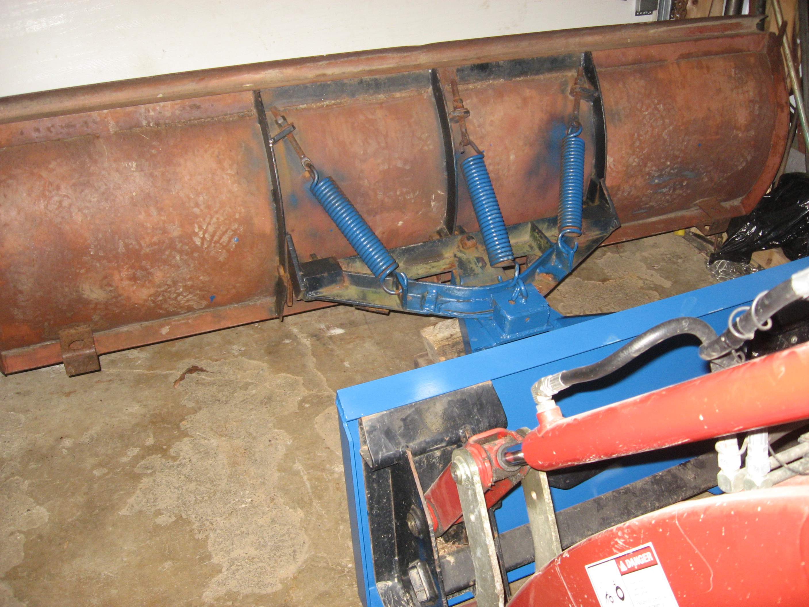

OK. Here's what I've got. Not my best fab work ever...but I think it'll get the job done. I'll have about $300 :licking:in it by the time the hoses are all done etc. Right now, it's a 7.5' blade....and my garage door is also 7.5'. Unless someone tells me that 33 hp of compact tractor will push that no problem and that I'd be an idiot for doing it....I think that the blade is going to lose 6' off of each side. It'll still be a hair wider than the tractor at full angle.....so that'll happen over the holiday.
The blue paint? It's what I had laying around. Been on the shelf for 9 years. Was time to use it. LOL Not my most proud piece of fab work....but sometimes form doesn't hold a candle to function. 006.jpg007.jpg008.jpg:laughing:

I'd think you could push that no problem at all. The best thing to do it try it, you can always cut some off later if it's a problem. Angle the blade a little to make it easier to get in and out of the garage.
