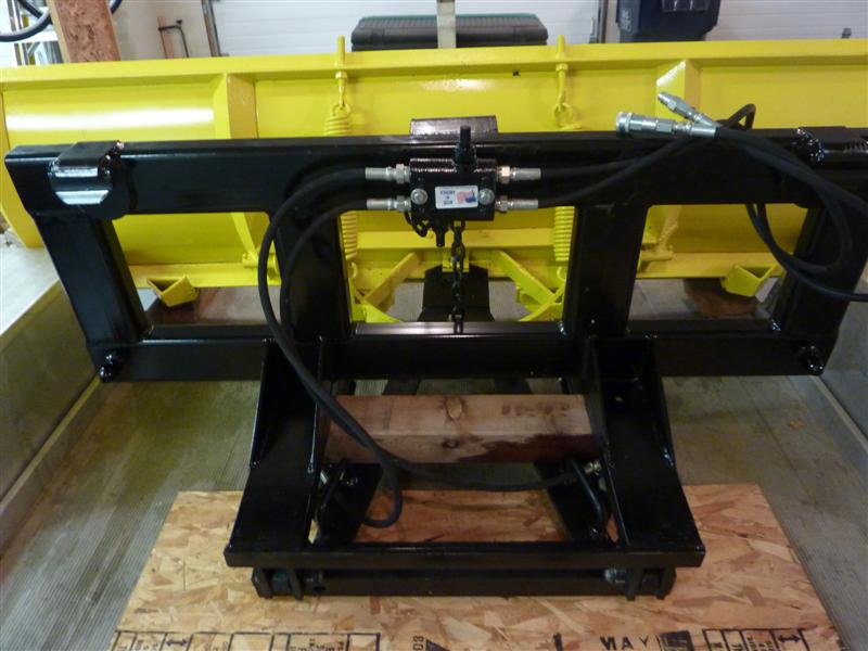

I recently did a plow build and bought new cylinders for mine. Not sure if this was mentioned previously (I didnt read the whole thread) but, many folks recommend a "CROSSOVER RELIEF VALVE" to be plumbed into your set up. This valve will divert oil from one side to the other if you hit something with the lead edge (corner) of the snow blade. I think its a good idea if you plow around lots of curbs and such. In my case I have tree roots and stumps along my trails.
This pic shows the valve and where I mounted mine. The surplus center has them for about $80 IIRC.

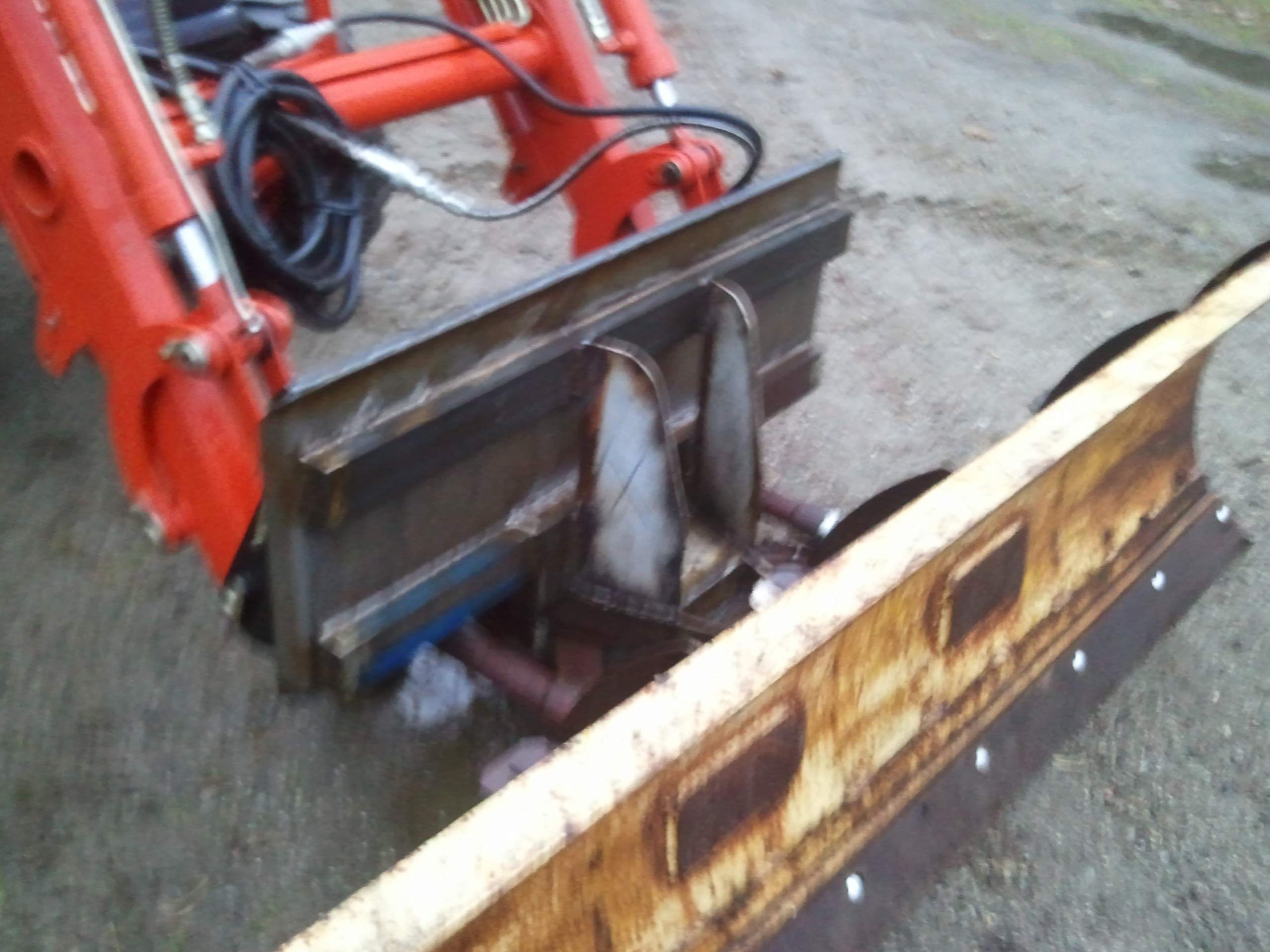

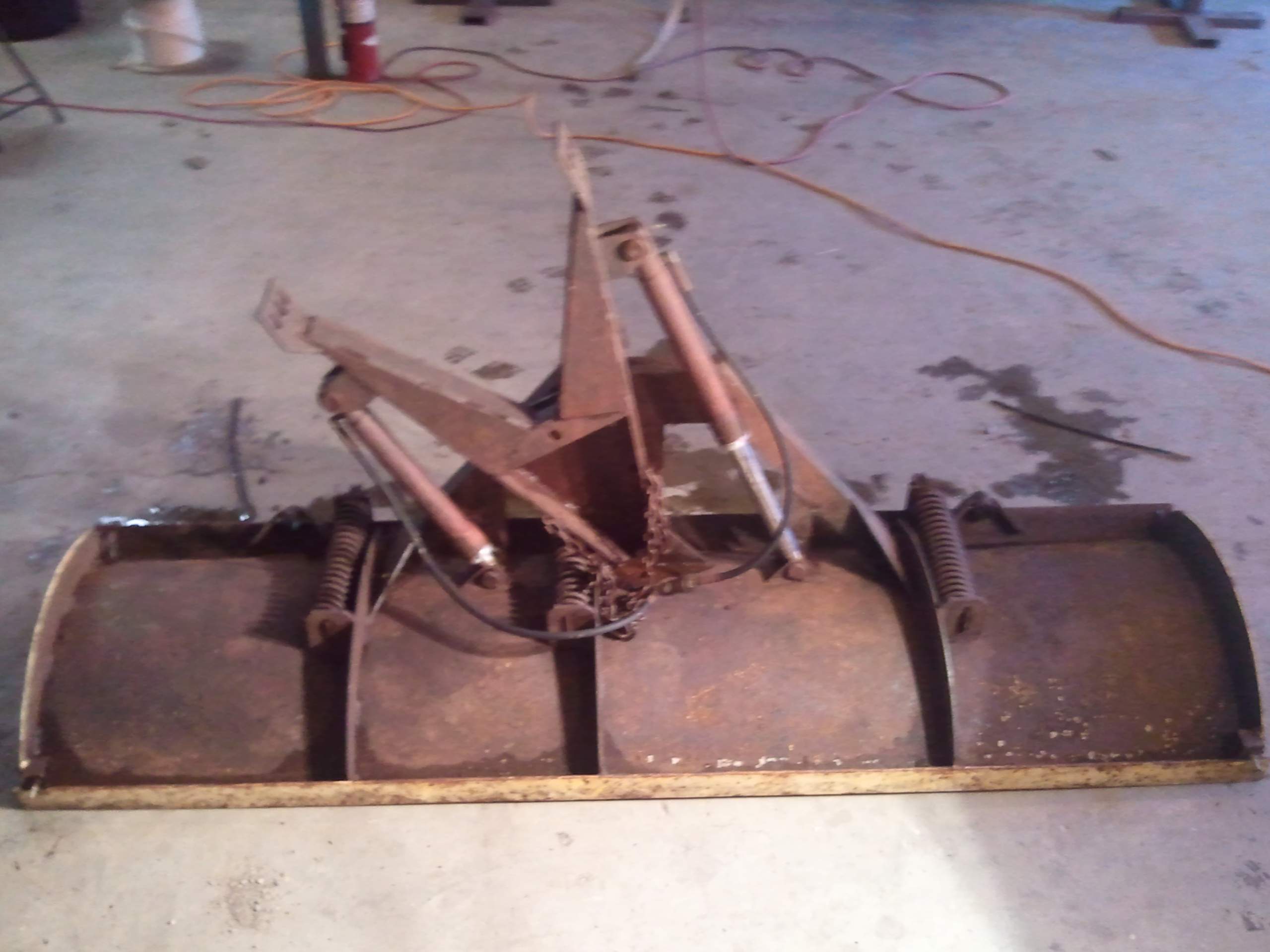

there is some awesome info in this tread. I built one out of an old 7' Fisher plow with info from this thread. Best question to ask, what would you do different.WP_000022.jpgWP_000064.jpg
Glad you got something out of the thread. That's just great.
Hum. Good question. The first thing I'd do is focus the picture :laughing:
Ah. Just kidding.You should attach a few more different angles but from what I can see you did a nice job. I like the fact that your blade is back close to your FEL :thumbsup:
