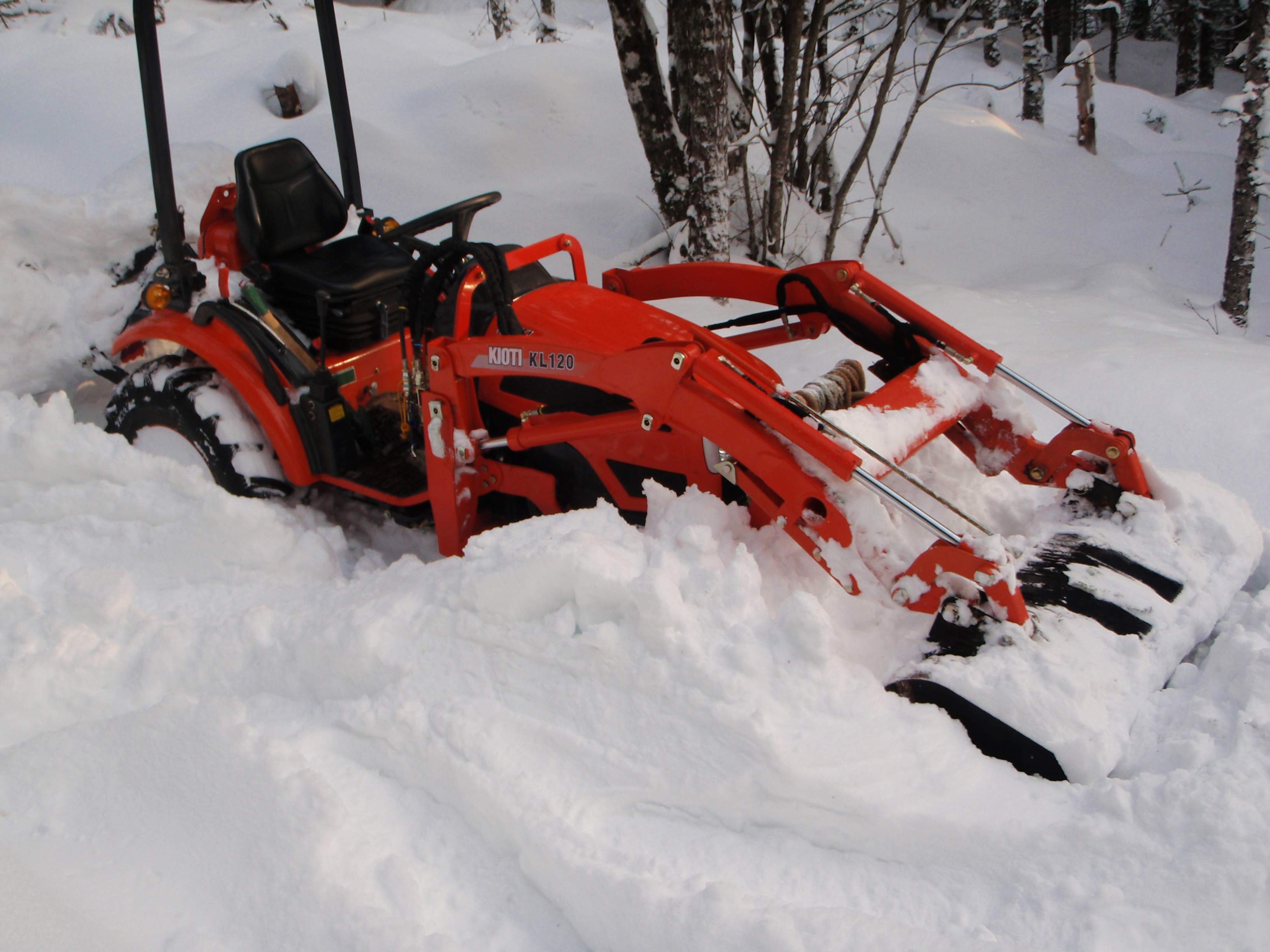

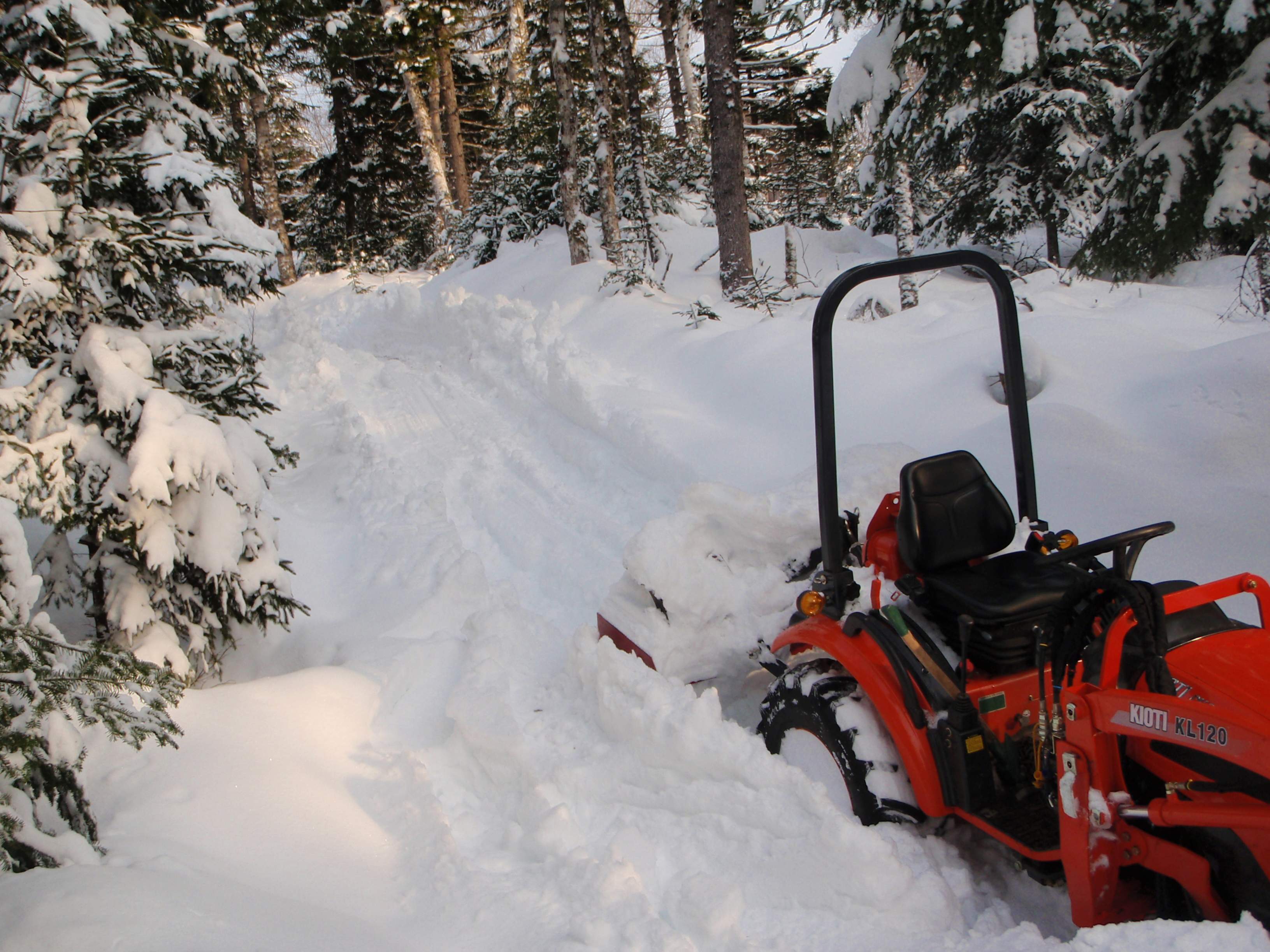

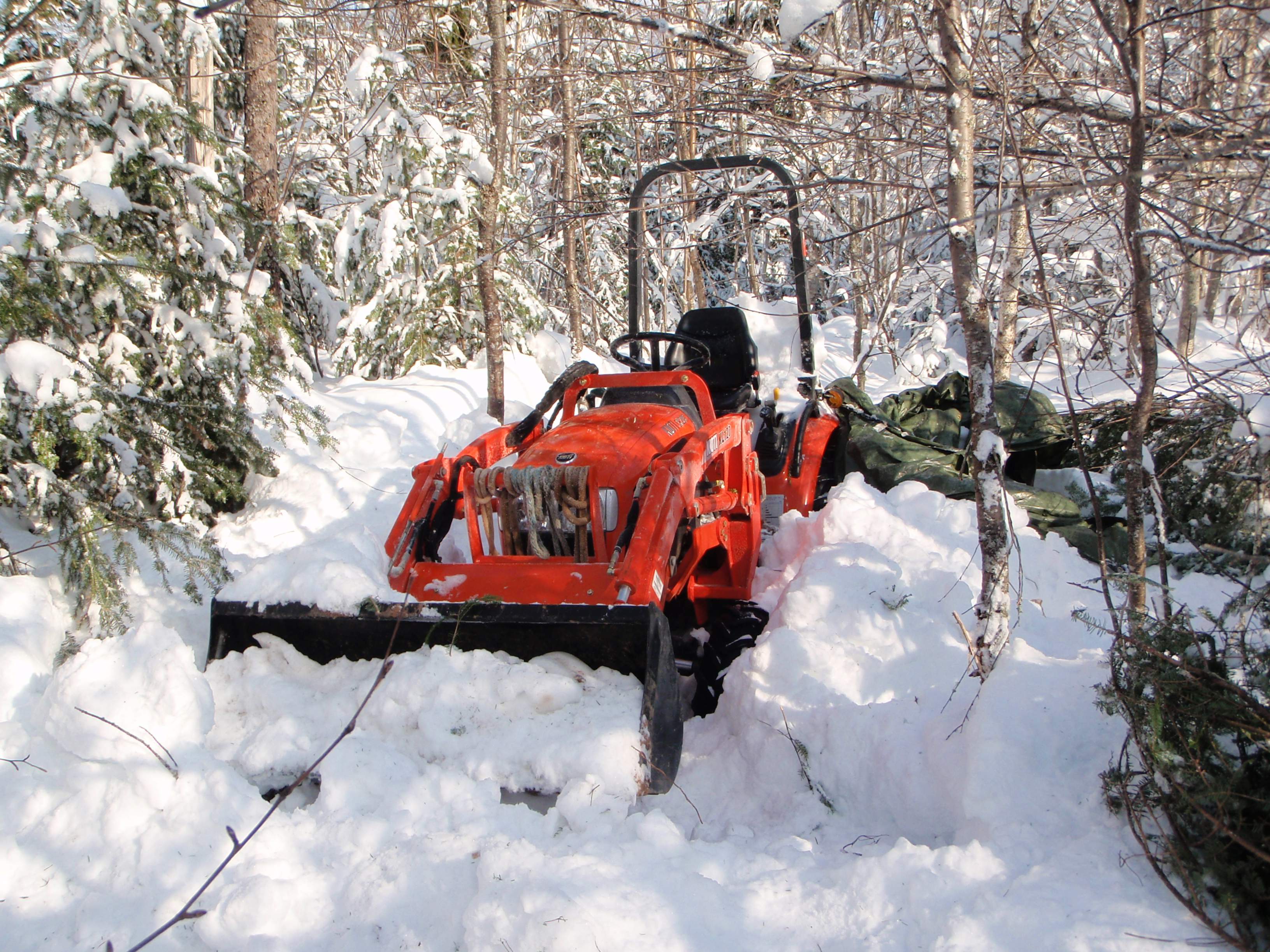

I was on the west coast (Victoria) for most of Jan. I was looking fwd to getting home, going to my property in tatamagouche, using the tractor to clear whatever snow there was then skiing or snowshoeing.
Well, I discovered that in 2 plus ft of snow my tractor will move and actually clear the snow but at such a slow rate that its almost not worth it. It took me an hour to get from my parking area to my road and then another hour to clear about 100 ' . Then I got big time stuck and went home. I'll go up on thurs and dig it out.
It will be nice when I have cleared a path on the road and a place to park my truck but it's going to be slow.
The pic with the bucket turned down is where it got stuck.

It will be slow going, but you have to clear the area you are driving on. If you go straight forward with that much snow, it will fall in from the sides and all of a sudden you are not driving on a cleared area... that's when you get stuck. What you may need to do is attack the snow in a "herringbone" pattern. Push and dump with your bucket at a slight angle to the side for maybe 6 feet, then back up and push and dump to the other side. Continue this action form side to side, taking about 1/2 the width of your bucket with each push. As you move forward you should leave a cleared area behind you that is at least twice as wide as your tractor. After you do this for a long distance, you can back up, and use your backblade (tilted at an angle) to clean up your path, and windrow the little bit of remaining snow to the side. It is slow, but will still go quicker than you think... and a great way to get quality "seat time".

With a 4WD machine, when the snow is deeper than the front wheels are tall, you need to push it with a flat Blade, driving backwards.
I find you can push the snow into piles and FEL move it at your lesure.

I have the box blade on the back and tried to push the snow backwards..it didn't seem to work as well as pushing it with the FEL. I'll try my rear blade on an angle this weekend.

While I understand your situation and this sounds like a getaway property, Big snows like that we push in manageable depths. We do not wait til it's done. Better to plow 3- 8" snow, than 1-24". I use loader only to move the piles after blading if needed. You can either invest in the snowblower and not worry anymore, or pay for it in time, frustration, and fuel when using tractor loader.

I'm up in NB, I've opened up a few camps for people after a winter. You can either use a snowblower, buy a v-plow for the front, or you need to use the loader and scoop and pile to one side inching diagonally.
A tractor can only drive in settled snow until about when it drags on the underside of the front axle then you are stuck. Just plowing straight with the loader lets snow spill back around, then when it builds up too high, you have a massive pile you need to scoop and move out of the way.
