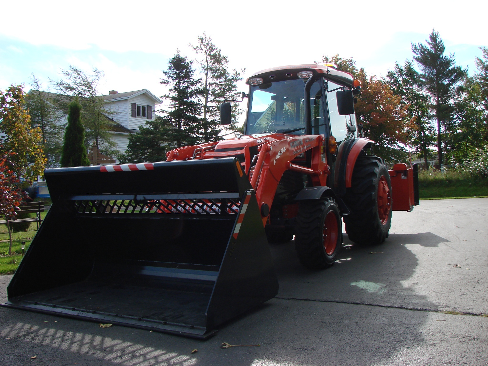

I have a kioti dk35se with 351 loader . Looking for a snow bucket 72-84 in. for a med. parking lot (car wash) Space is a issue .

Yes it has a quick attach bucket . I see snow buckets on ebay ect. I am looking for one that can push wet snow to piles and lift off to back of prop.

You don't want to be using a snow bucket on wet snow. These snow buckets are also called light material buckets and are twice the size of regular buckets and can put an aweful strain on a tractor plus if you use a snow bucket you better make sure you have a lot of rear weight on your machine.
I use a snow bucket but never on anything wet. Just on powder snow.

If you don't have to carry snow then buy a snow pusher or box. as far as overloading the tractor, well it is either going to do it or not. I have never had any problem with snow. Our first snow was 24" of heavy wet snow and my 8' pusher did great. CJ
