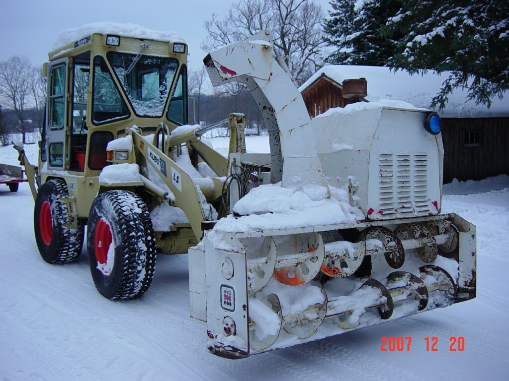

Well, I got the impeller measured and there is more clearance than I thought there would be - aint it always the same when you buy used, the deal isn't as good later after calming down and doing some checking.
I get between 1/2" and 3/4" cleance on each blade - depending on which side you measure. I think the front gets worn more as the snow/grit or what have you takes it's toll. I guess I will try welding on some 1/4 x 1x2 flat bar to close up the gap. I guess static balancing for the fan would better better than nothing.
Anyone have an idea of cost uf building up and balancing if sent out? What about the cost of replacing the fan - how expensive are these?
I once repaired a 10hp gas powered blower and the impeller was something like $40 to replace - I know there is no comparison, but the price still seemed cheap to me. The old one got bent like a pretzel after jamming with rocks/ice !. My dear dog loves to play with stones and drops them anywhere - and I gets to find them :eek::eek:
Anyway, just thought I would add a bit to the first post. Also the fan is 24" diameter, so it should throw quite a bit out if set up right.

Thanks for the link. I took a look but that looks to be for the small gas powered snow blower of 10hp or less.
Hmmm, maybe that idea could be used and modified to take advantage of some PTFE board say 1/2 thick and somebacking plates. Cheap to do and nothing gets damaged with the PTFE being so slippery.

Thought you might be interested - I have just got a reply back from Allied-Farm King (Buhler) who made my new (used) snow blower (I am guessing that it is an ex-rental and probably 15years old or more, but well built and in good shape). They couldn't find the specs for my particular machine, but said that the clearance between blade tip and housing should be as small as possible/practucal.
Hmmmm, that mean I got lotsa "hole" to fill up :D:D:D That I can do without a problem.
Further to the plastic idea, depending on the wear experienced, it might be worth considering replacement blade tips in metal. Make a drawing and make them all the same (ie not rely on memory). After the experience with the plastic - I suspect they will wear rather quickly, replace with metal ones say 1/4" thick and made of stainless steel flat bar. No corrosion and would wear well and last the fan throughout it's usefull life I would think.

Jim -- debated using metal and I think it would work as well. I don't think the plastic will wear very quickly due to its slippery surface and in theory the snow is not very abrasive (although the occasional rock and dirt clump probably is:eek::eek:). I do know that the blower used by the guys who do the driveways in my "in town" neighbourhood has about 1/8" to 1/4" clearance between the fan and the housing and they frequently throttle down to stop it from throwing too far.
I figure if the plastic does not last long then I can replace it with metal fairly easily since the holes and dimensions will be the same -- and I have the plastic:eek:.

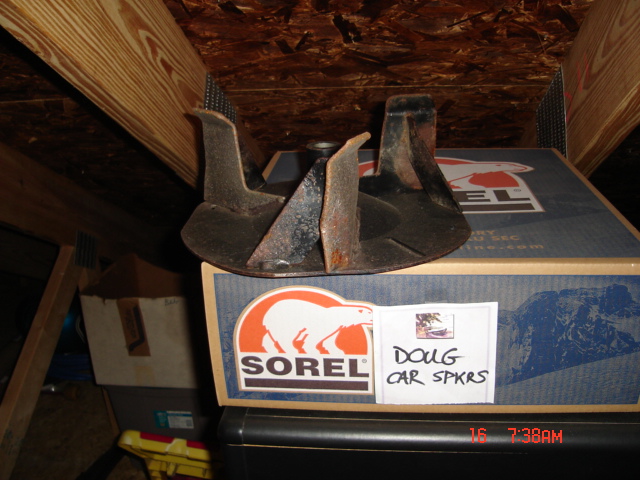

I came across this thread and I know its long gone so apologies extended. Maybe its relevant now anyways to a few as the snow's upon us again. I find with my blowers that they do work much better when their throats are filled with snow. At that point, you have to tailor your speed to get the right results. Too fast you are pushing snow and it builds up first at the sides and then over the top if you really are going too fast. Best seems the speed that has the paddles of the blower making a throbbing noise as you go. Seems that when I hear that, then I know my blower is working efficiently. You can tell cause its blowing the snow the greatest distance and everything its being fed is being thrown out.
Now... on the snowblower performance. It appears from what people are saying that the luck now blowers blow well. I picked up an old Inland 3pt blower several years ago, against my better judgement having not researched it, but the guy who I bought the tractor from [ Simplicity 9523 23hp 2 cyl Diesel ] had the blower and my dad was like "heh, he has the blower right here he'll sell you, > JUST DO IT! " . Well, I did just do it. And with high hopes I might ad no lie. So we get our first snow some 4 years ago right? It's a heavy wet half melted pile of dung. I take my new/used tractor out, all excited you know. Try it out on this and the f*$&er us barely moving the snow out the chute!!! BOY, WAS I DISAPPOINTED! Even on the neighbors paved driveway across the street. I would set the blower down, engage the PTO, start backward and the blower would literally push the snow back in a sheet about 3 inches thick until the weight of the tractor was exceeded by the weight of the snow plate I was pushing, and then the tractor would just sit there and spin. LOL I can at least laugh about this now. fwiw
So I set about researching how to fix this. First was some proper snow. I thought, heh, it's the wet snow that's beating me here. So I try it out on powder snow a couple weeks later and I am getting like 7-15ft throw distance. That is the outside of the stream, not the inside. Rats! It's no lie that I went round and round with this thing making it work and I would like to have the hours back. I cleaned rust off everything. Especially the chute. That made little difference. Some not much still disappointing. I ended up doing my own Clarence's Impellor kit. I ended up putting pieces of sheet metal on the ends of the impellor blades. These were maybe .025" thick and maybe 2 inches long but as wide as the impellor blades. I quickly discovered that my impellor housing was NOT round but instead oblong! So in my particular case the bottom 90 degree area below the discharge chute itself is the widest point in the housing and it gets tight at the discharge. Now that being said, it was not tight anywhere before modification. It was more than 1/4" gap at the discharge and closer to 1/3" as I recall.
I set to doing the impellor kit which reduced the clearance at the bottom to maybe an 1/8th of an an inch and had my clearance at the discharge at like no clearance it was so close. LOL In fact, it was so close I had to cut the top of the housing because the area past the discharge actually had the tightest clearance of all. So much so my metal impellor extendors were hitting up there. So I made a front to back cut with the hand held grinder and then two cuts down the housing side towards the auger chain drive. Just enough to pry that area up out of the way of the impellor. I then stuck a piece of metal in there to hold the metal flap up. I used carriage bolts with the rounded tops on the impellor blade flat side to minimize drag there. fwiw
I also ended up striping the whole inner housing and impellor using an air driven wire wheel setup and painting the whole housing and impellor.
Results? Well, lets just say my throw distance went from about 13ft on the outside of the discharge stream with all the rust removed to about 17ft with everything painted to about 33ft at the very outside of the stream with the impellor kit. Unfortunately, in my particular situation this is shy of what I would like for throw distance as I'm situated in a nook with the outside from the house uphill into the woods and the house on the other side and its a big turn around area in there. So I have been doing a lot of thinking about designing an accelerator, chain driven jackshaft sort of affair, like someone else previously mentioned. But in truth, that is reasonably beyond my capabilities to do so. I seem limited by the 540rpm PTO speed and my tractor is not a dual speed PTO so this is a bit frustrating. I checked out formal PTO setups to speed up the output and $$$$ so that's a no go.

Building a new impeller isn't hard. I started off with a 2' square piece of 3/8th's inch thick steel. That went to the machine shop to have a hole cut in the center and a Browning type hub welded into it. I then cut 4 pieces of 6" channel iron exactly the same length and welded them into the four corners. I measured everything pretty carefully and braced the back sides and tied the centers together too. I weighed all my welding rods and the bracings to try and keep the impeller balanced. I left a large enough hole in the center so that I could balance the impeller at a tire shop. I ended up welding on one ounce to balance the impeller. The best part is that it works and not bad either. I have no idea how well the original three paddle impeller worked as it was beyond repair. This snow blower had a 1000 rpm yoke on it and I just left it like that as you can always idle the tractor down to avoid overspeeding. (Ya right like that's going to happen)
