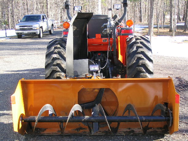

I've got a woods ss74 snowblower. Works great, but the last two storms we've had was like fine powder. When blowing this stuff, mostly when it's dark you can't see nothing out back there with the tractor light on. So I put a light right on the blower it's self, between where the snow gets feed in and the shoot. That solve the problem. Works great. Oh and turn the back work lights on the tractor off.

I've got pictures of the light set up and also the electric motor for my shoot.
/ snow blind
opps forgot to to attach pic, here's one

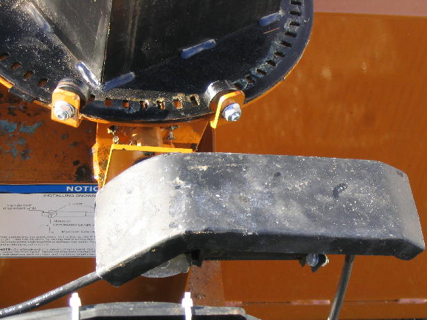

Here's my $5.00 electric window opener motor, for my shoot. View not so good cause of the guard over it.

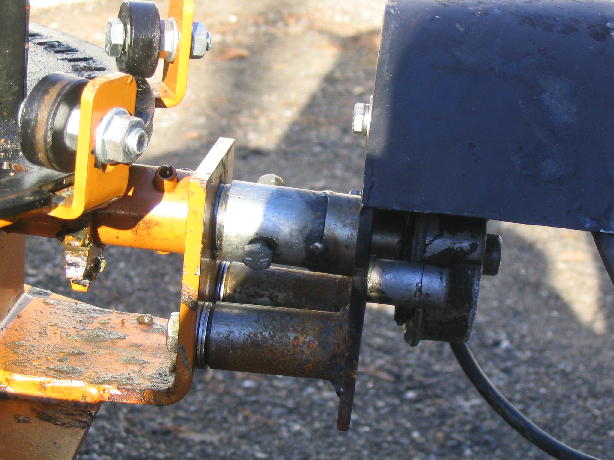

another view

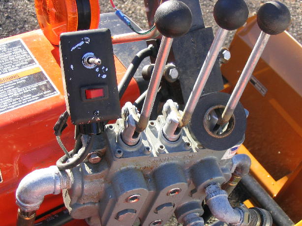

Here's comand-central. The top toggle switch for is the shoot , move left or right for turning shoot. The bottom is a lite toggle switch for when the blower light is on.
/ snow blind #8
Whats that roll of elect tape on the lever for? Neat looking set-up, and all for just $5. Its amazing what we can come up with when we don't want to spend our money.

/ snow blind
The tape is for in the field repairs, Ha ha
