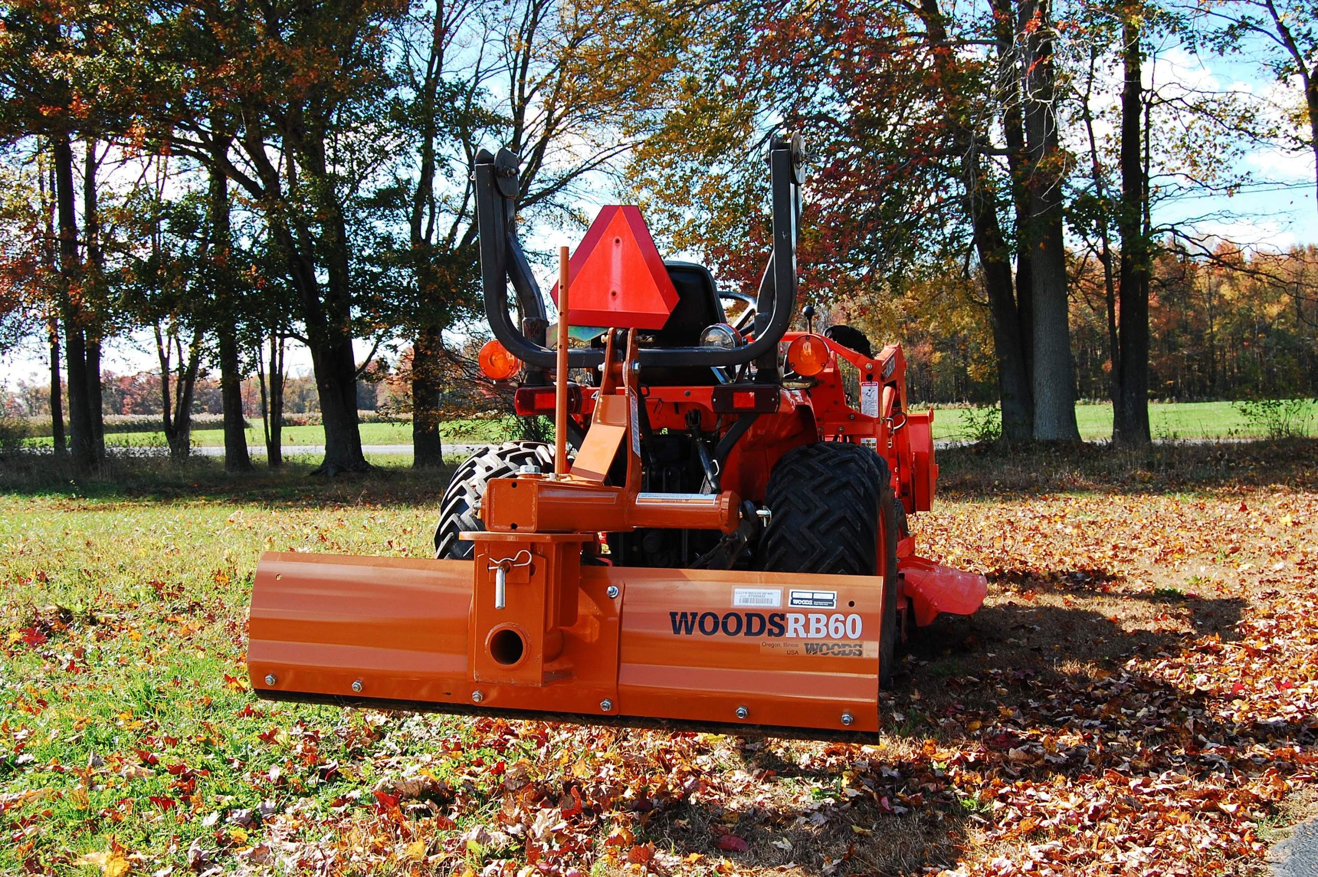

I bought a rear blade for the tractor for pushing / pulling snow . You do have to get off to change the angle but it is a small inconvenience for the price . Was able to try it out this weekend with 6 inches of snow it worked well enough to expose most of the black top and the sun did the rest .

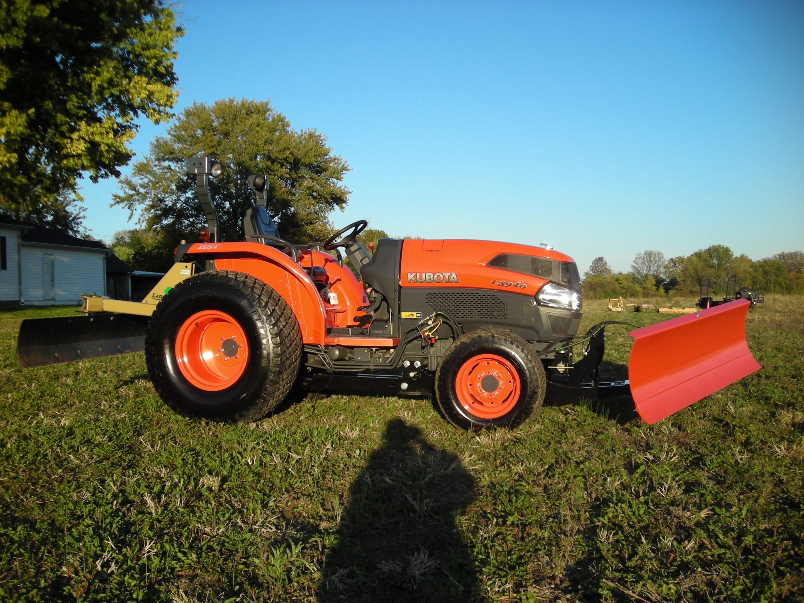

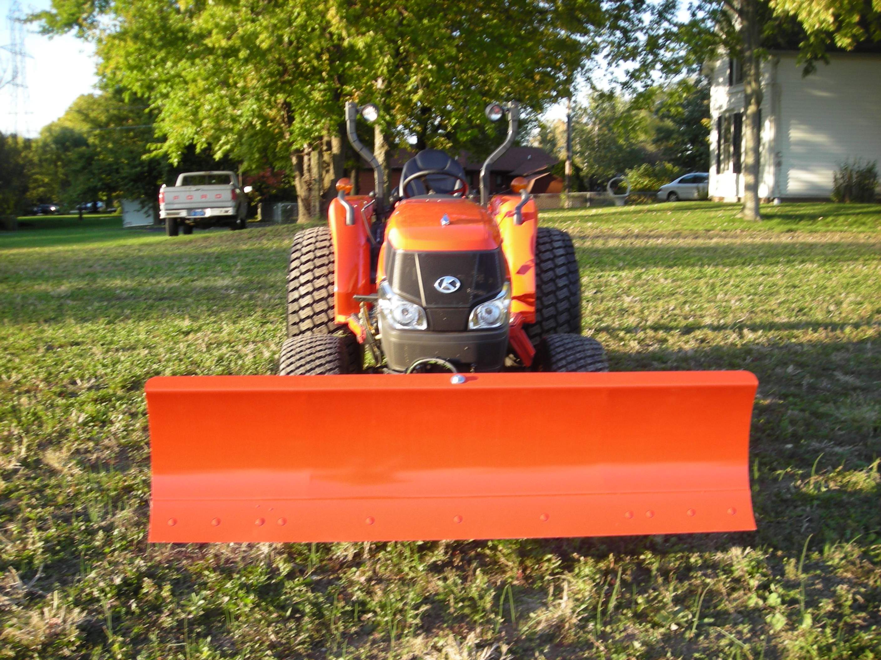

I have factory FEL and factory quick-hitch front blade, and have moved snow with both. The FEL is fine for picking it up, moving it, dumping it, coming back, and doing it all over again. The only time I use the FEL now is to build a snow mountain for my kids. Like you, I dont have alot of time during the work week to move snow. The quick-hitch front blade is amazing fast at moving snow, just like a pick-up truck, but you can see alot better. I put the blade down and push at 8 mph. Two passes and a little clean up here and there, I can have the job done in a fraction of time compared to the FEL. Changing out from blade to FEL is not too big of a job. Blade takes about 10 minuts, FEL about 5 minutes. Philip.

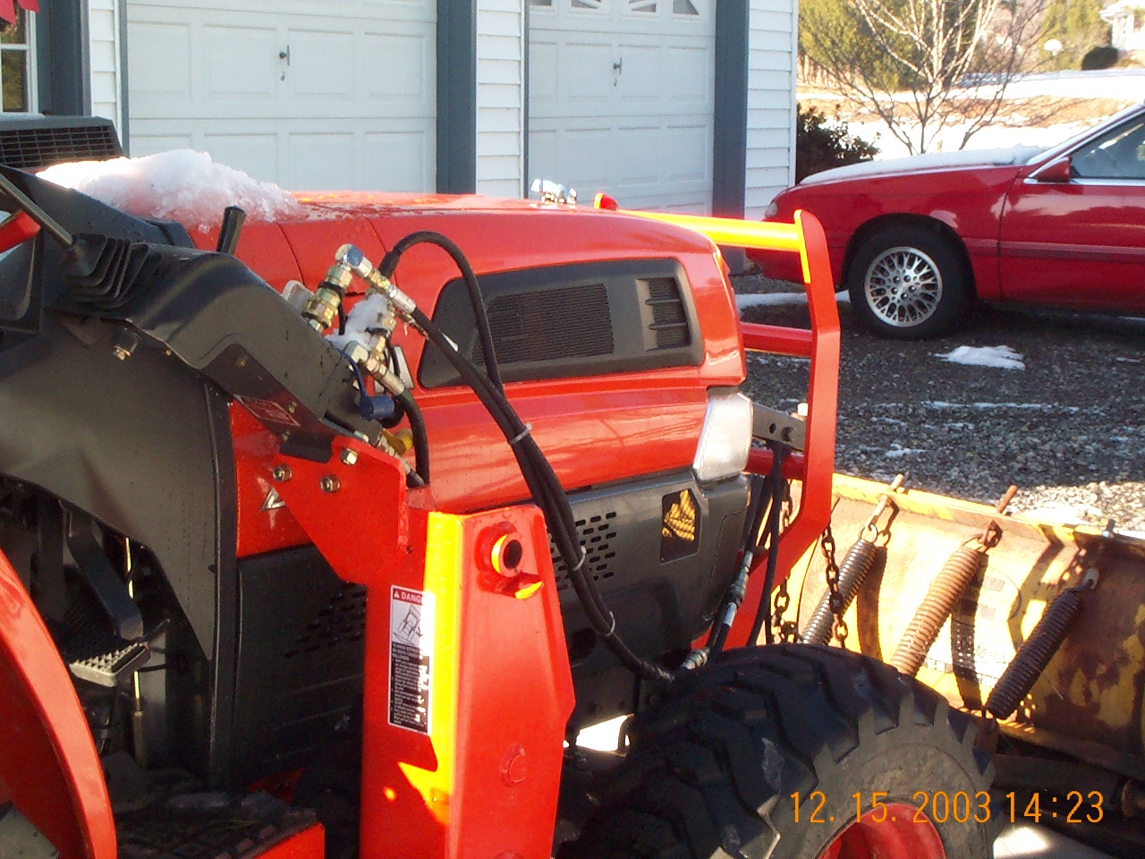

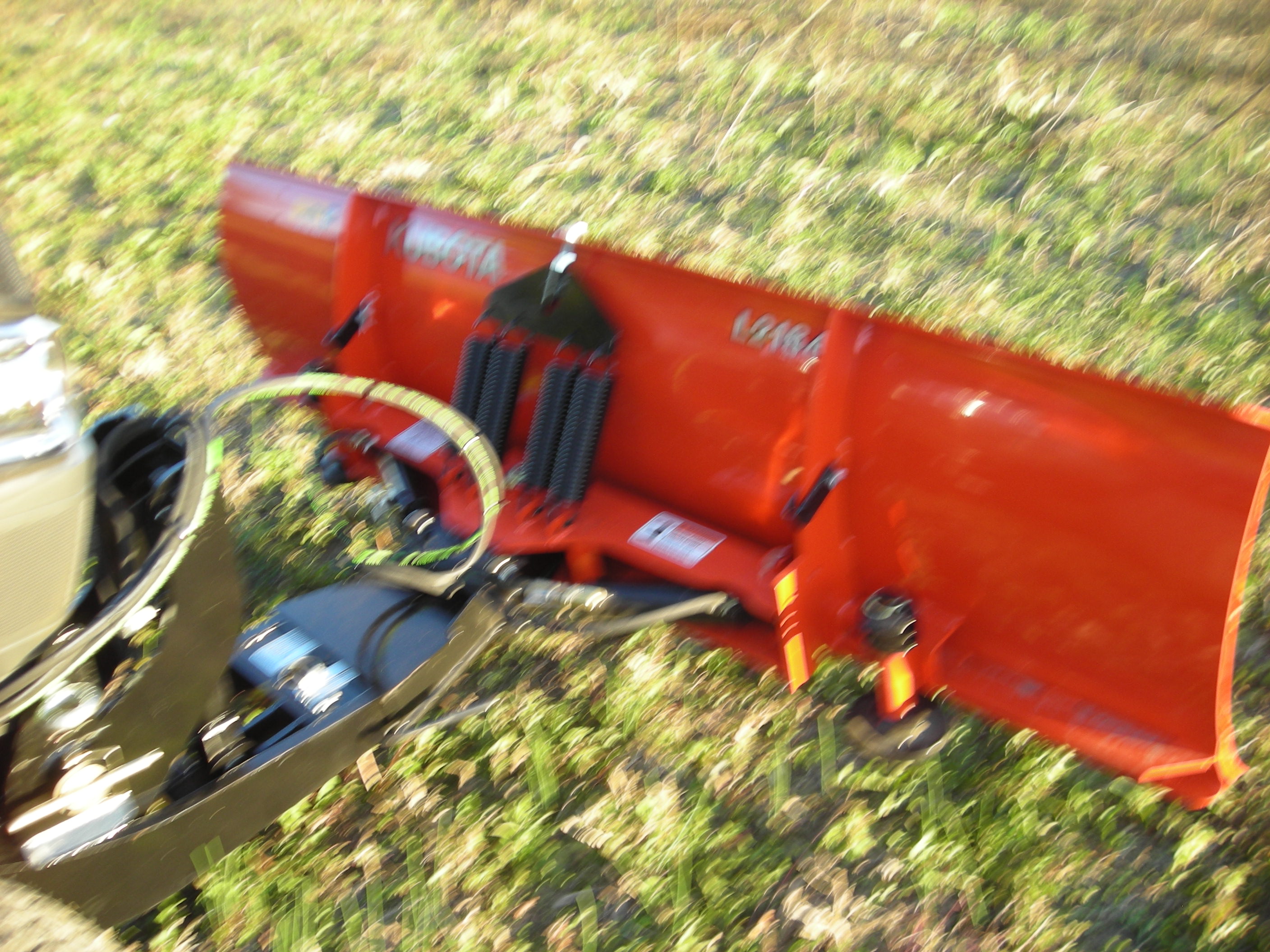

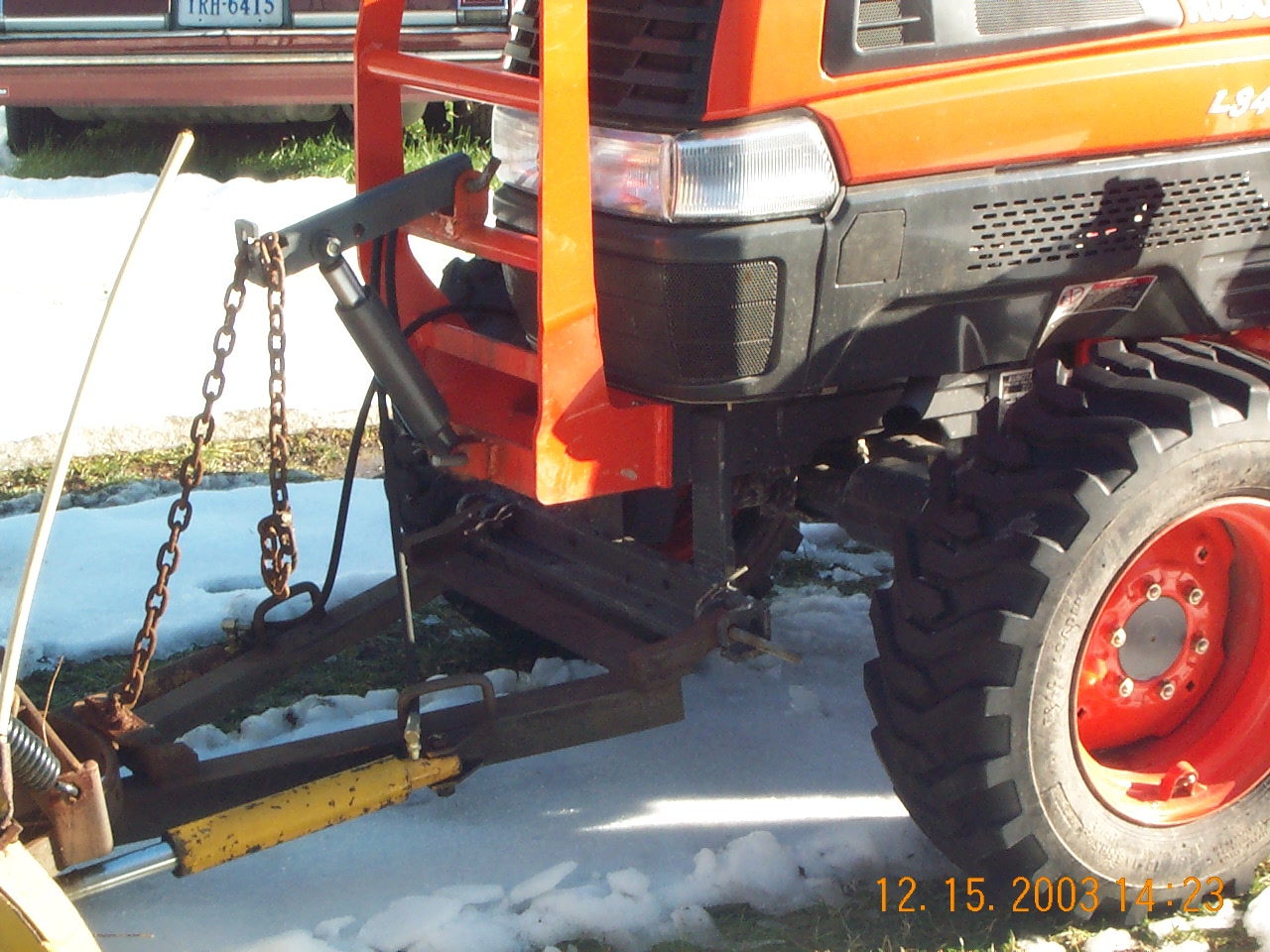

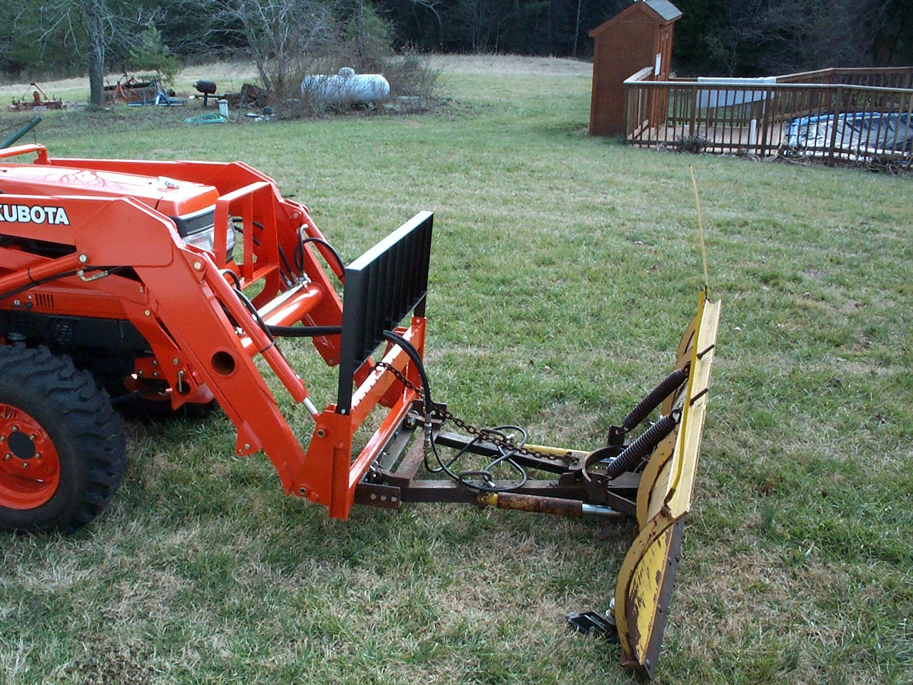

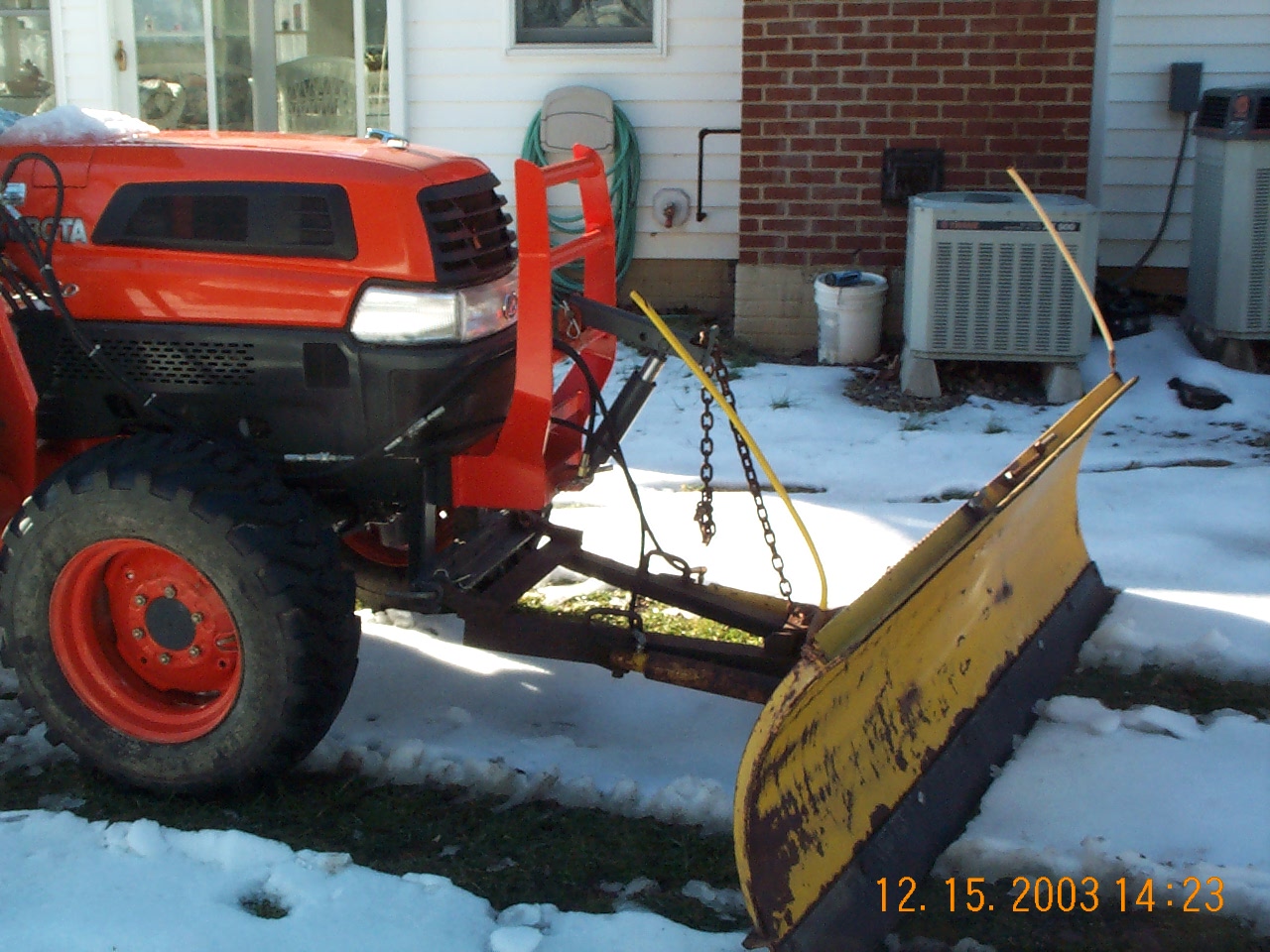

That is exactly why I changed from this type of arrangement to a sub frame. With a lighter tractor like my L3430 to length of the loader arms made the plow into a big lever that kept pushing the tractor around. The subframe mount has completely cured that.
You don't need to spend a lot to go this route. I spent a couple of hundred bucks on an old Meyers plow and mount. I mounted the sub frame to the tractor and the lift cylinder to the brush guard. I use the loader valve to lift and angle the blade. Even if you can't weld, I'm sure you could get the work done for a reasonable price.
I can take off the loader and put the blade on in less than 15 minutes. I have never wished I had the loader on while I am plowing snow.
The first picture is the old arrangement; the other three are what I use now.
