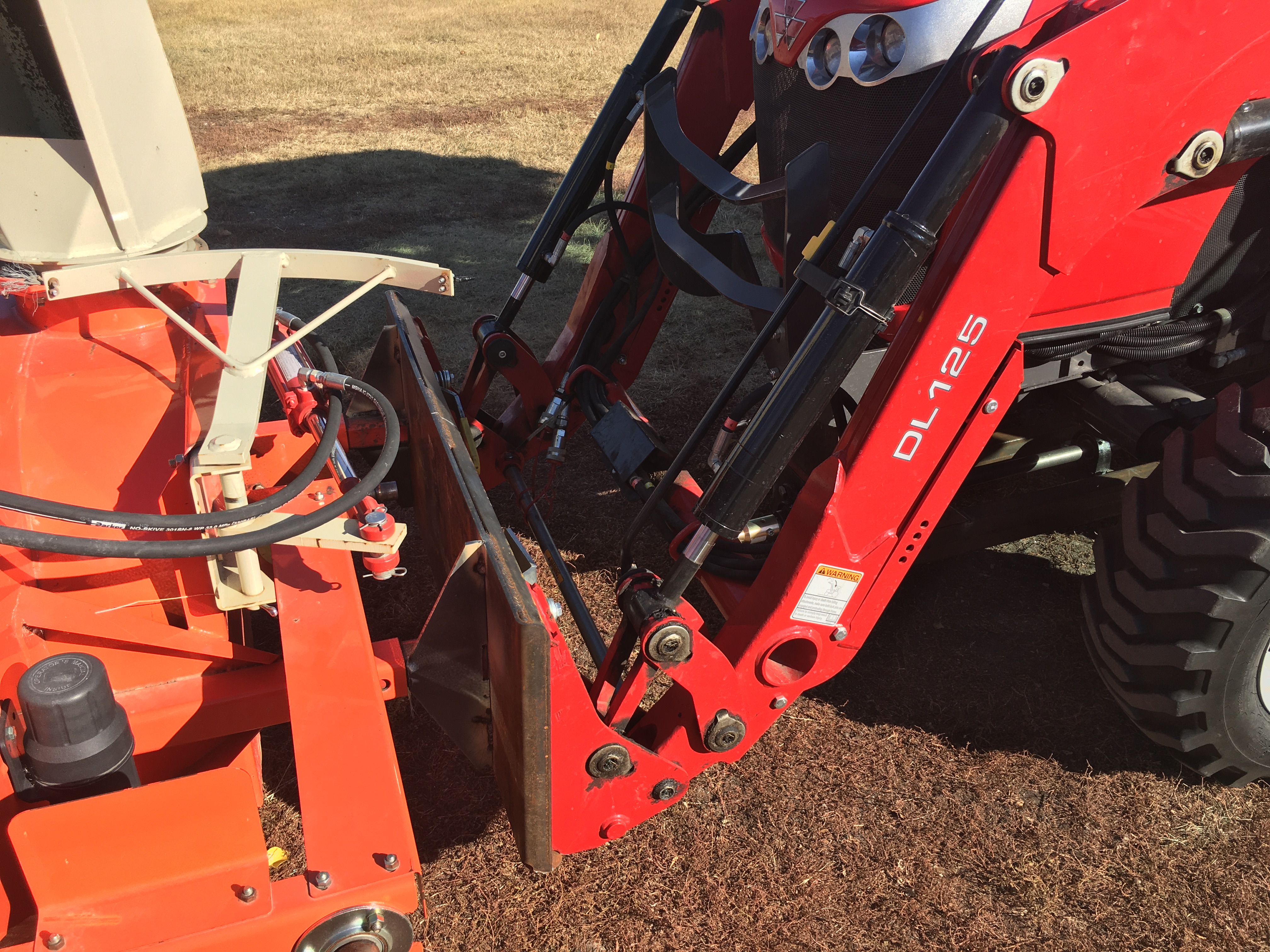

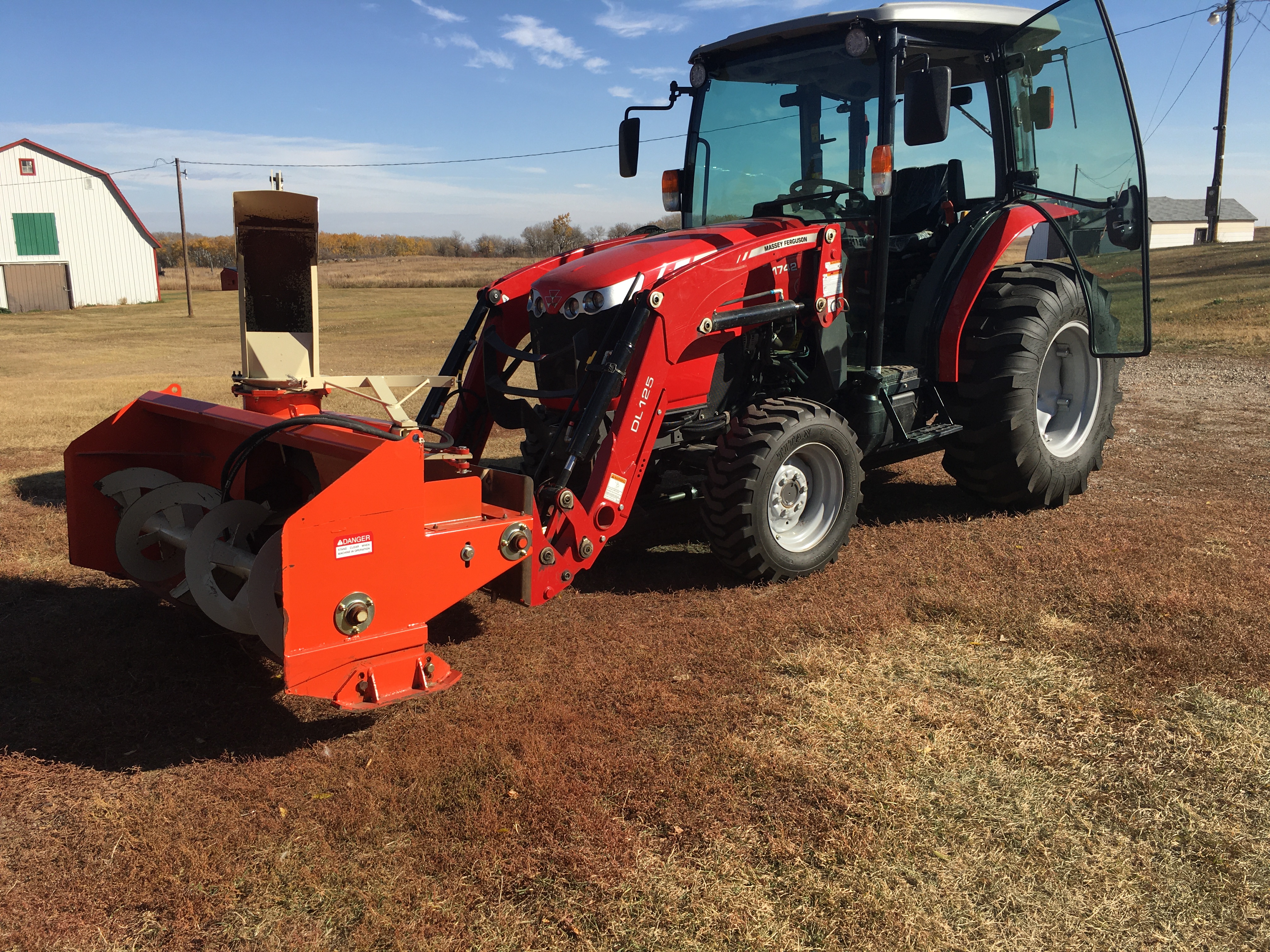

Back to my fel blower. Slow progress, getting older. Ssqa plate on the blower. 25AFDB62-6DFC-4729-83D5-CBBABABD6ADC.jpeg81F40D09-9ECC-4CBD-A2B2-5AB392B4B53E.jpeg

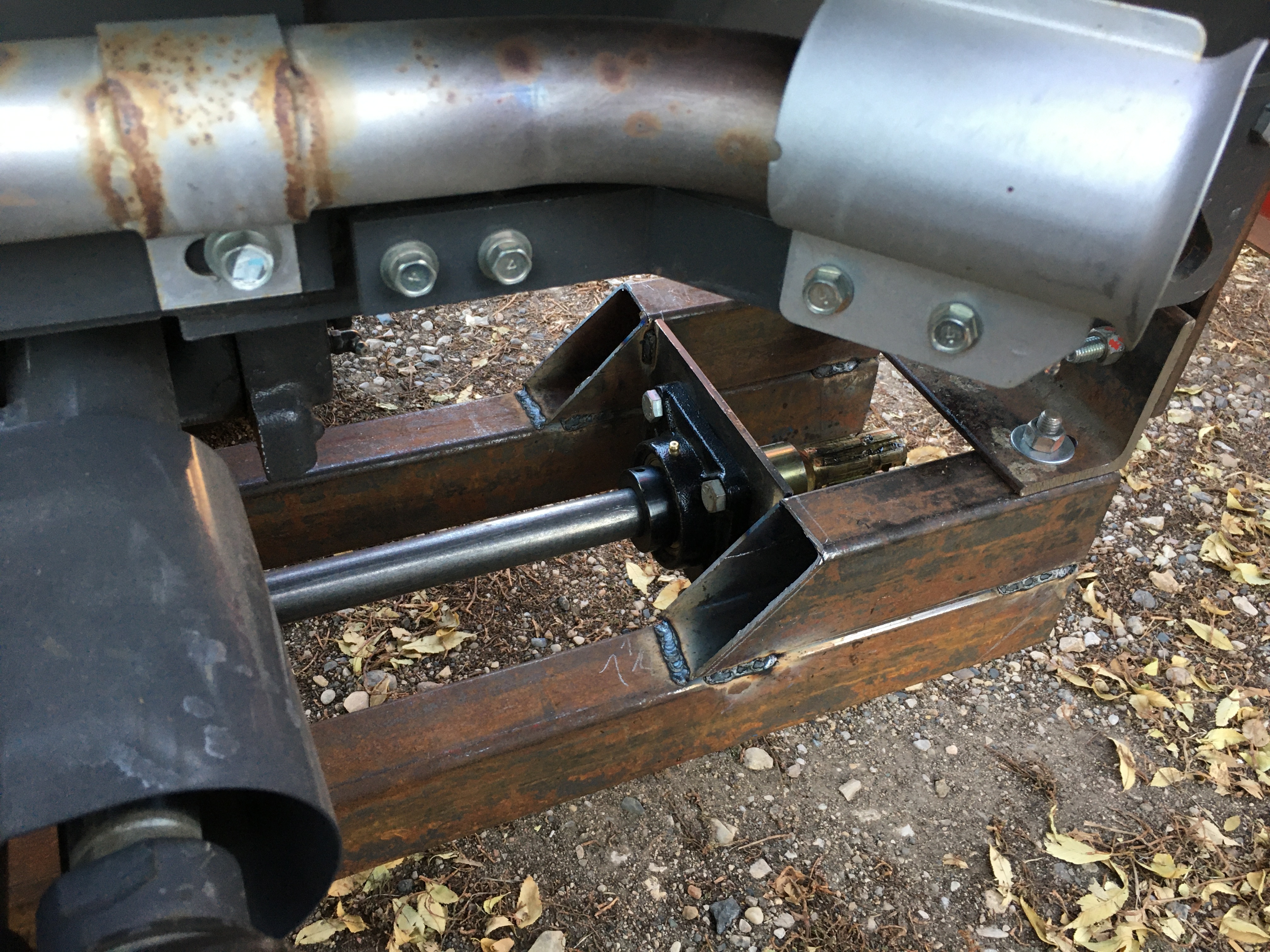

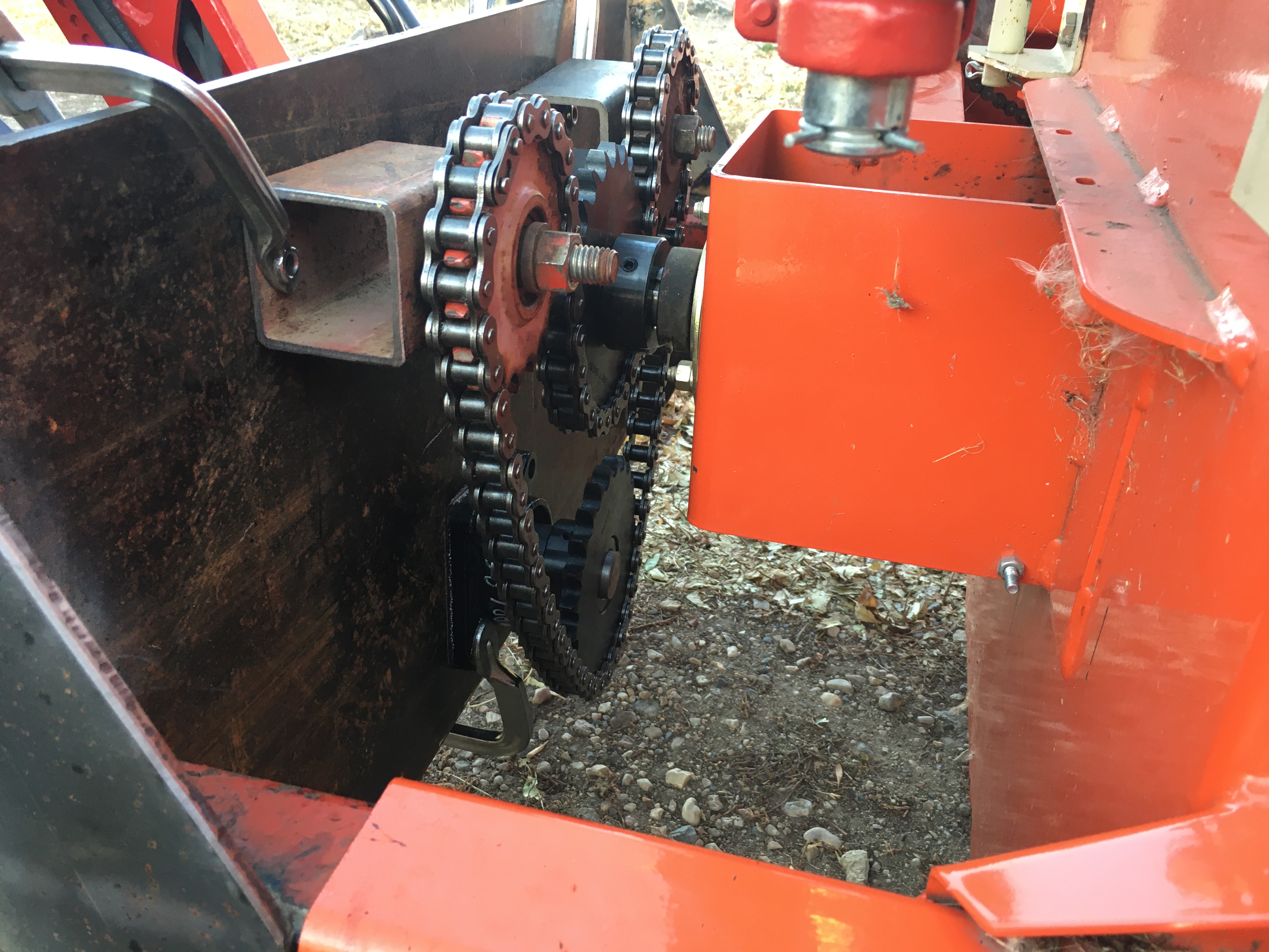

I built a rear pto chaincase with a double row #50 chain. The case is close to the pto so I can still utilize the three point for a back blade. I like the positive power transmission like the Erskine and Schulte blowers. Experimental of course, lots of sittn n thinkin. The rotation issues will be #60 chain with idlers in front of the ssqa plate. No mods to the blower so it can be returned to regular three point configuration.

Mechanical driven from the rear? Will you chain the loader in position so you can't move it too much?
   / Snow痴 coming
Prob use slotted flat bar on the lift cylinders to limit travel.

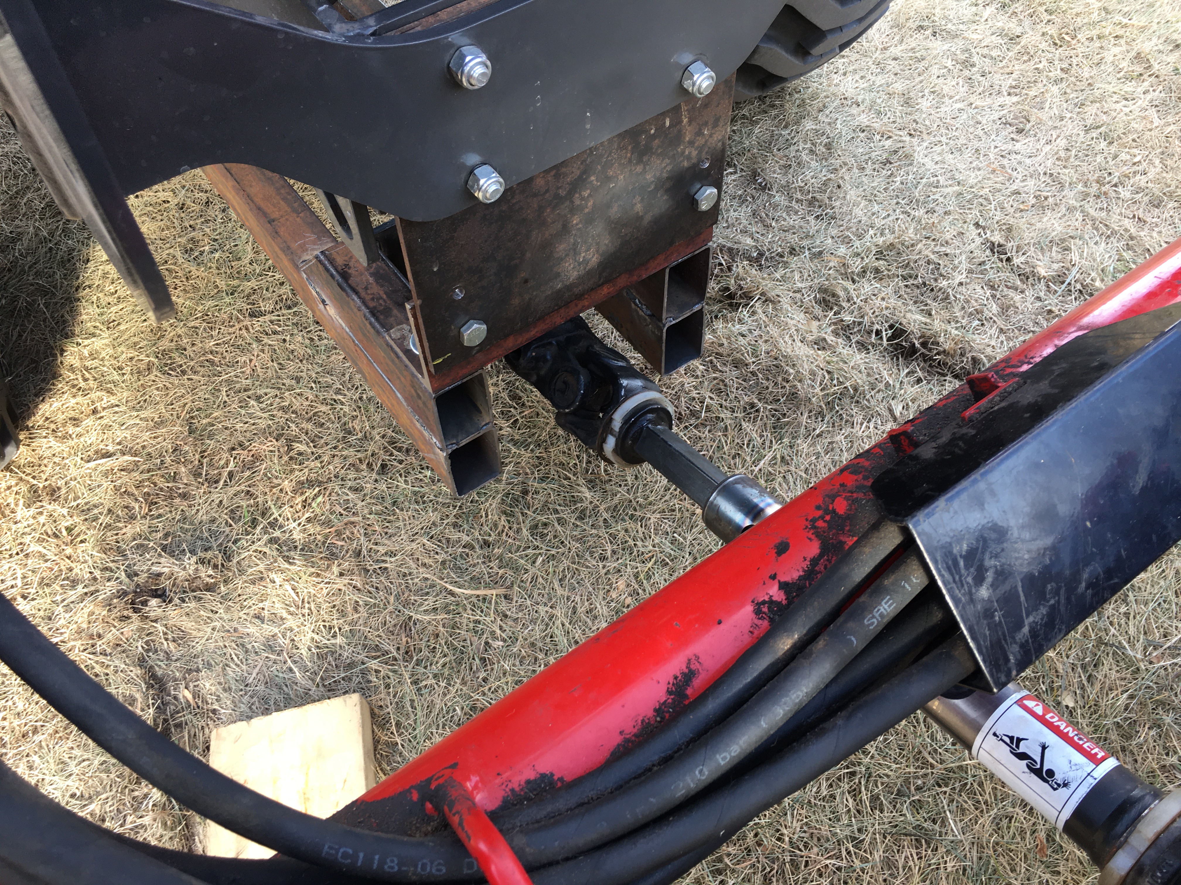

Snow is not here yet. A little progress. 8A62B80D-C9EF-4085-B73E-506846FF5E9D.jpegBC1C0F58-8FCB-40B0-855E-D7A70FF49589.jpeg

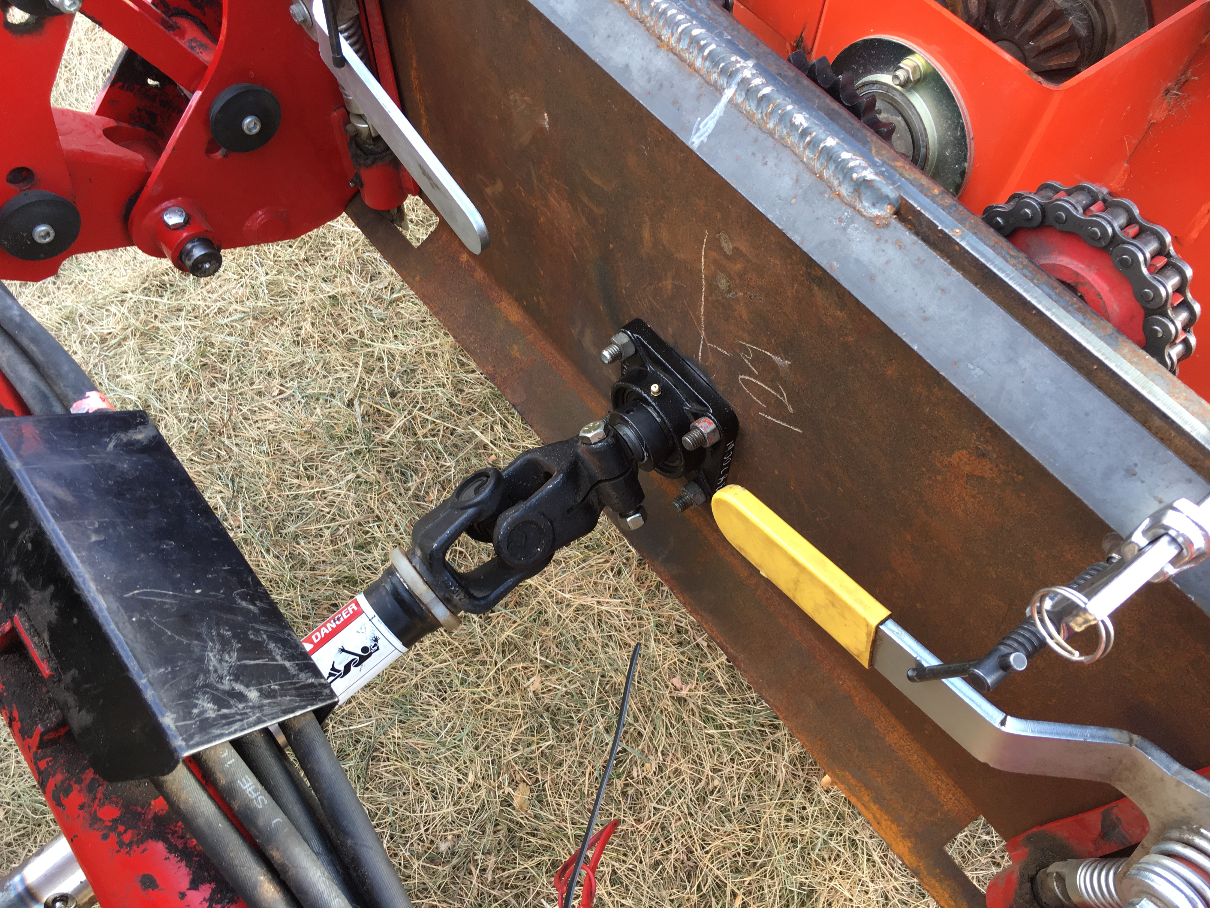

Getting closer every day. Have about sixteen inches of lift without compromising the pto shaft. FD83D879-9B66-4E39-A90B-94BF6A085FE4.jpeg5A02A0D1-65EF-4D73-9073-2951F6A4A96A.jpeg[ATTACH
