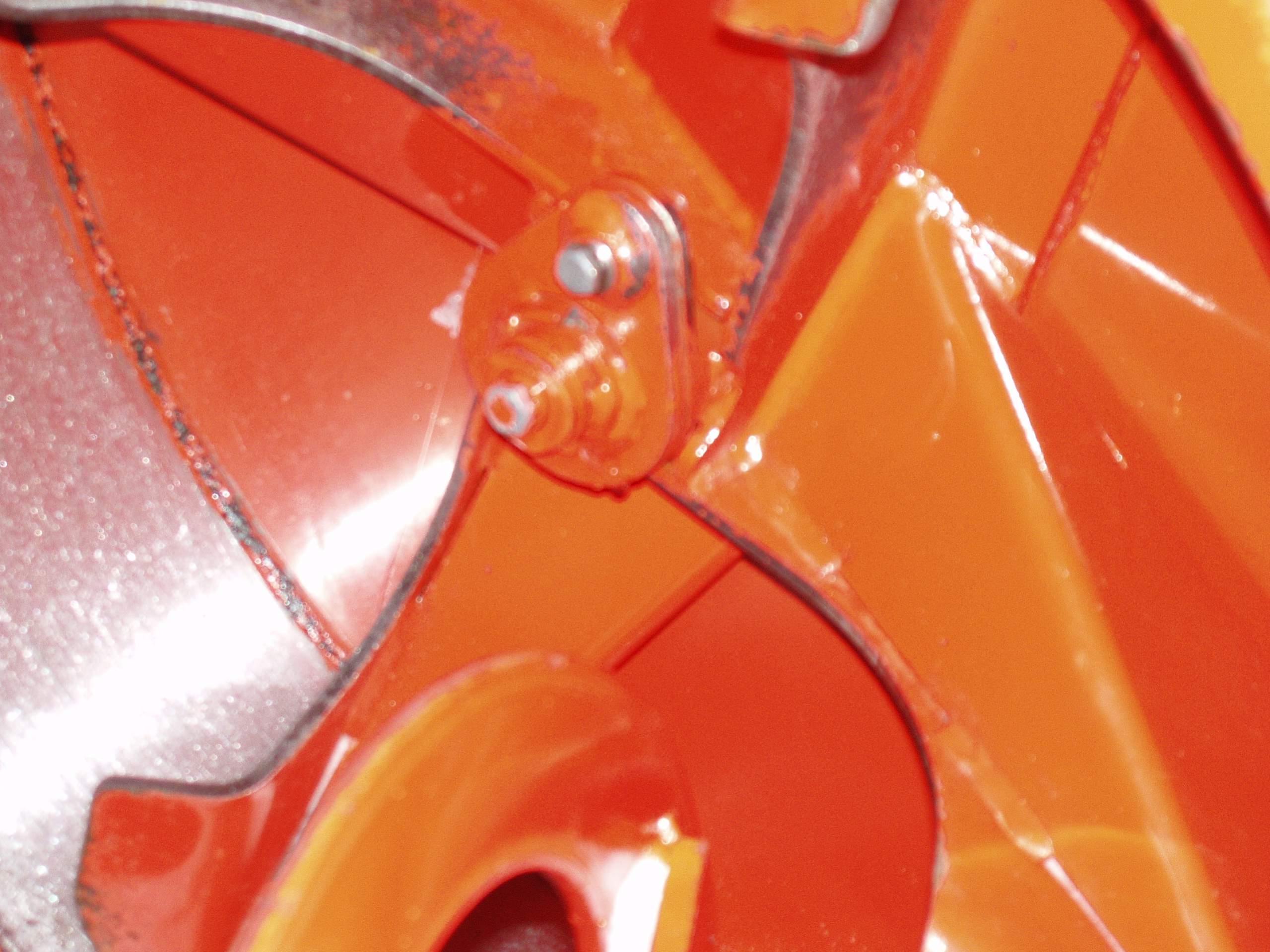

Most shear bolts go thru a yoke and shaft arrangement so the bolt is not compressing the outer piece to the inner piece.
On my blower there are 2 flanges at 90° to the shaft and a bolt goes thru them. The tighter the bolt is the more force to shear. The impeller moves just a bit as the bolt is backed off a tiny amount after tightening.
Both of mine came loose from the factory. They probably would not bother with self locking nuts if they were supposed to be tight.
The auger drive on one of mine has a shaft within a tube and a thru bolt, that on has a lock washer and is put in tight but the auger is still not tight on the shaft.
Oh, and you have me beat by about 5 years running a blower but I have about 35 running machinery, by no means am I an expert.
One last thing, the owners book does not give a torque spec, they say "check for proper tightness", a lot of good that is.

I will get some pictures tomorrow showing the bolts and chain. I realized I don't have a big enough chain breaker to get the new chain to the right length. I will have to grind it I guess. I feel the alignment is good. I put a straight edge on it and all was good. I am thinking the chain may be a bad one and the bolts are tight but not super tight. They have nylon lock nuts so that is not an issue.
The last two were rocks in the auger, but it still should break the bolt instead of the chain.
Need to call the dealer I guess.
Does your shear points look like mine???? Or do you have a tube within a tube???
Have you pulled the shear bolts and make sure the items can rotate freely when the bolts are out????

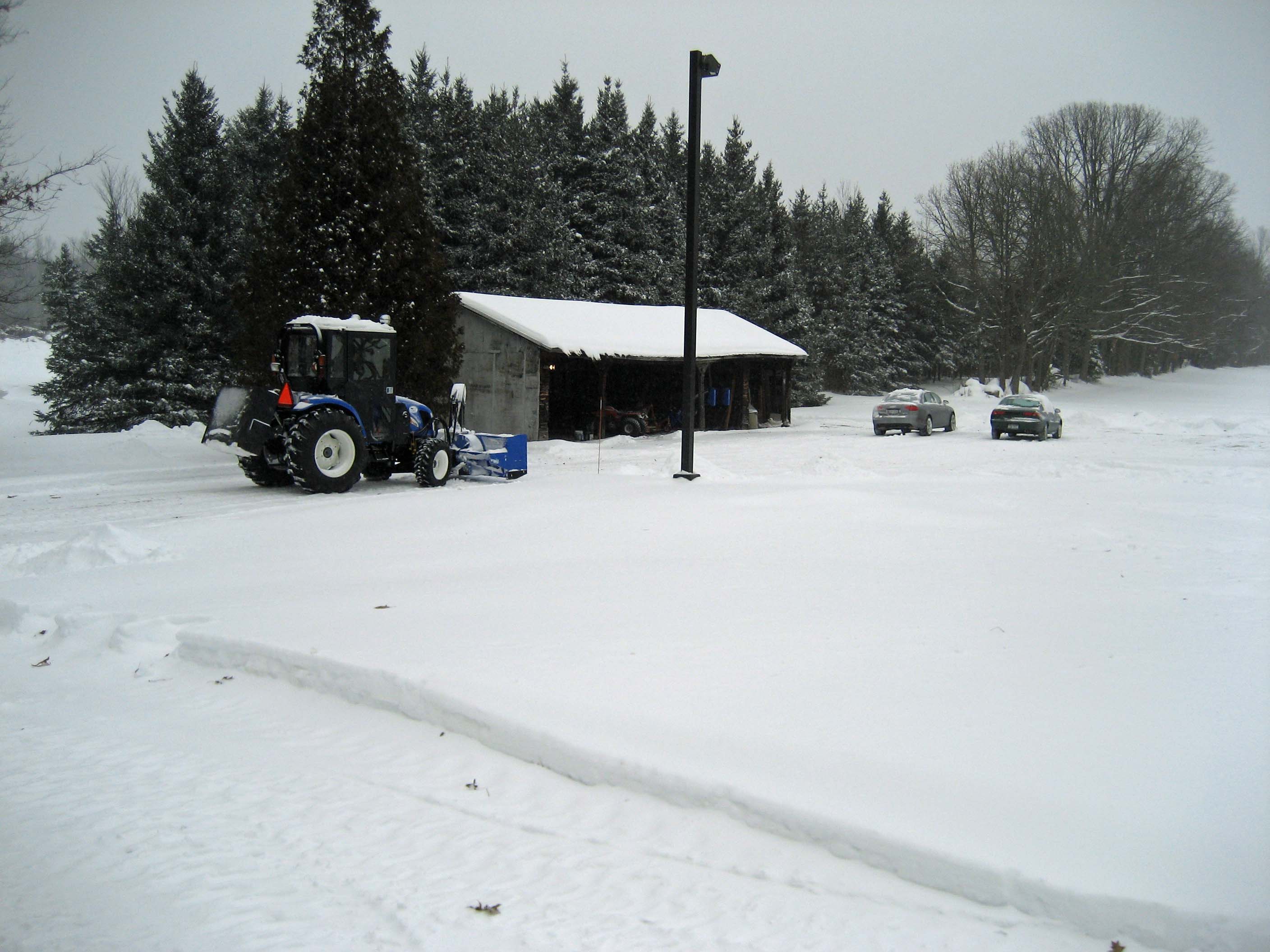

Wow I just came across this, I had the same setup on my TC 40 DA and never once in two years broken chain moving heavy snows as a matter of fact never broke even a bolt? That includes the Valentine's Day storm February 06 with a total of 43 inches in one shot what a storm that was the first time I was concerned about living so far out in the country, state plows didn't make the roads for two days, What kind of lubrication are you using on that chain? Perhaps it's just a bad batch of chains. if you've correctly adjusted the tension and the gears look okay can't think of anything else? it was honestly bulletproof for me it will be interesting to hear the outcome take care
