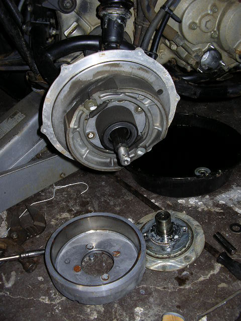

I snapped (don't know how) the right rear axle. I ordered replacement parts to fix it at camp. I'd like to know how to get the axle out of the rear end...any special tools or tricks needed? I don't have the service repair manual.
I'll also be replacing the brake caliper and rotor since that's broke too. So any tips to look out for are appreciated.
Thanks, here are some pics of it.

You will need a socket to fit the big nut that holds the axle to the spindle. On my brute force after removing spindle and axle nut, axle pulls out of diff. For the best info, try posting on highlifter forums.
/ Snapped Arctic Cat Rear Axle #3
it's pretty straight forward. Just like dirt clod described. B ecareful not to rip the rubber boot ( they rip easy for some reason )

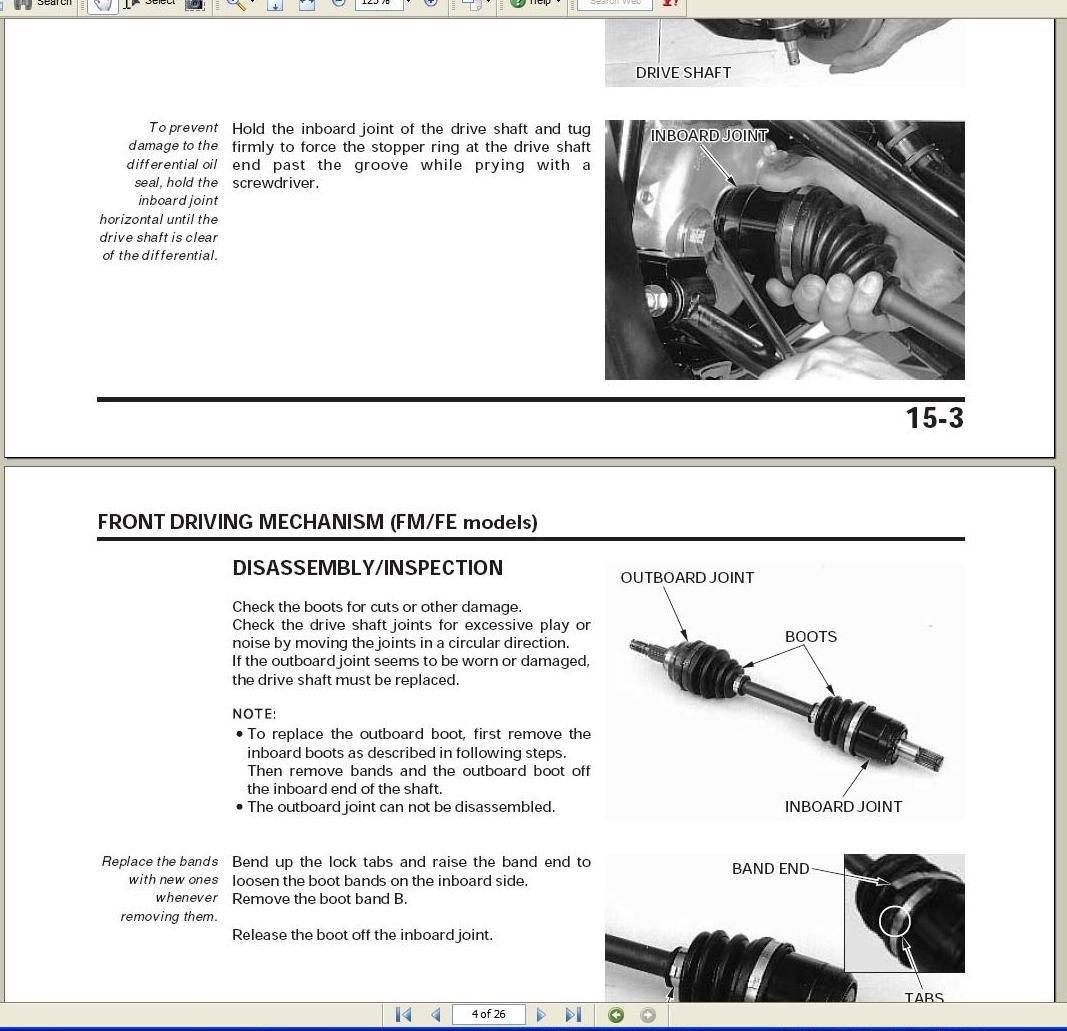

Ok let's try that pic again... Can't find my manual at the moment, it might be up at the weekend place to. But if I can post here is a couple pages from the parts manual. I don't recall anything major when pulling mine apart.
Rob

Rob, thank you for posting that picture and parts breakdown. I see a difference between our models though. First, the AC has disc brakes in the rear and second, it has two CV joints per rear axle. It has independent rear suspension. You can see the rear end in the second photo of my first post. The axle snapped where it enters into the right rear wheel, where the drive splines are.
I was really hoping to see how to remove the axle from the "rear end". I will have to take of the CV boot to see how to do it. Nevertheless, I sure appreciate you getting that information and trying to help me...very thoughtful.

They are the same, the parts picture isn't that great. Mine is also independent rear end and has both, inner and outer. I just can't find any better pics at the moment.
The Axle just pulls out of the tranny if I recall. Nothing else since the A arm and all keeps it in place. Pretty tough axle, I'm surprised it snapped in the first place.
That engine/rear end combo has been made by Suzuki since about 88-89. Mine is the 280cc version and is the 4wd. The old King Quad was the first atv with 4 wheel independent suspension, select 2wd/4wd AND a select front diff locker. I don't think they change the motor tranny in the 14 or so years it was made. My BIL has the AC 250.

So you're saying I can slide the axle out of the rear end with a little pulling? That's great to hear then. I was afraid I'd have to punch out some hidden dowel pin or need some special tool. Should be a piece of cake in that case.

Inspecting the damage, I saw that the right rear axle was broken off right at the serrations near the disc brake. This particular model has independent rear suspension so it has two rear axles on CV joints. I also saw that the hydraulic brake shoes fell out of the caliper. They were worn sideways, as though they had been out of position for a long time. I also saw the mechanical foot brake line was busted as well. I'm sorry I did not take many photos of the damage.
After making notes of what I thought was broken, I went on line to order new parts. A whole new right rear axle assembly complete with CV joints and new rubber boots, a new right rear brake caliper and a new foot brake cable assembly. The rotor was fine so I did not buy that. After receiving the parts, I finally had time to dis-assemble the CAT and make the repairs. One thing I was not sure of was how to get the old axle out of the rear differential? You can see I posted here and got help. You can also see in the following photos that all you do is stick a screw driver blade behind the CV boot and pry while pulling hard, exactly as described in this thread. It popped right out.
Here are the damaged parts.
#19
After getting it all apart, I removed the old hydraulic brake caliper and the busted foot brake cable assembly. I must say that Arctic Cat is first class in their manufacturing. All their parts and unique assembly was very clever and excellent quality. Since I had no shop manual, and everything in the owner's manual said whatever needed to be repaired take to an authorized Arctic Cat dealer, I had no instructions to do the dis-assembly other than what Rob had provided here in this thread. But I figured it out and it was pretty easy.
Well, I got the new caliper and brake pads on and also the mechanical foot brake cable. Then bled all the brake lines and adjusted the foot brake to "perfect". Finally, I aired up the tires to 7lbs and put it all back together.
I also changed the oil and filter putting in Shell Rotella 15-40 Synthetic oil. Also changed the fuel filter and spark plug and cleaned the air filter. Then I took it out for a spin and immediately made my way to "Big Hill" as the kids call it, a super steep long uphill grade on one of the trails. As I approached it I shifted into 2nd gear in "medium" transfer case and climbed right up that thing like it was nothing! What a happy surprise to find I got excellent traction in forward for a change. I had no idea how long that right rear axle had been broken, but now knew why it did not get good traction before.
So even though I had a million things to do, it was really satisfying to have the Arctic Cat running great again.
