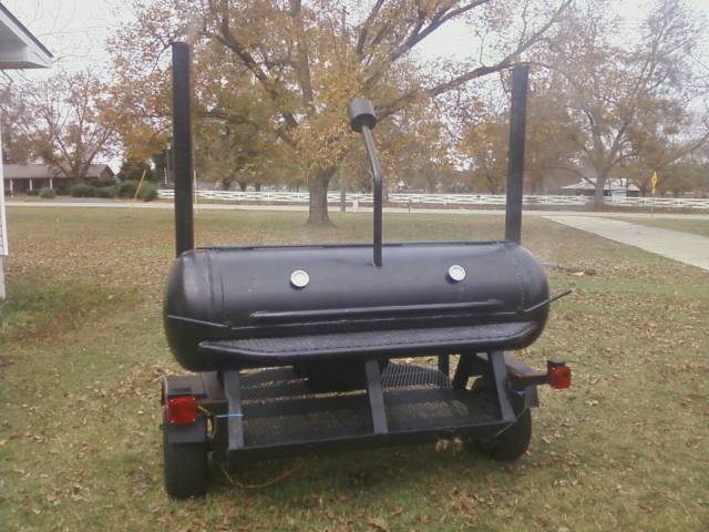

Here's an update...2nd turkey is on other side. That's the Boston Butt in the middle there...about 275 degrees...Put them on at 10:15 am...picture taken at 2 pm.
/ Smoker idea ??? #34
man that looks good:licking:
