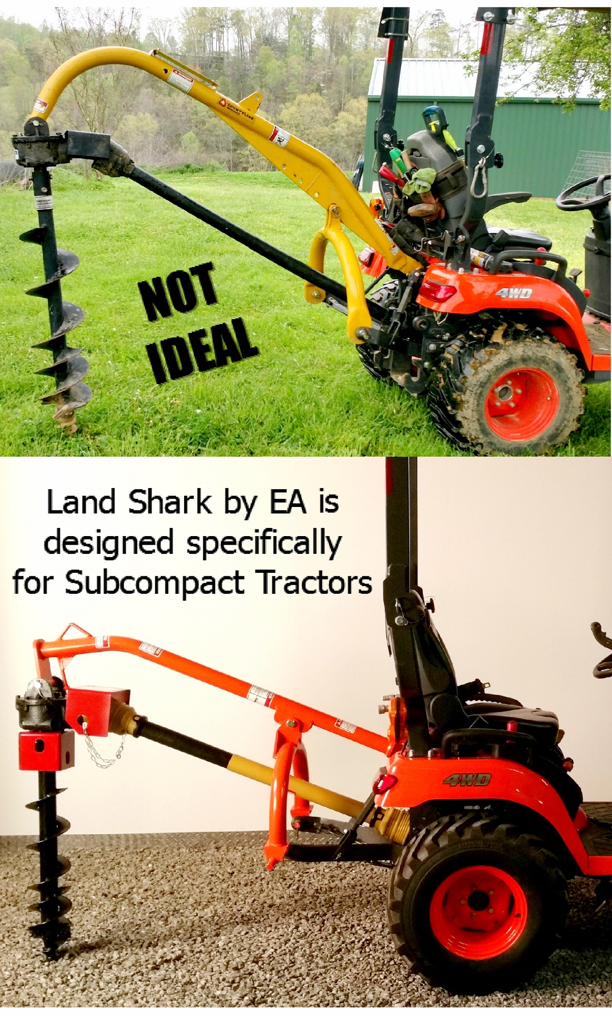

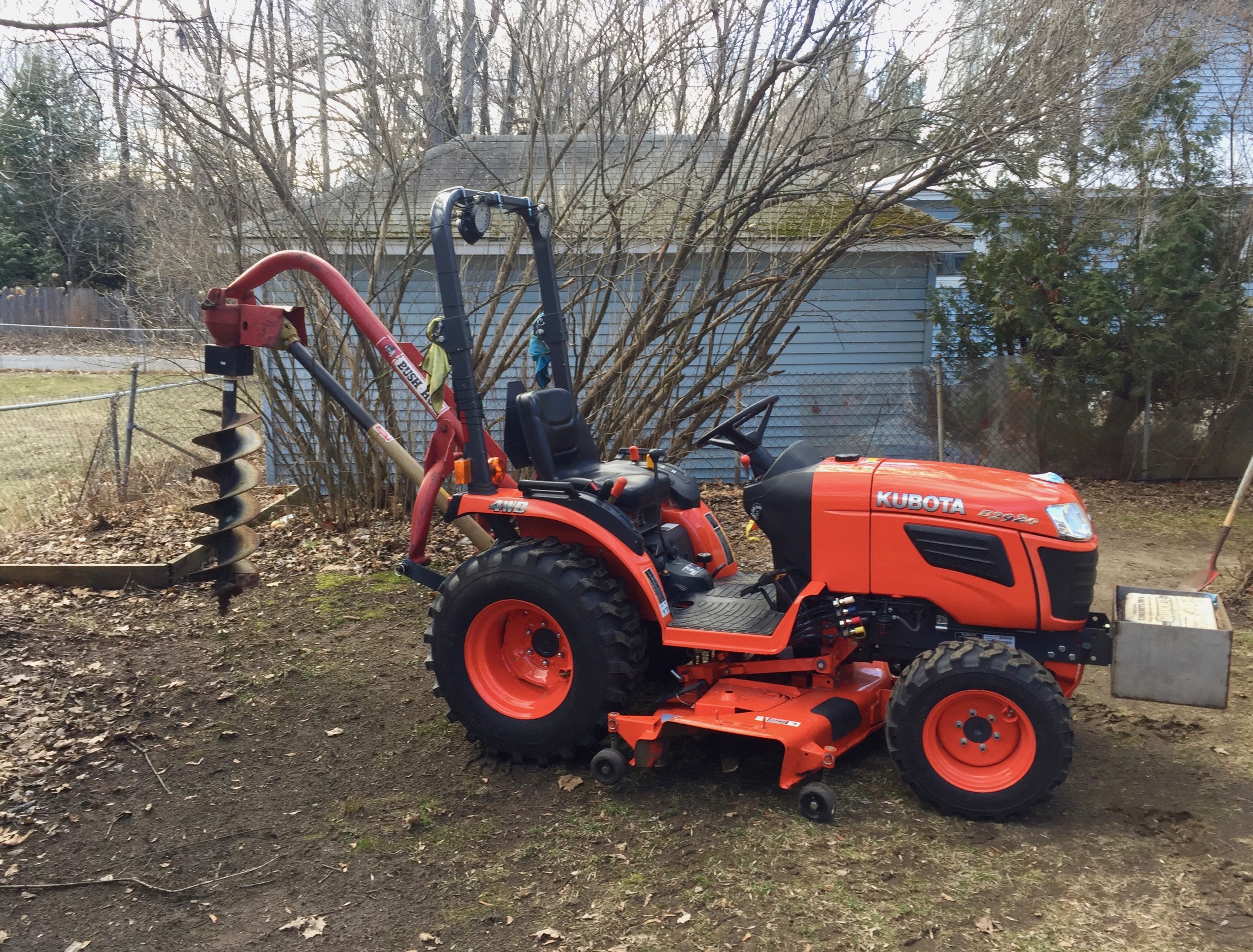

Our Land Shark post hole digger comes standard with a 36" long auger. Our BX2670 has 18" of ground clearance when the 36" auger is fully raised on flat ground. With that being said, we can include a 48" long auger if requested.
Travis
This guy has made at least 3 videos showing it off with a 36" auger on his 1025R JD.

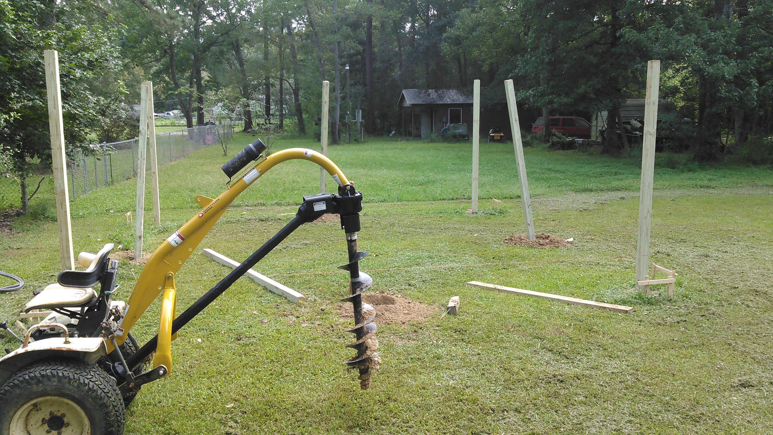

I used a heavy duty Bush Hog PHD on the back of my Kubota B2920. Its not as small as a BX or 1025R, but not much bigger. I had no trouble at all with it drilling holes for sono tubes. 21PTO horsepower.
/ Smallest tractor for posthole digger #24

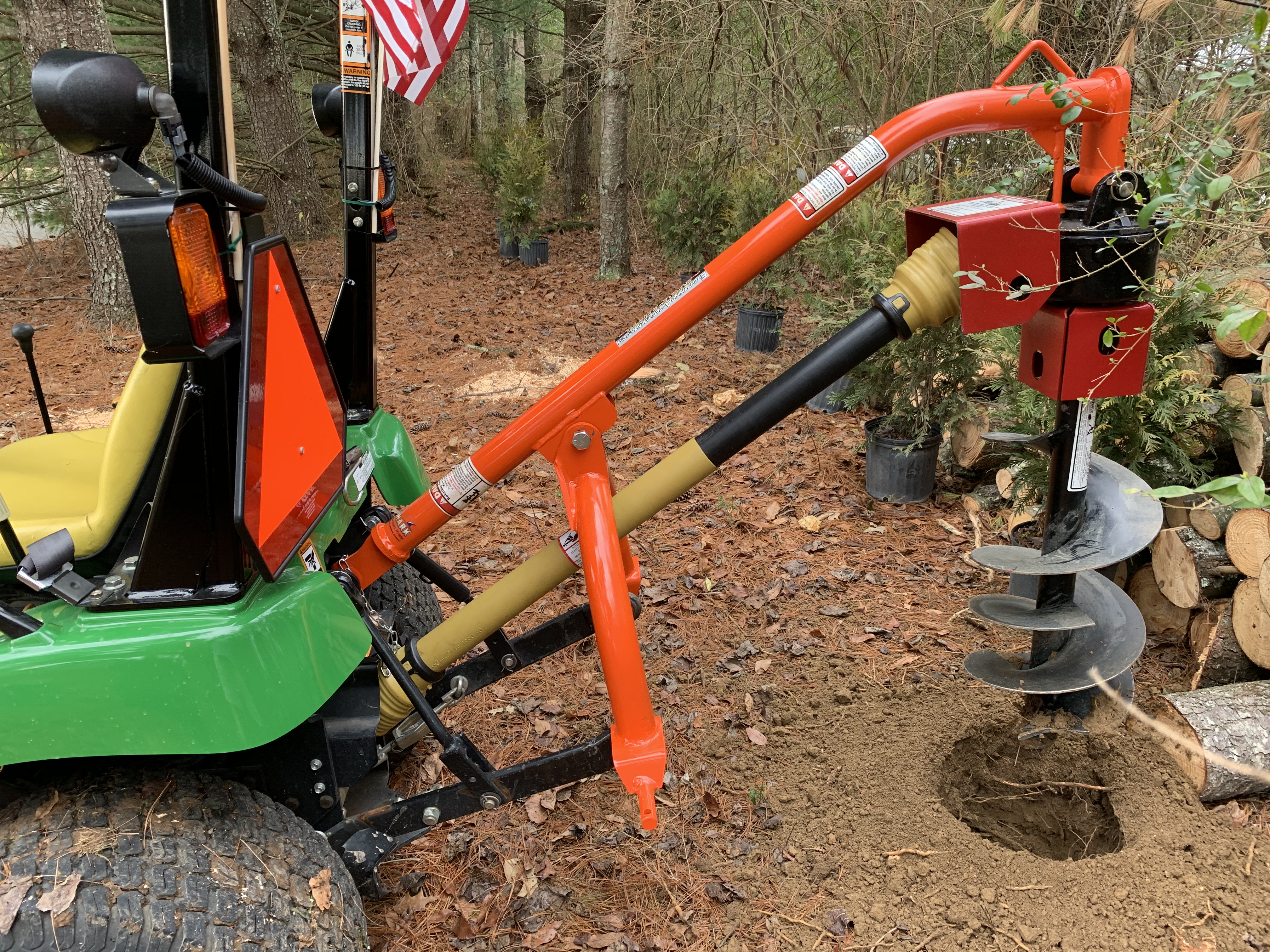

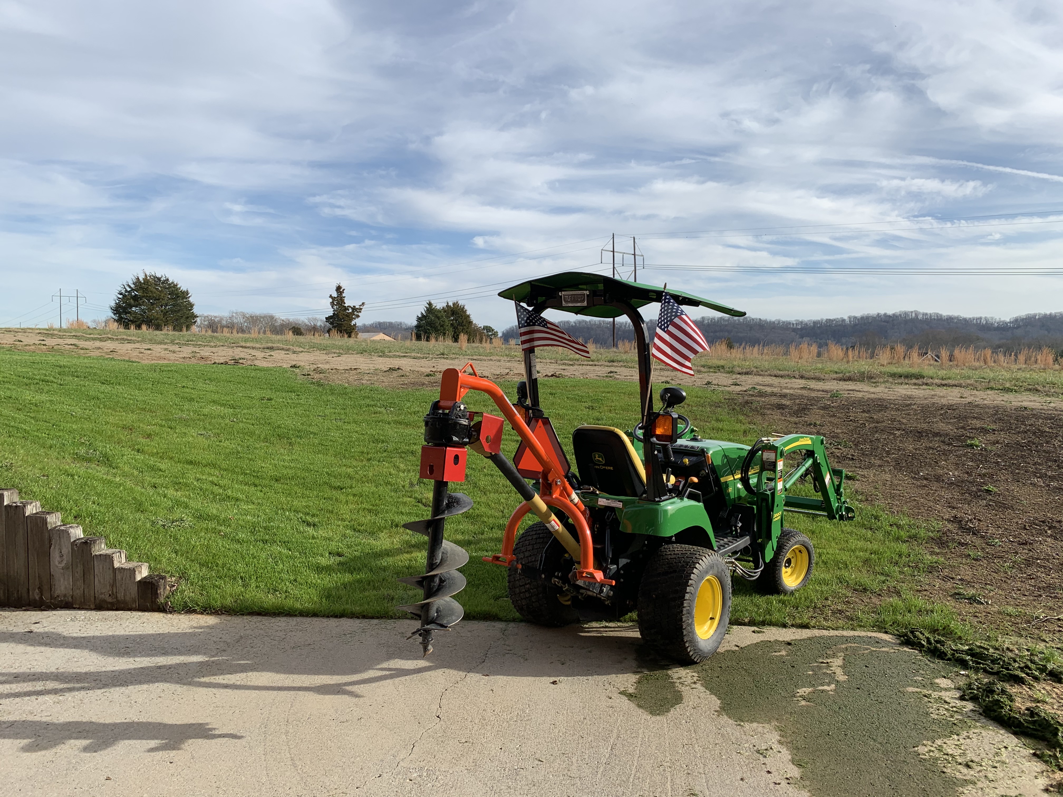

I purchased the EA Landshark a few years ago for my 2305 and just recently got around to using it. Works as advertised. It actually took me longer to get the tractor in position than it did to dig the hole.
