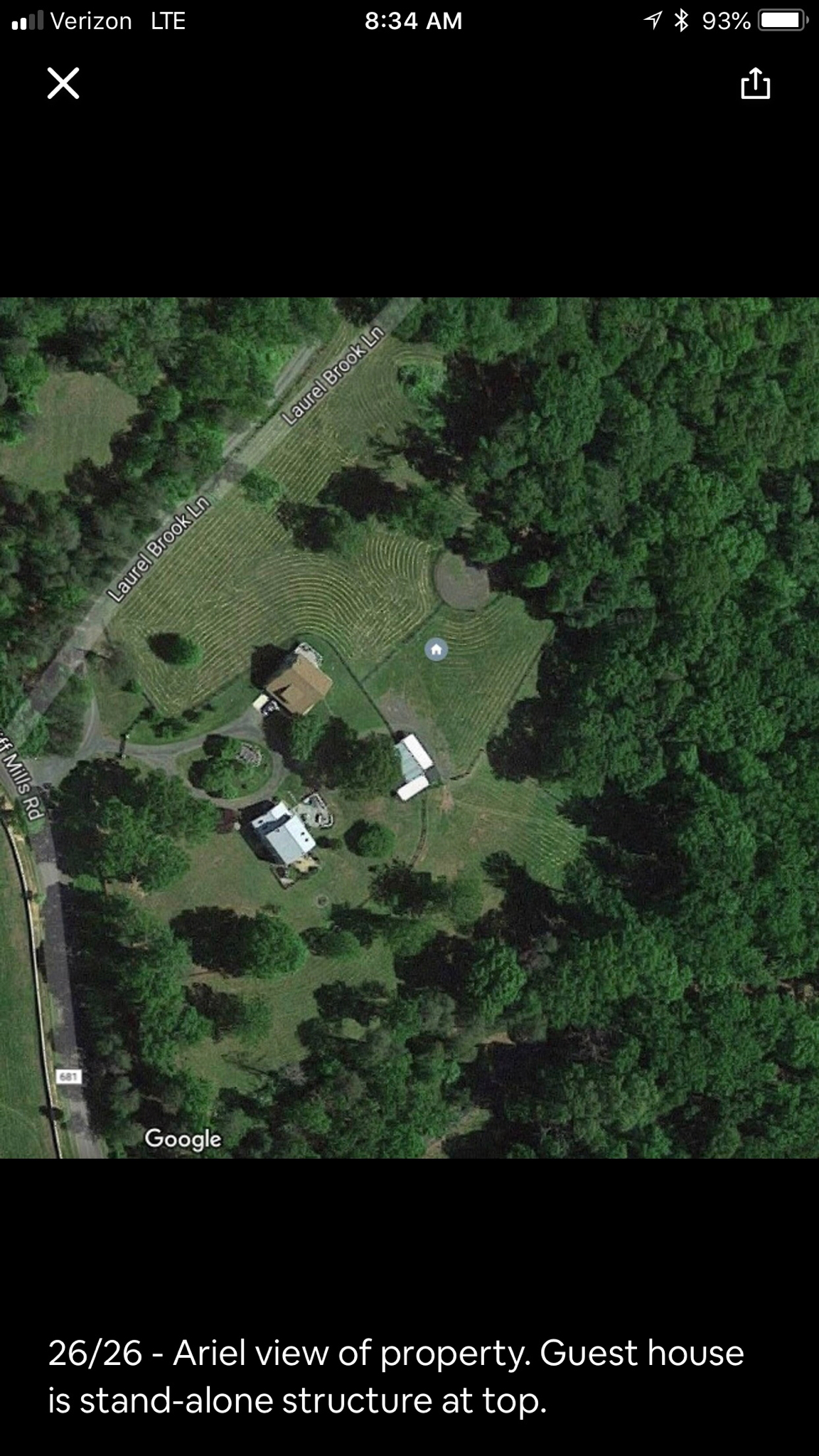

Thanks for all the recommendations folks! I’d say our property is mostly tamed but it’s a constant work in progress to prevent nature from completely taking over. Don’t get me wrong, I love nature, but we just need to maintain healthy boundaries, like a good relationship.
I’m definitely leaning more towards the cab version but the brawn of a larger rops tractor always has its appeal.
Ariel view of the eight acre property.....

I'm torn between two tractor options for my eight acres in Virginia; a 3000lb cab tractor or a 3500lb ROPS tractor (bare tractor weights). I have a personal preference for Japanese tractors with a name on it that is the actual company that built it, so that leaves me with Kubota or Yanmar.
Specifically, the Kubota L3560 ROPS or the Yanmar YT235 Cab, they both cost the same and are at the top of my budget ($27K). I'm going to have to buy about $6K worth of implements on top the cost of the tractor. I have two Kubota dealers and two Yanmar dealers nearby.
The tractor will be used to maintain my mostly flat property with some gentle slopes; no new construction or land clearing required; there is one steep hill on our gravel driveway. Most of the property is open and there will be little woods work except there are about a dozen dead trees around the perimeter that need to be taken down and removed.
