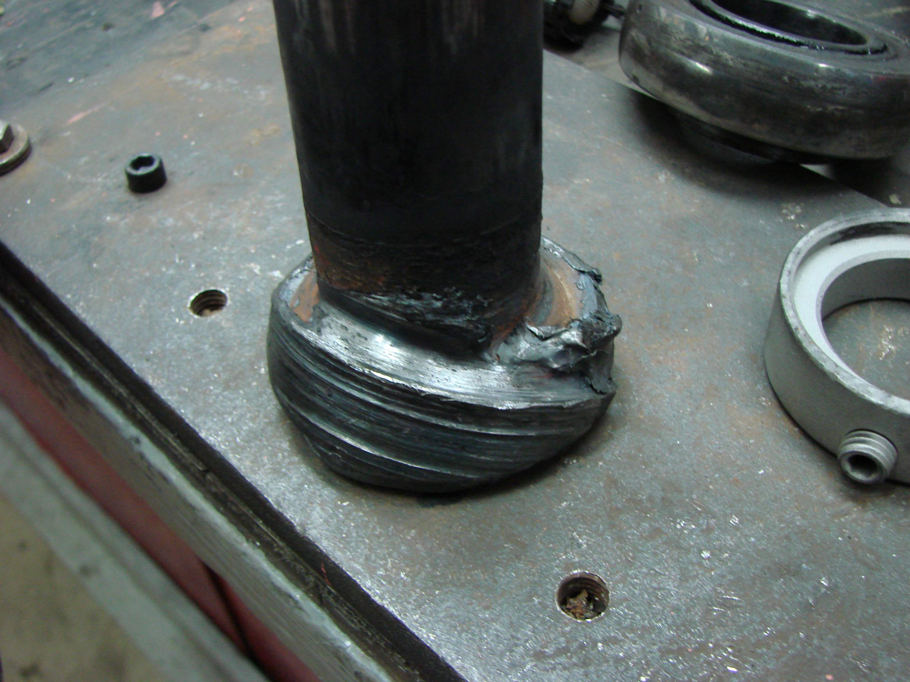

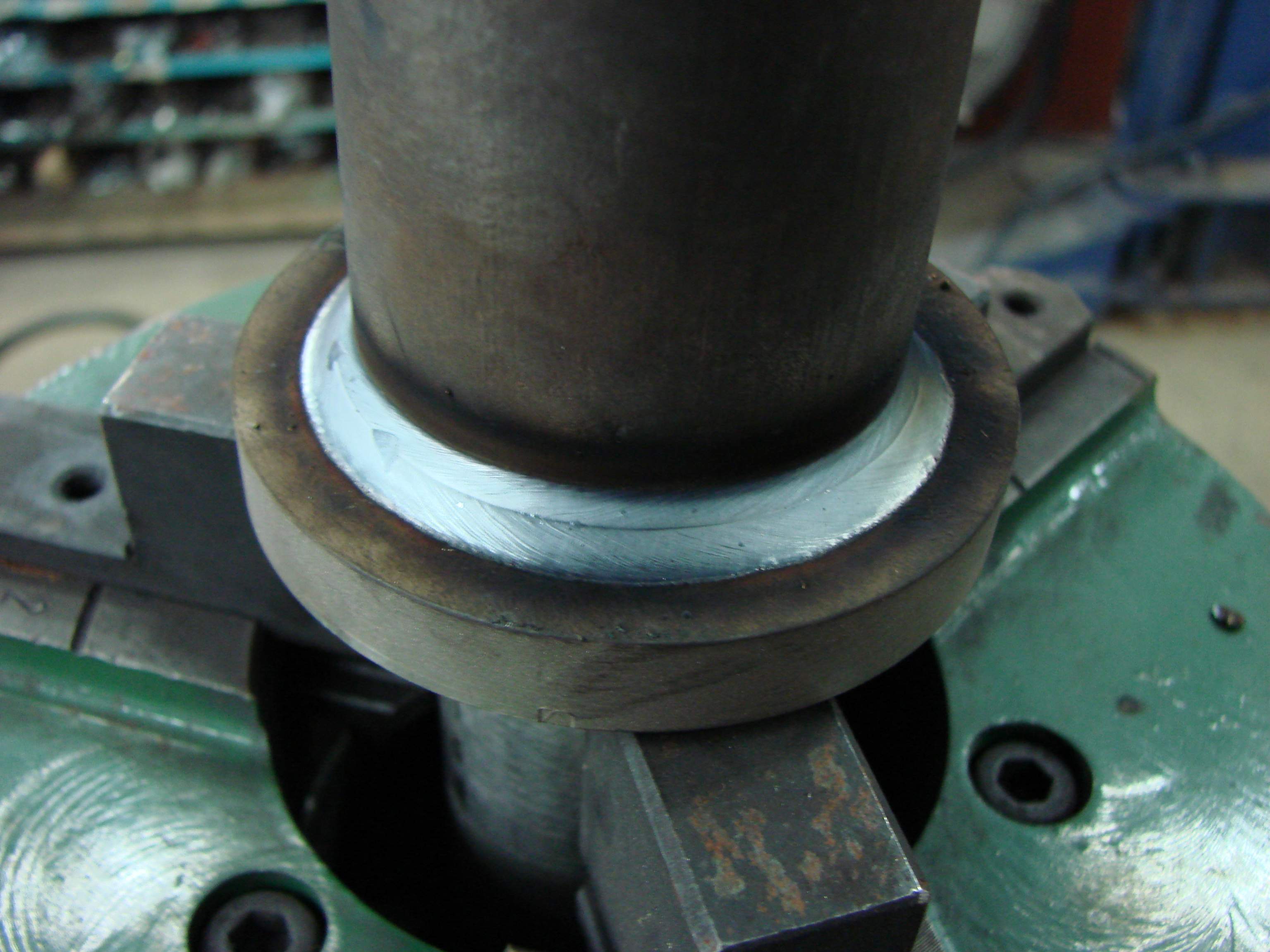

Today we had a customer come in the shop dragging a 6 foot roller asking if I could repair it and right away. Seeing he is one of our best customers I said sure and dropped what I was doing and started in at it.

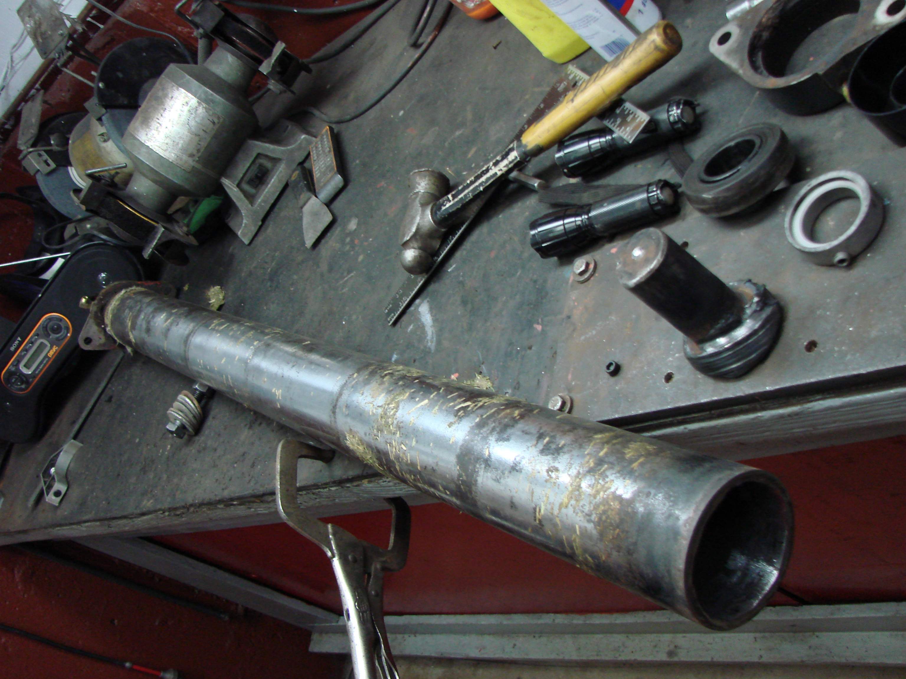

The end piece was completely off and it looked as if something jammed it up because it was blue with heat. The bearing didn't seize so it must have been something else that I wasn't sure of.
Problem number one was, My lathe was to short to swing this thing so I used a die grinder with a carbide rasp and removed the old welding on the side of the roller.

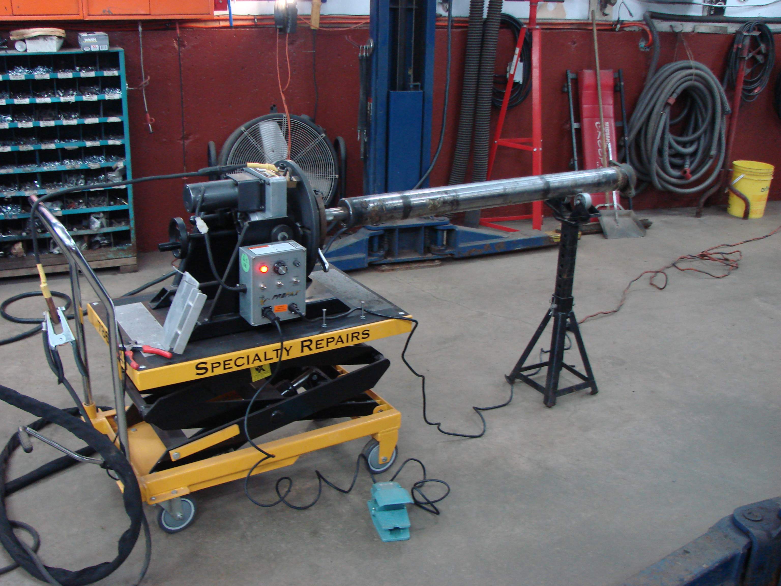

Problem number two was. How am I going to get the new shaft welded straight coming out from that pipe without a lathe? Well I got a brain fart and came up with what you see below.

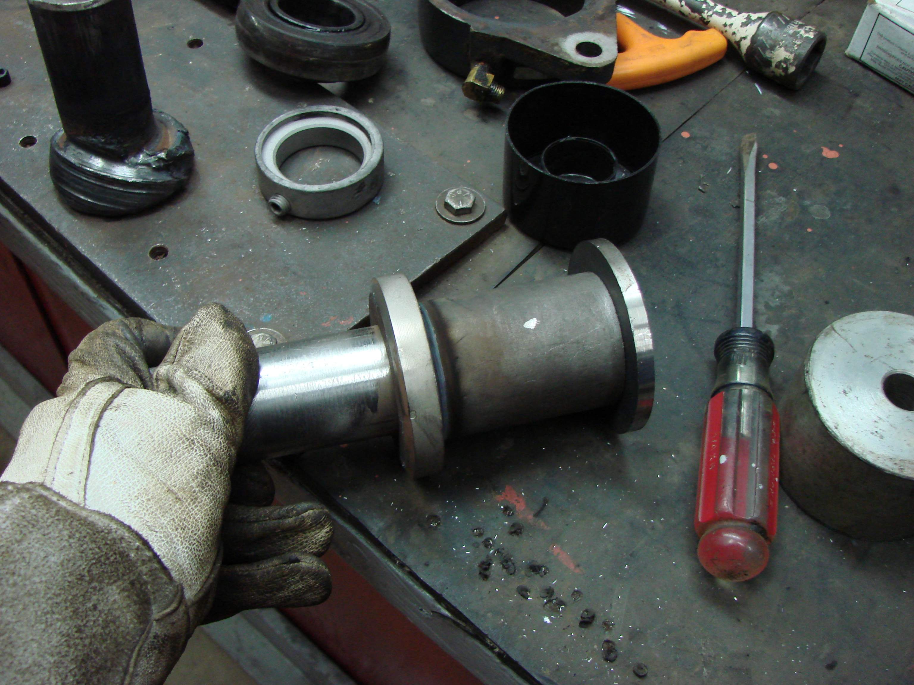

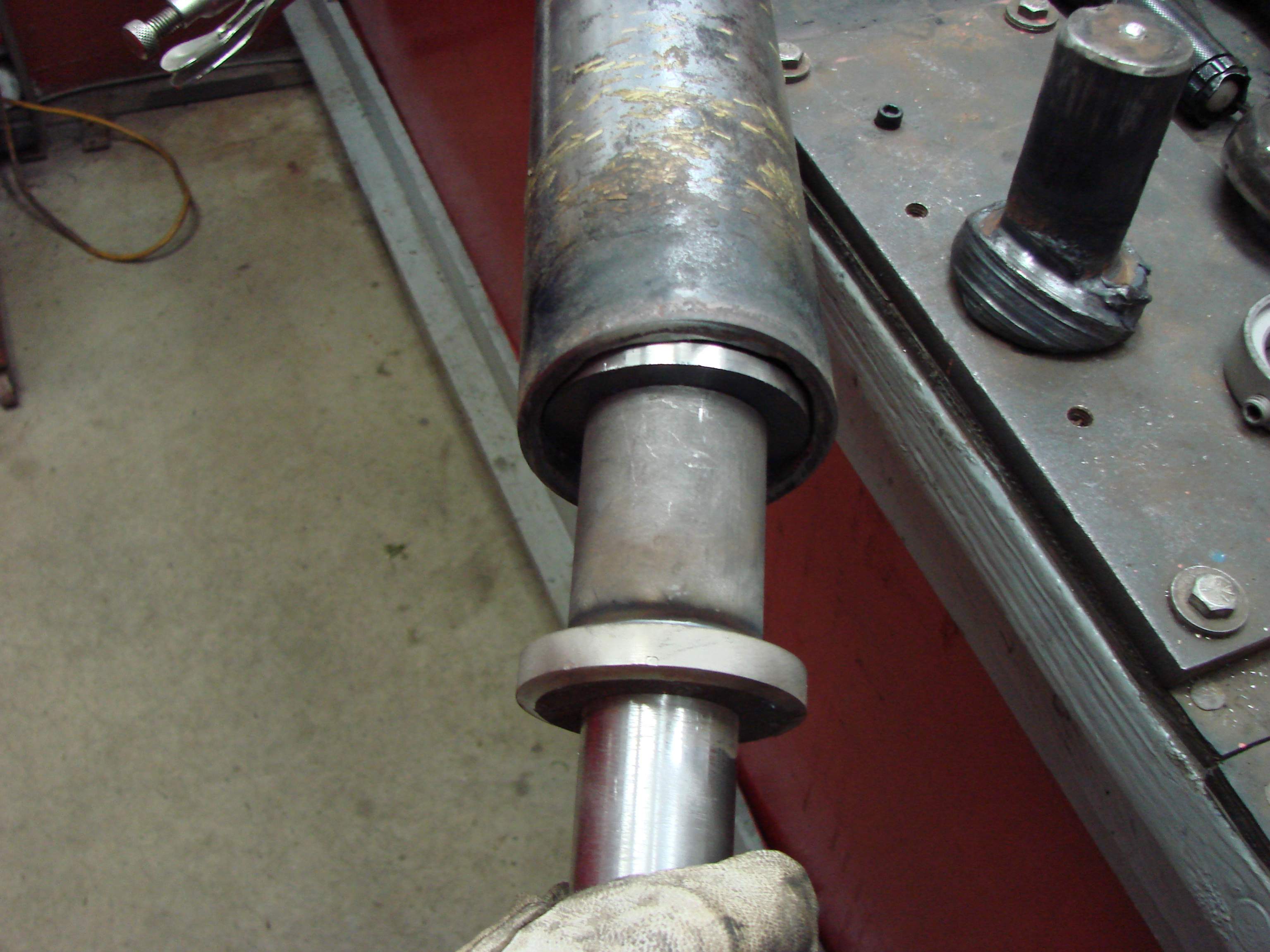

I made the new shaft on the lathe. Then I machined two large washers. The inside one was 1/4" thick and the outside one was 1/2 " thick. Once I had all the machining done I put the machined items in the welding postioner and used the Millermatic 350P:cool2: on pulse for most of the welding.

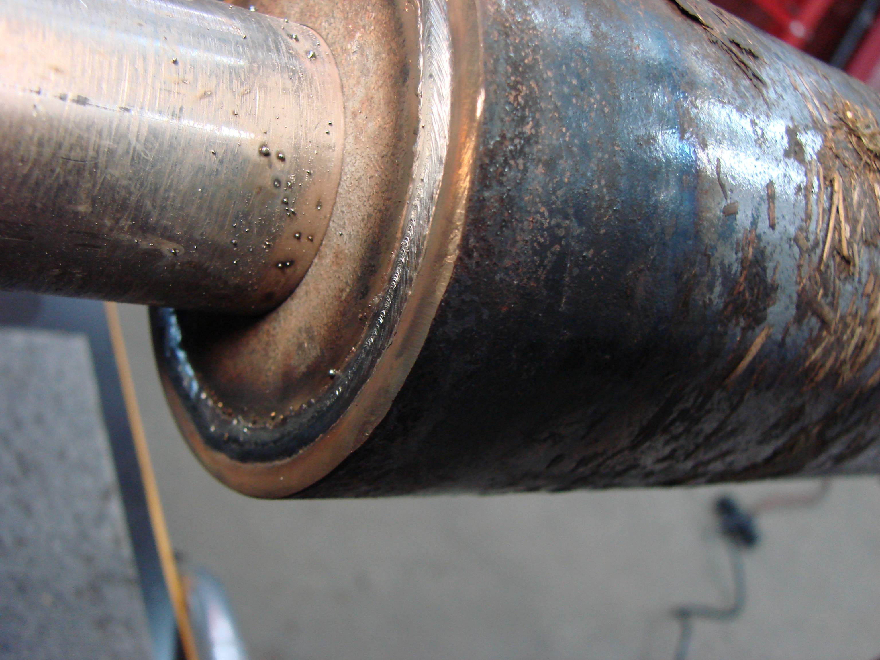

I then took the part and fit it tightly into the pipe and welded it again. It took all morning to do it but the customer was sure pleased when he came back to pick it up.
I know. It's boring but I just wanted to post something :eek::laughing:

Seems a shame hide two of those beautiful welds inside the roller!
/ Small roller repair
Thanks Farmer. It's funny you said that because someone else said that in the shop today. Hum. Might be something to it :). Thanks again for your post.

I don't weld well enough to ever show it on TBN but if photo #5 is normal for you; YOUR THE MAN!
MarkV
Mark we all have our weakness's and posting this stuff is just another way of learning how we do it. As with everything, practice makes perfect buddy. I may be doing this all wrong as well but it works for me and my customer.

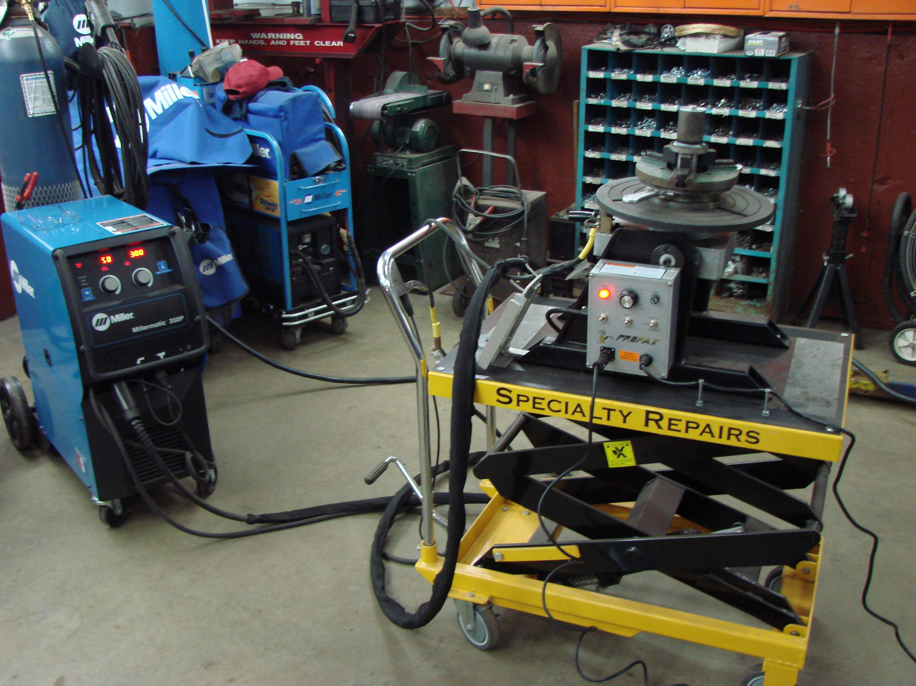

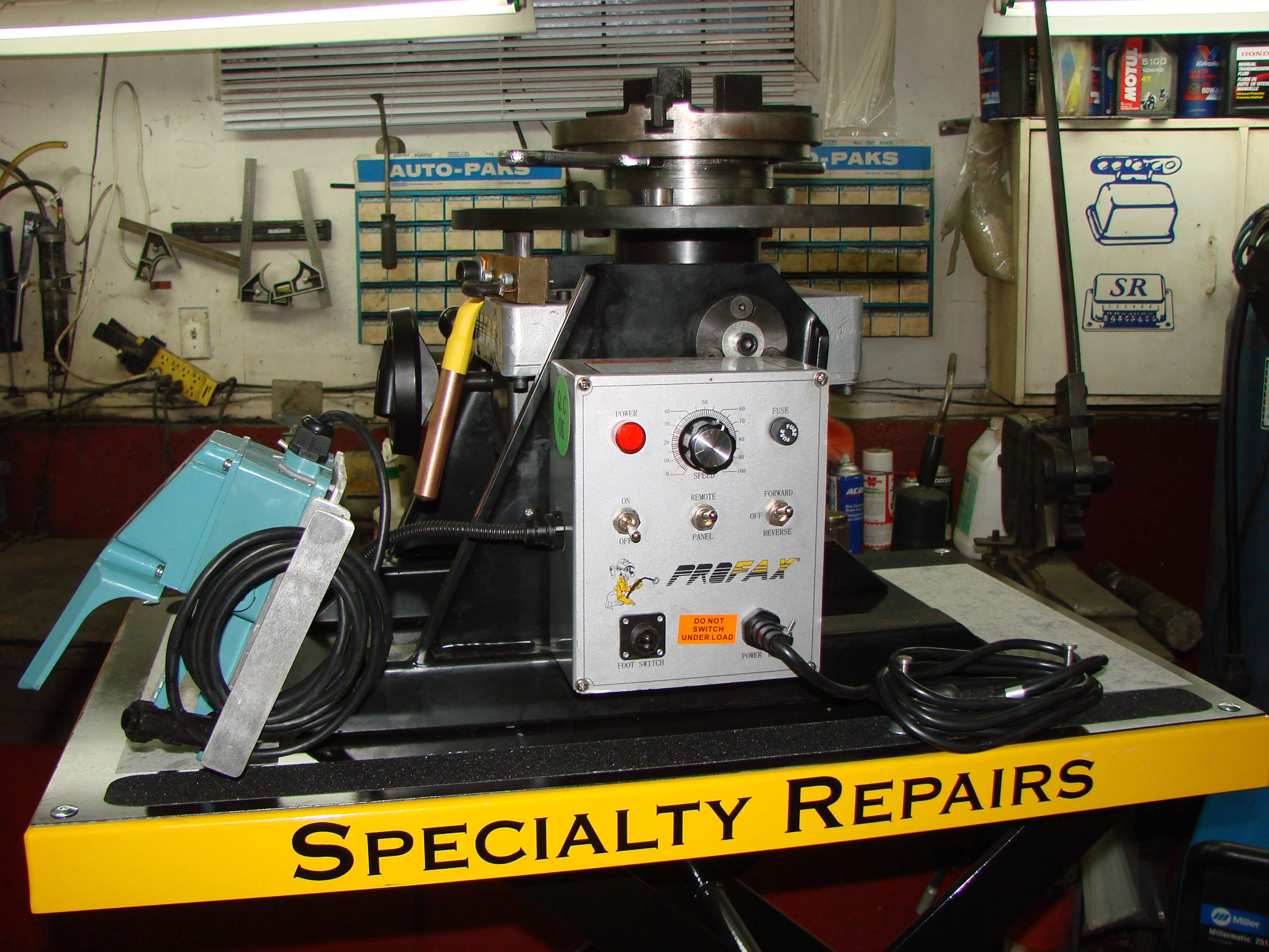

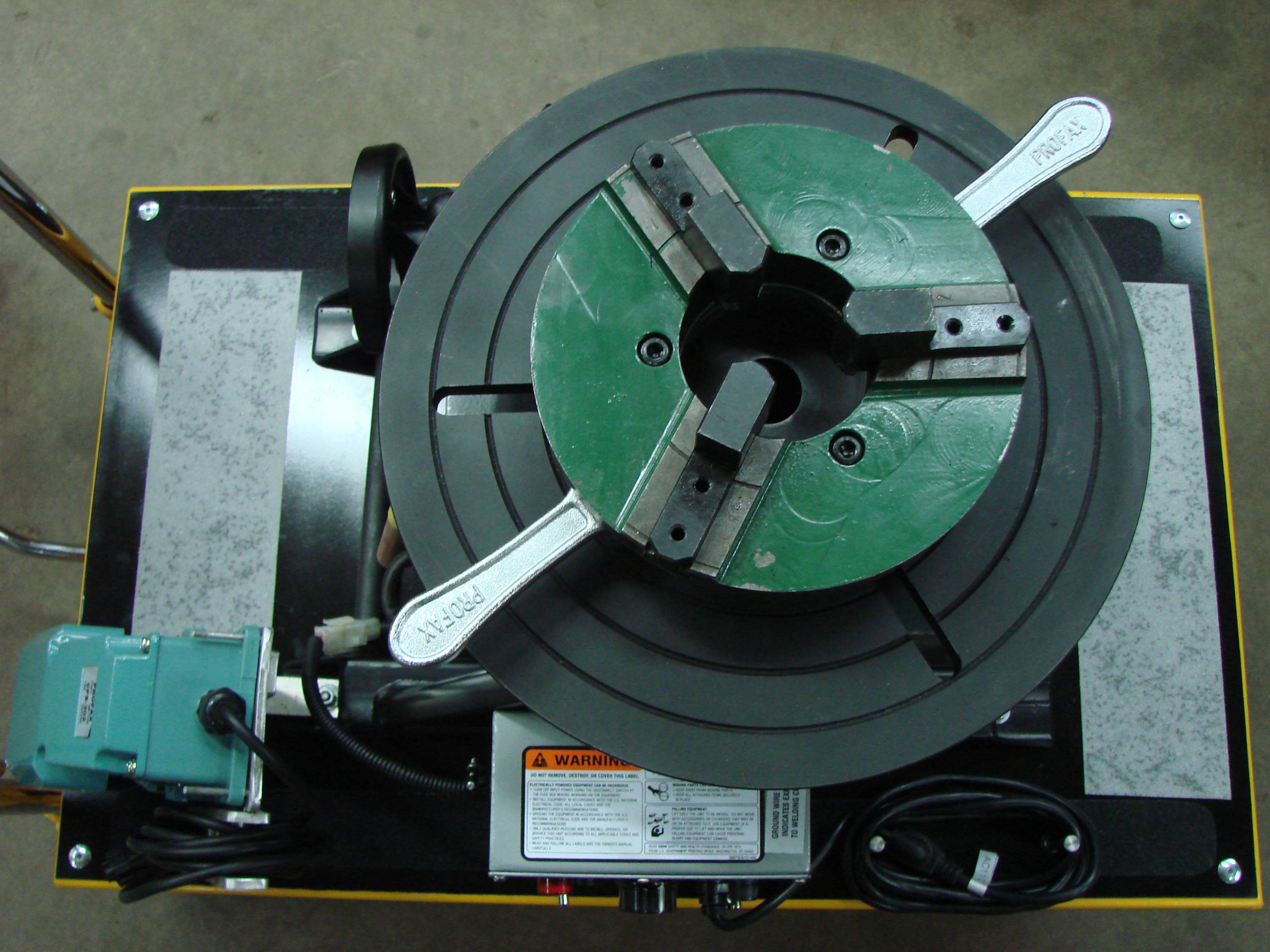

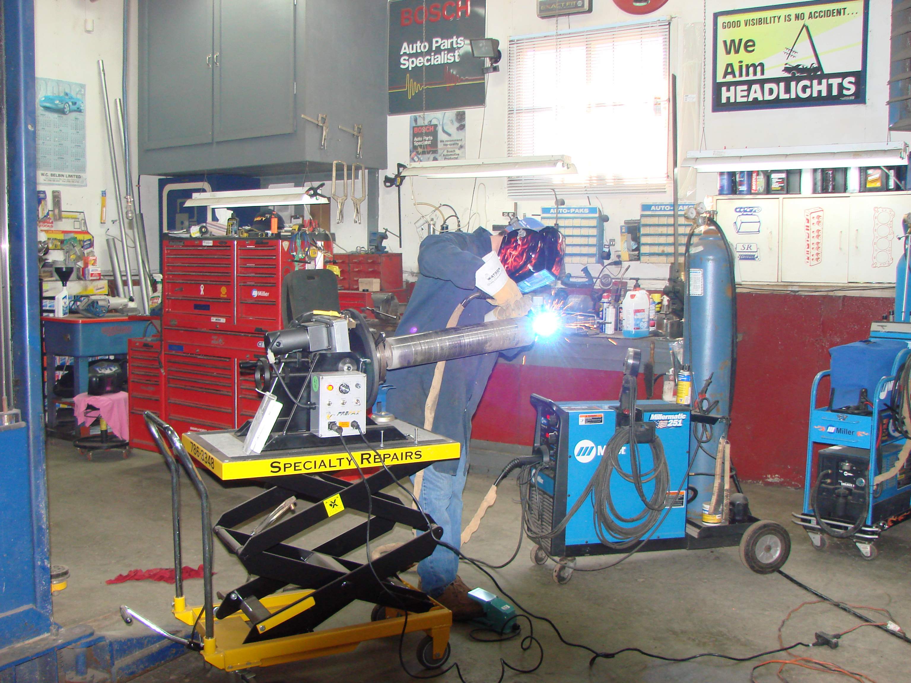

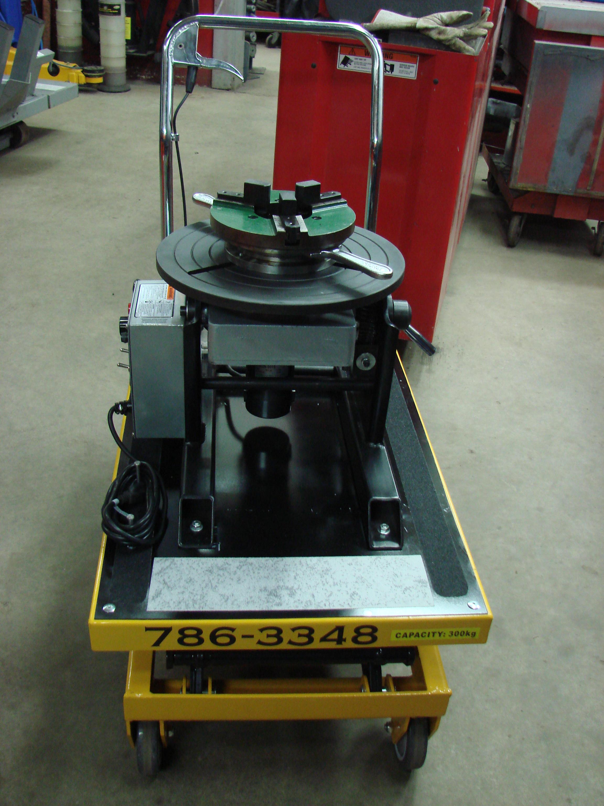

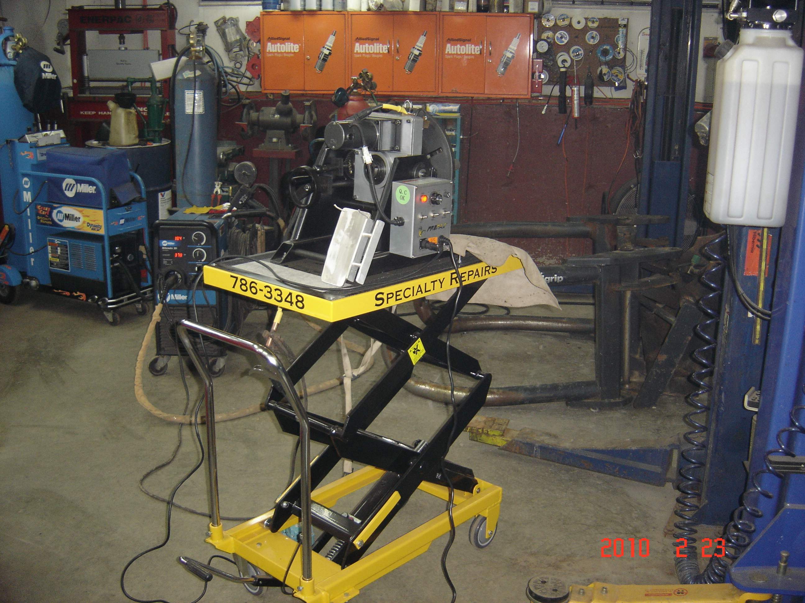

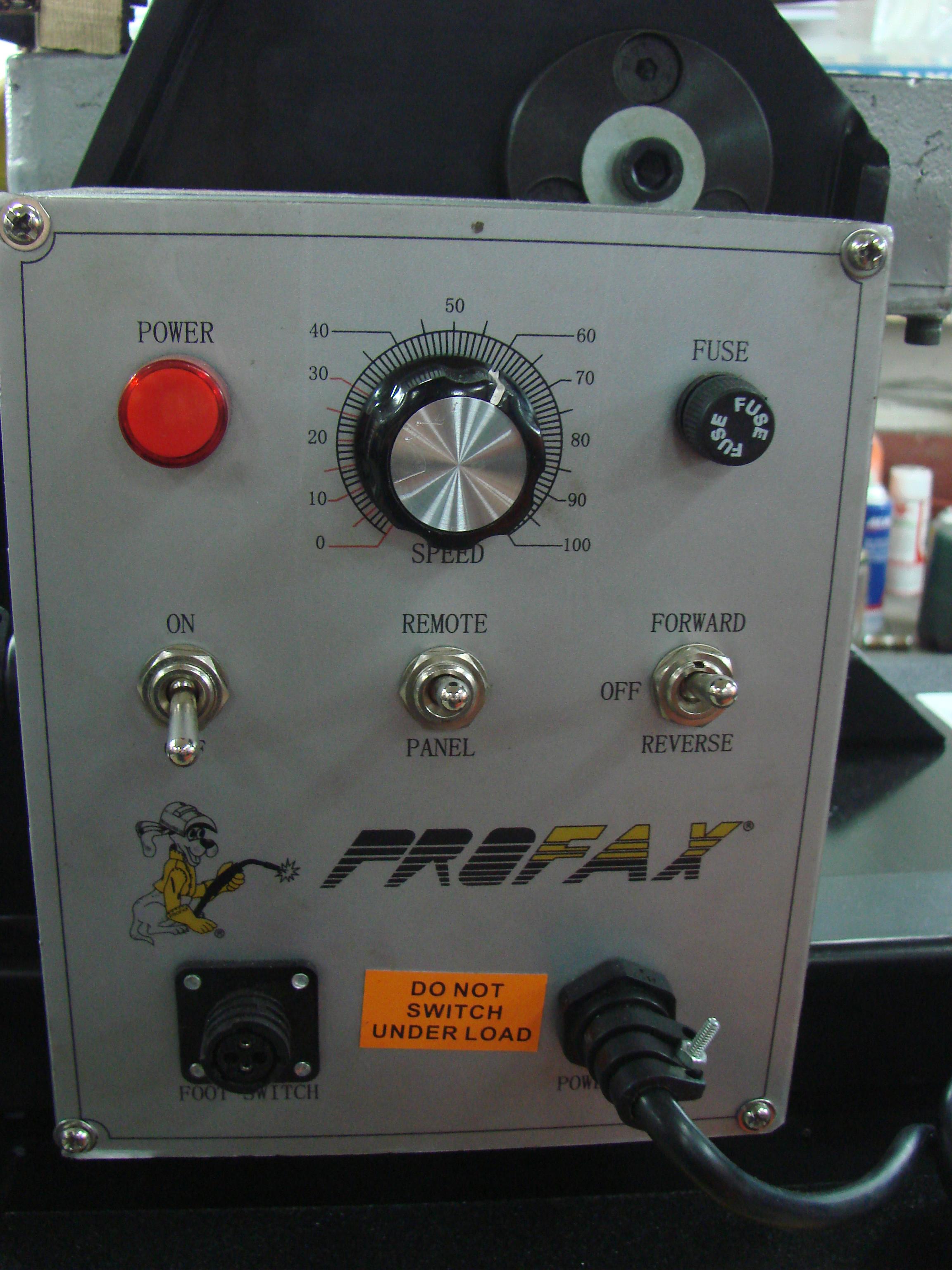

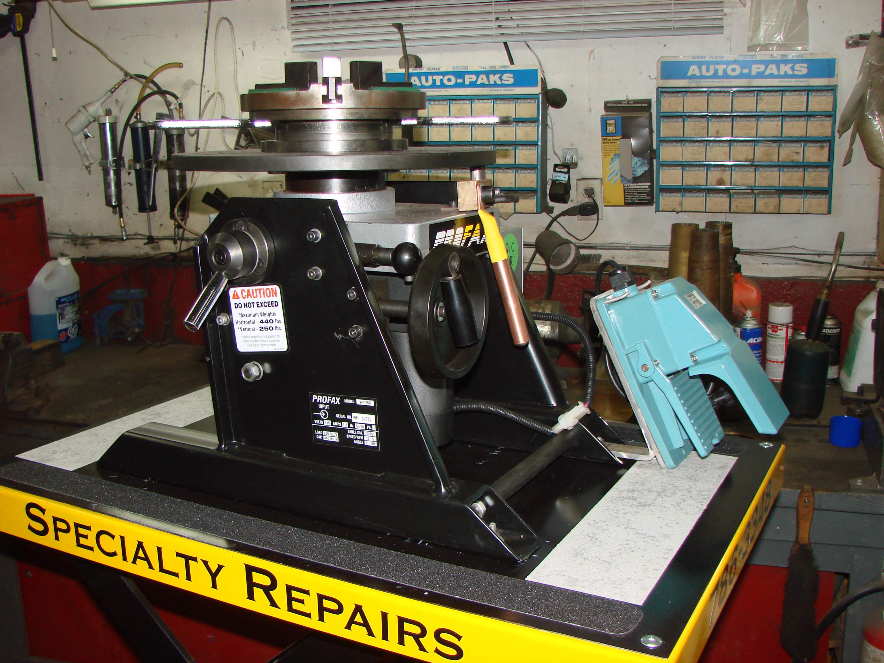

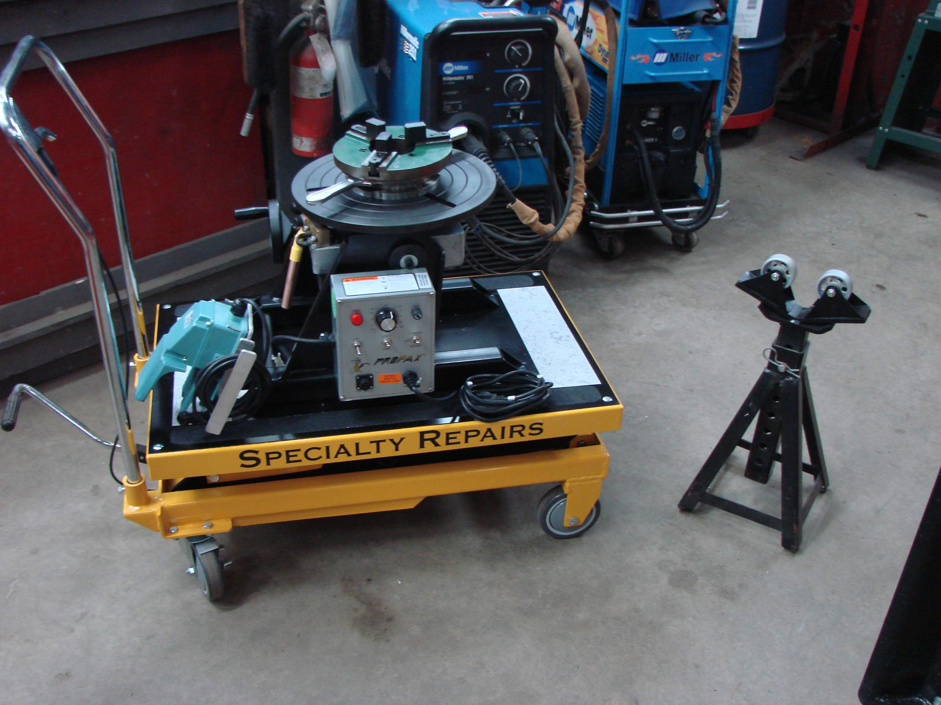

I liked the powered rotator for welding. I do it the old fashioned way, I roll the piece and that is nasty chasing a pipe across the bench.
Craig Clayton
#16
Those are nice welds!:thumbsup::thumbsup::thumbsup:
Thank you my buddy!
Craig Clayton
:laughing: I could see that being a problem alright. I used to use different ways as well but I bought the positioner and placed it on an adjustable hydraulic table and now it's heaven to use. Makes my bad welding look good :laughing: Here's a few more pics of the positioner. Thanks for posting

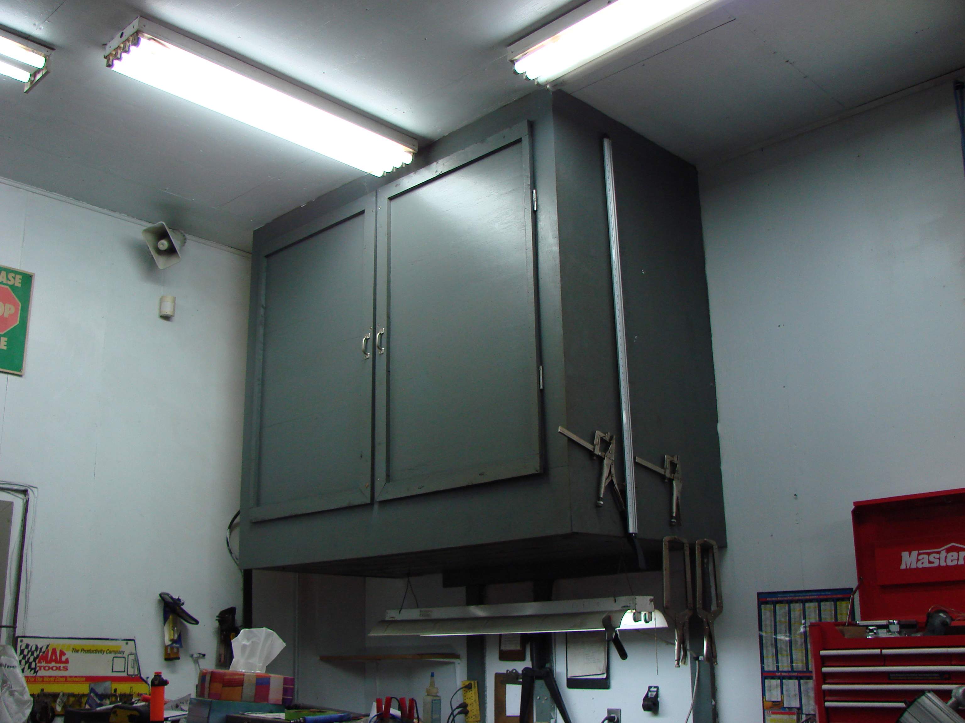

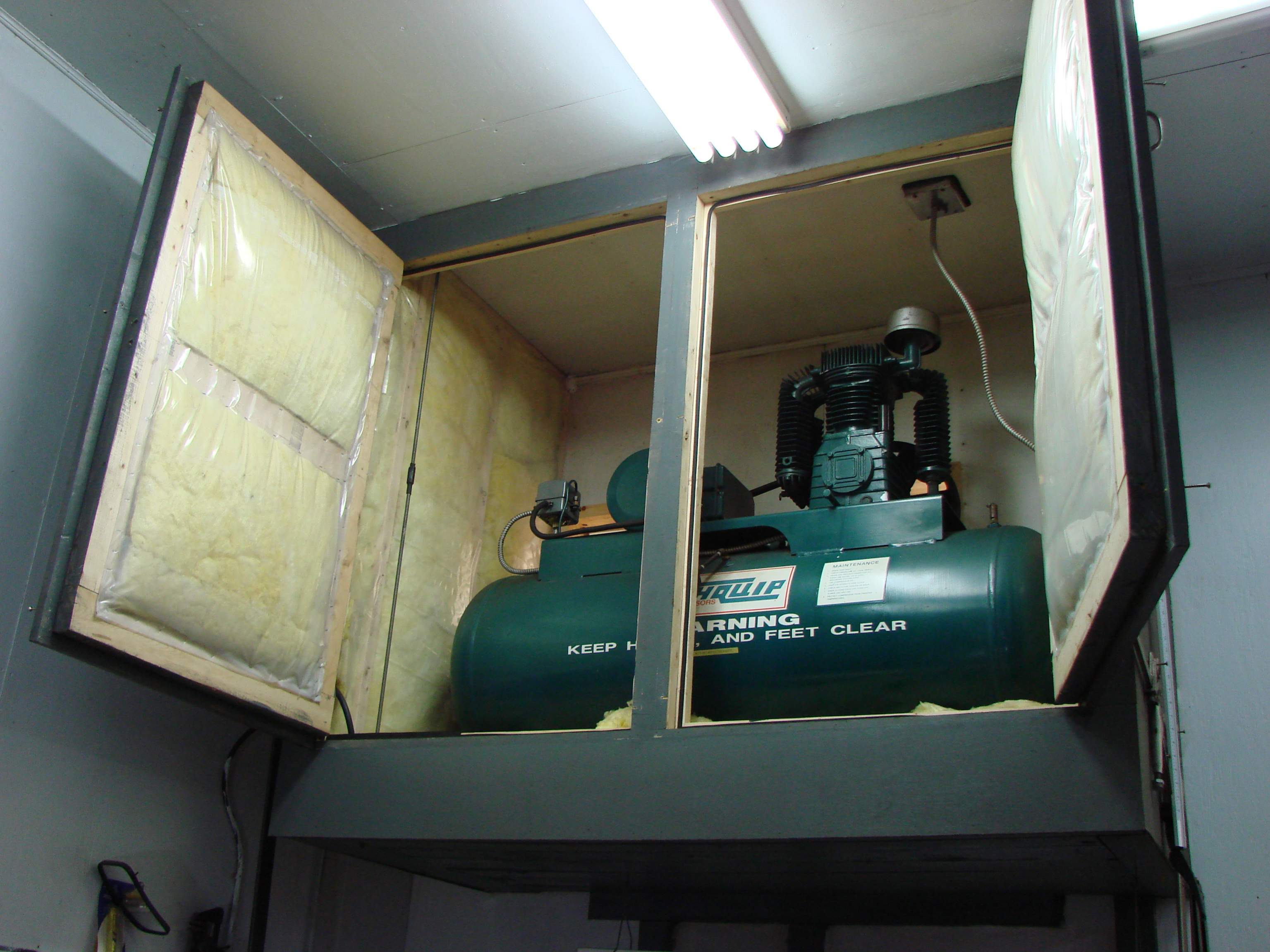

Paul- what is in that giant gray cabinet in the upper left of your last picture? Maybe a guest room?
Anyway, I don't see how those circular welds could have been any better! Not to be rude, since you elected not to share costs with us, but would you give us some idea about what your regular shop rates for fabrication work might be... As folks who sometimes pay for outside work, many of us are really curious what the "best" costs. I'd guess $100/hour would be reasonable, but perhaps I am off base and behind the times? Please don't take this question so much as a personal intrusion, but a teaching opportunity! Shops like yours are accessible to the average guy when absolutely needed, although pretty rare to find!
That room is a compressor room. I put the beast up there to have it out of my way and then built an insulated room around it. I put doors on it so it would be easier to service and it takes it's air from vents on the rear of the building. It's much quieter this way. I snapped a few photo's of it for your entertainment.
