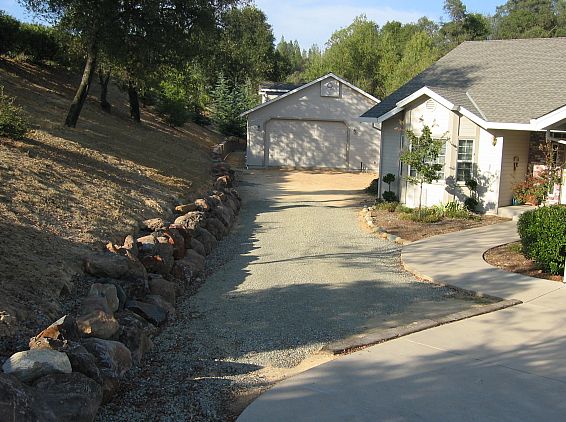

I built a long 3' wall, one part with block and the other part with stacked boulders. The block for alongside the shop, the boulders in front of the house.
The attached pix shows how the Keystone interlocking blocks go together. It was a fairly straight forward project. As noted by the previous posters, just follow the manufacturer's on-line guides.

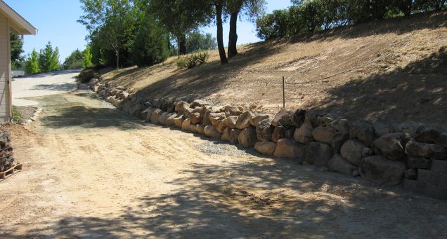

/ Small Retaining Wall question #7
The boulder wall was merged with the block wall. You can just see the merge here. This shows the general order of the stacked boulders. The pipe sticking up is for irrigation of the hillside--needs to be cut and boxed.

/ Small Retaining Wall question #8
Five months later here is the almost finished project--concrete work is still waiting. The wall protects the driveway going to the new shop.

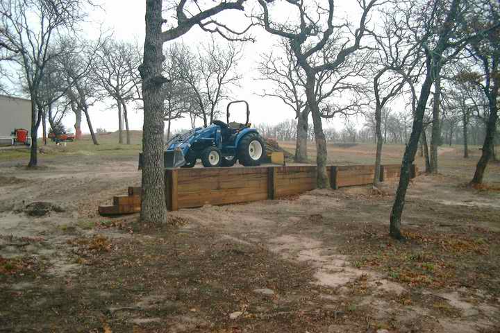

/ Small Retaining Wall question #9
Ron, I agree with everyone that stone or some type of masonry retaining wall is much more attractive and will last much longer if installed properly.
If your friend is sure he wants railroad ties or something similar, maybe he can find a better type of material that will have a lot of the properties of ties, but last a lot longer. There is a sawmill close to me that buys old telephone poles and then cuts perfect 6"x6" timbers. These are easily cut with a chainsaw and they stack perfectly. They are much easier to work with than railroad ties and don't have nearly as much toxic creosote in them.
I'm attaching a couple of pictures of my wall. the first is in progress and the second is complete. The cost of these timbers was $1.25 per linear ft. You might be able to find someone in your area who does the same thing.

Jinman, I don't want to sound negative, but the fellow I bought my property from used those same type of timbers for fence posts, and they only lasted a few years, much less time then normal fence posts. I have had to replace several already ( in 2 years ), they rot off below ground level.
I think when they trim the telephone/utility poles down to 6x6 they cut a lot of the preservative soaked wood off.
I hope you have better luck!
