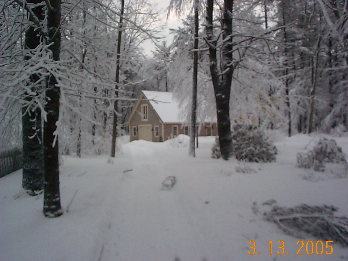

I built this 24x36 with 12/12 pitch and full second floor open. 2x10 rafters 16" OC and 18" floor trusses so no poles on the ground floor.
I used full 2x6 rough pine for the wall and gable framing, and 1" rough pine sheathing EXCEPT on the end walls the engineer and town made me use 5/8 plywood (they couldnt calculate shear factor of 1x pine) to eliminate the domino effect.
Also under the 2x12 ridge beam we tied each rafter together with a 4' long 1x6. One thing I learned is NOT to put a access door on the front side - put it on the gable end - the snow makes a BIG pile in the winter.
Good luck.

/ Small Pole Building Question #9
Good luck.
Carl
excellent point. I made that mistake on mine. But really no other way around it
