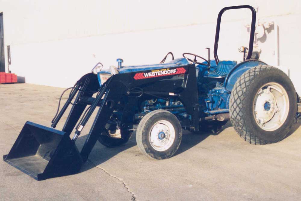

Your comments are correct. For the best performance out of a loader on that tractor model, you'd want to look for a unit with smaller cylinders for increased loader speeds. You indicated light general use, so a 1600# lift capacity (2" cylinders) should be fine for anything you need to do. If you go to a 2 1/2" cylinder you'll get closer to 3000# lift capacity, just slower.
If you will be taking it off and on frequently, you need to view the power-mount video online. Lets you dismount or mount in 2 minutes or less without any tools or stands. It can be dismounted in the grass, pretty much anywhere, doesn't have to be on concrete. http://www.loaders.com/userdocs/products/02_WindowsMedia_-_Low_Bandwidth.wmv
I sounds like there was some variance in size of hydraulic pumps on this model, you'll want to measure gpm. The smaller loader comes with the valve, joystick and plumbing kit for installation. It is an option on larger units. Westendorf is Made in the USA, Iowa to be specific.

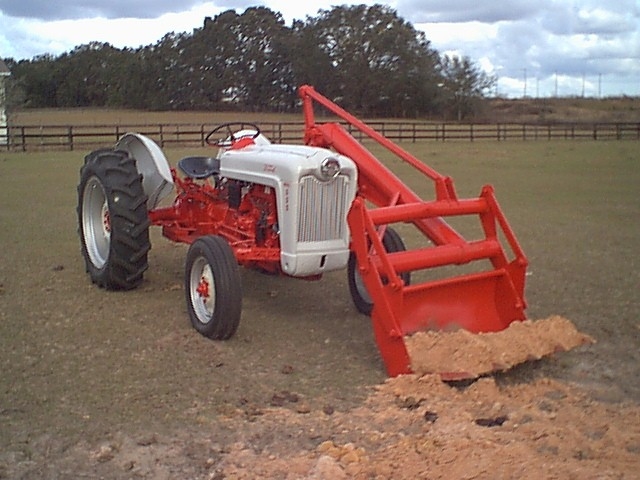

Locate a ford 711 or ford 722 1-arm loader and bracket kit. Be aware thatt he ford 711/722 were made in 2 versions.. ones for the 3 cyl, and ones for the 4 cyl tractors. The big difference is the box that the brackets pin to onthe laoder frame.. the 4 cyl box is 5" long from edge to mount post, the 3 cyl boxes are 3.5" from edge to mount post.
They will break out 3000# and lift 1200#... Have a SA lift cyl, and a DA bucket cyl, though you can find them with a trip bucket and a SA lift cyl.
If you want a quick detach loader, then power it from tractor hyds. You can buy a dual valve kit for the tractor hyd top cover for about 700$.. it will have (2) DA ports on it, and one of them can be set to operate as SA/fast drop.. this works great for the 1-arm loader. Put QD's onthe valve hose stubs, so that way you have use of 2-remotes when the laoder is not on.
Loader has 3 brackets... small one under the tranny, one on the bellhousing, and one under the front axle. the front axle, and the under tranny one could be torched out of 3/8 and 1/2" plate if need be. The 'hip' bellhousing bracket will be harder to find.. but you see them on ebay... must look for the 3-cyl model though..
unit can be installed in 10 minutes or less.
Trip loader is even easier / cheaper... you remove the test plug from t he hyd cover option port and plumb a hose from there to the SA lift cyl... then chain your upper lift arms to the axles, and use the 3pt lift control to raise / lower the loader..
here's a pic of my ford 660 with 722 loader

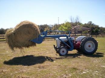

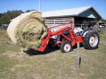

I've got 3 of those loaders now... The 1955 ford 660 you saw has the 722, I also have a near identical looking ford 1955 850 with a 711 1-arm laoder with a dirt bucket.. the 660 has the maneur bucket.
I also have just picked up a ford 951 trike ( 1958 ) and the pieces to a 711 trip loader that i will assemble all together when i get the tractor refurbished.
I like those loaders... they were made to work on the 4 and 3 cyls fords.. and will handle anything the tractor wants to handle.
Here isa pic of me moving hay round bales on my 660 and 850... ain't nuttin' weak about them. 850 has wide 4-rib tires and handled it good.. the 660 has narrow 3-rib tires and they sunk into the pasture and left inverted 'railroad' tracks over to the cow pen.. thus i only move hay with the 850 now ;)
