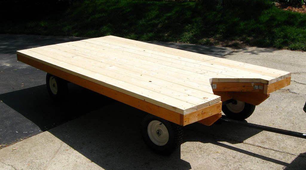

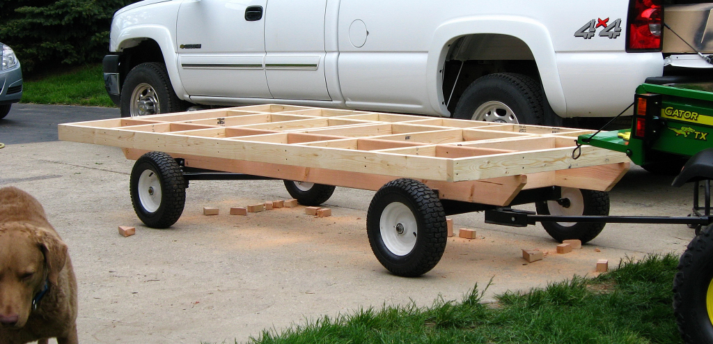

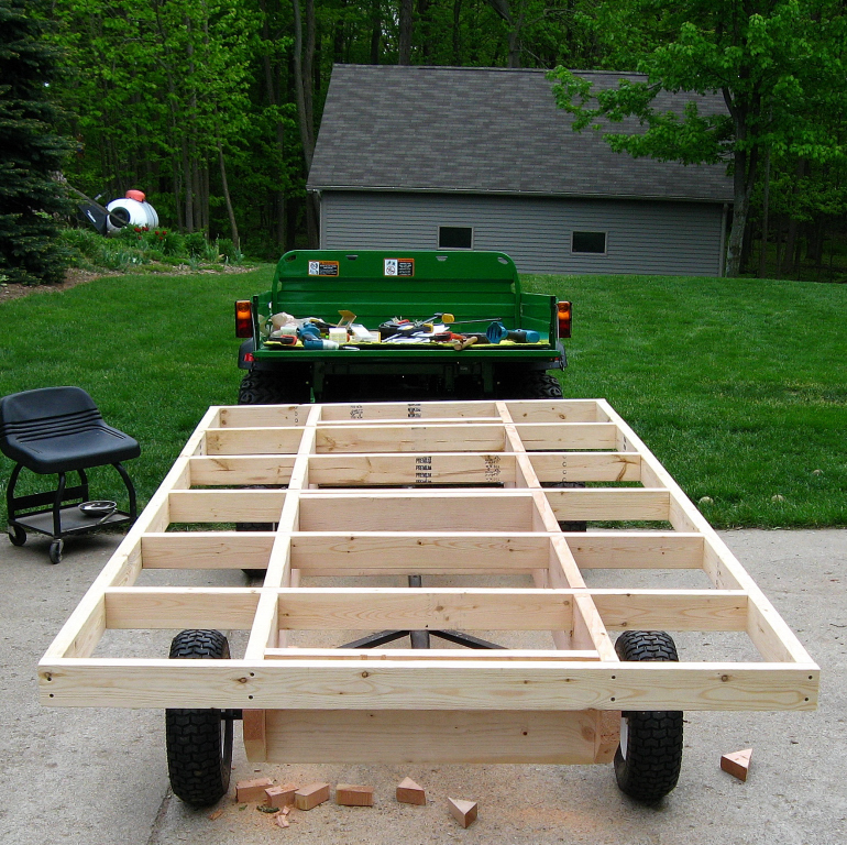

I purchased the running gear from NorthernTool.com and completed the sub-frame & deck last weekend. Hope to have the sides on soon. Anyone have a source for stake pockets that fit a standard 2"x4"? It will be used mostly for moving firewood from truck to splitter to the seasoning rack to the ready-to-burn rack.

Wagon looks great! What gear exactly did you get from Northern as the base for it? I want to make one, too!!! Be sure to post pictures of your final wagon so we can all admire it. ;)

Very nice little set-up for behind the Gator and looks very well built. 2x4 decking is substantial and should be excellent for hauling firewood. A hay wagon only needs rough 1" or 5/4" finished stock.
I do hope you are going to stain and seal the wood to keep it looking nice for a long time to come. Stain is nice because it never peels or chips and never has to be scraped before apply a fresh coat. Please post more pictures when completed!
I had Home Depot custom mixed a solid green Behr stain that weathers to look like antique JD Green. Maybe they could custom mix modern JD green. When I get my JD hay wagon stained I will post pictures.

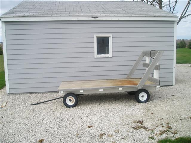

Now I have to ask... In the first two pictures you have a straight front. In the third you have a "V" over the hitch. Why did you modify? Just curious...

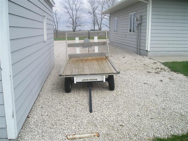

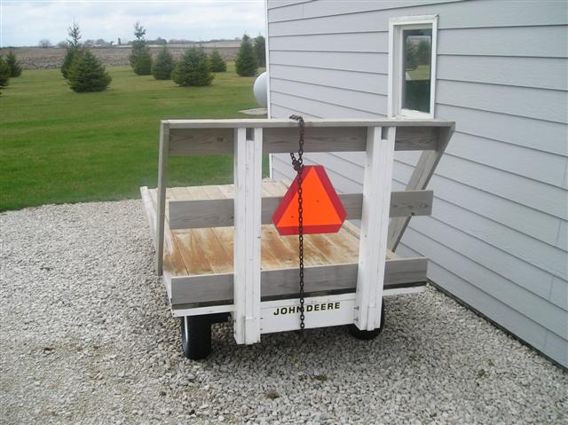

Hey bigtiller... tell me about the structure on the back of your hay rack. What's it for... just something to slide the bales against as you are stacking on the trailer or is there something more to it than that (does the trailer tip somehow or something?)
