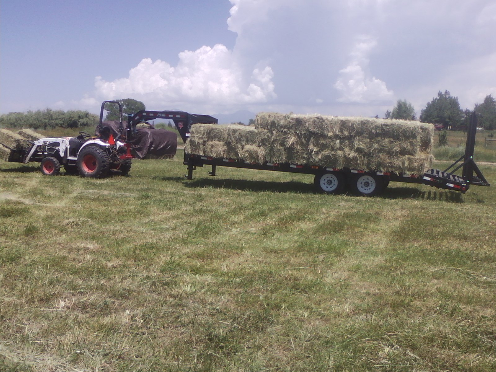

I thought I would update this thread. This is the unit I got attached to my tractor.
Between yesterday and today it handled 298 bales twice (load and unload) I had also stacked and covered 100 bales in the field in case of rain. I only had to manhandle one bale that a string brook on. The unit is the perfect size that I can see around in stacking. This is a view from the drivers seat.
The unit will handle 4 bales either way for good stacking. After a while you can get pretty quick of sweeping in and grabbing a bale and moving to the next. The repeated engagement and release of the hooks and re engagement at each pick up does not damage the bale. For my tractor it is the perfect size to run without counter balance, but I do have filled tires.
This is a shot (below) of my 23' goose neck I haul on. I have gone 3 high with a 4th level centered without problem (I now have a deck to level out the drop tail) . I have a Titan 3pt goose neck hitch on the tractor.
All I can say was this was the best money I have spent yet (besides the inline baler) for my business. Hope this helps others.
For folks wondering it the 205 Compact Bale Grabber from thees great folks, Specialty Grabbers My next investment might be this 8 Bale Flat | Kuhns Mfg LLC I just need to figure out if I can handle it or find and alternative.

I'm very impressed with this. It would be awesome to see a video! So what is total weight of grabber and 4 bales?
I have seen accumulator grabbers that skid the bales across the ground. Seems like this could damage the bales. Sounds like you engage and disengage hooks at every bale pick. Never damages bales? Thanks for sharing!

Here are the grabber specifications.
Picks up 5 bales on edge
Ideal for compact loader tractors
Compatible with the 10 bale edge and 15 bale edge arrangements
205 Working Dimensions: 36”L x 72”W
205 Shipping Dimensions: 42”L x 72”W x 22”H
205 Weight: 340 lbs
Requires:
Loader with at least 750 lb lift capacity*
One set of remotes
*Lift capacity is an estimate based on an average bale weight of 40-50 pounds. However, it is up to the individual to determine their specific loader requirements.
I have an extra set of hooks so say 350 lbs for the unit and 4 bales at 75 each makes a total of 650 lbs. I can lift and move this weight without needing rear ballast.
Yes I do engage and disengage usually for each bale, but can sometimes swing into two or three before hooking up. Over several thousand bales moved, I have broken two strings - my fault though as you can set the hook spacing to miss the strings. If it happens I stay engaged and just retie with a bit of extra twine. You do not want one of those units that skid across the ground as you cant unload easily and cant pick up and load out of the stack. Also there are some grapples out there without the removable side bar - you do need this.
