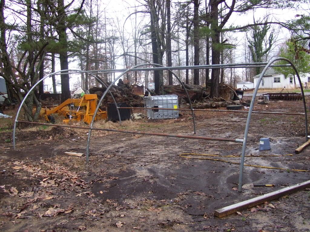

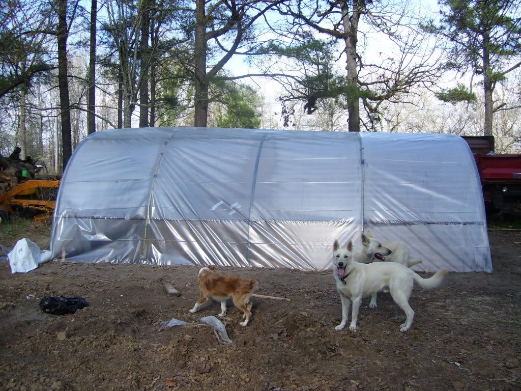

I made mine out of 1 and a half 13 foot trampoline frames. I took some fence top rails and used a 1.750 hole saw and cut out the center hoops leg pockets to a through hole for the rails to pass through. Then let the leg pockets cap each end. Ive used mine almost 3 years and still I had put my door in it when i t was new but tree fell and knoced it out. i just let the extra fabric cover the door.
Its 13 by 20 and with the Farmtek/Growers supply cover the cost of it all was 155 dollars.
http://i471.photobucket.com/albums/rr78/tumblebugtaylor/005.jpg
http://i471.photobucket.com/albums/rr78/tumblebugtaylor/006.jpg
http://i471.photobucket.com/albums/rr78/tumblebugtaylor/002.jpg
Later I will put it on 4 foot treated posts and use treat lumber around the bottom to make room for my new deigned grow beds with home built wood fired stove and water heater.
