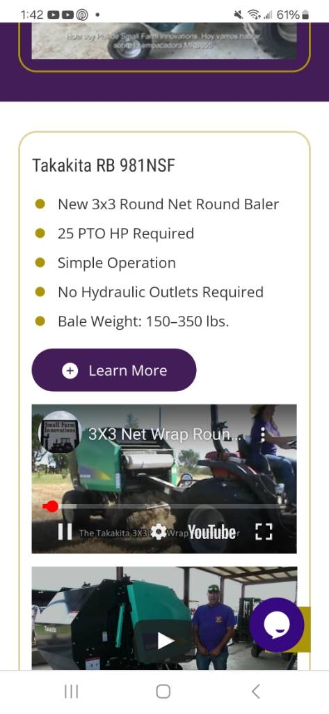

I would go with something a bit bigger, like the 2nd pic, it makes 3x3 net wraps, at 150-300#/round
