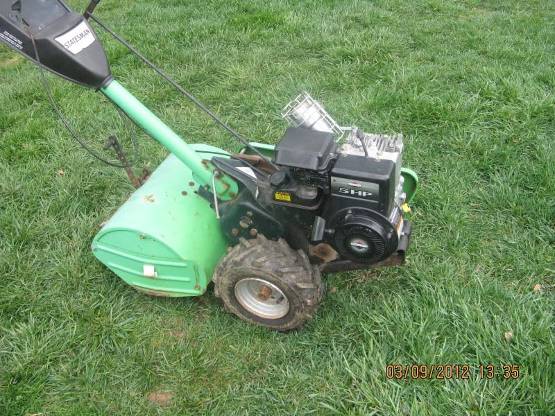

I've got a 5hp briggs on a tiller that seems like it's not getting fuel from the tank. It will run if you put a little in the carb, but dies when that runs out. I just bought the motor used, but it looks like it was hardly ever used. The guy said it had been sitting for a while. I tried seafoam and carb cleaner (maybe not enough). Anyone got any other ideas? Thank you...

Ok, I finally got a chance to fool with it. I took the carb off, hosed everything down with carb cleaner and it runs now. Now that it's running I have no throttle control so it just idles. I have the linkages from the old one I can put on it, but I have no idea how it was put together. Any chance one of you can take a picture of a similar set up? I've looked on google images but couldn't find anything I could use.
Thanks you all very much for your help.
/ Small engine won't keep running #20
I think your engine has a self governing system. On that last picture there's a plate that should rotate, it has a rod and a spring going to it. The rod goes to an air vane that as the engine revs up it closes the throttle (slows it down). The spring should try to open the throttle and speed it up. The screw set the idle speed. The lower lever on the front could be just a kill switch or it could also control the speed by trying to counter act the engine air vane.
With the engine not running and the lower lever pushed all the way to the right (on) that plate on top of the engine should be turned as far clockwise (looking form the top) as it can, throttle wide open. If not you probably have the linkage incorrect. Also since it hasn't ran in some time check to make sure that everything is free and loose. Also if the lower lever does control the speed it could use a spring to counter the force of the air on the vane, check to make sure it feels like it's trying to pull the linkage in a way that will open the throttle. To see the vane you may need to remove the pull starter cover.
