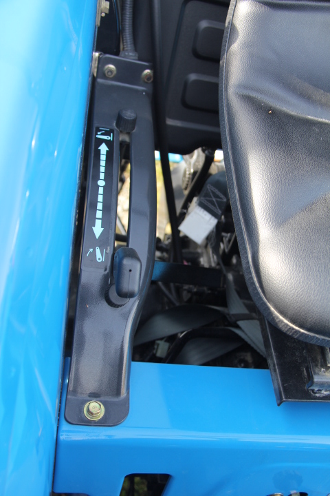

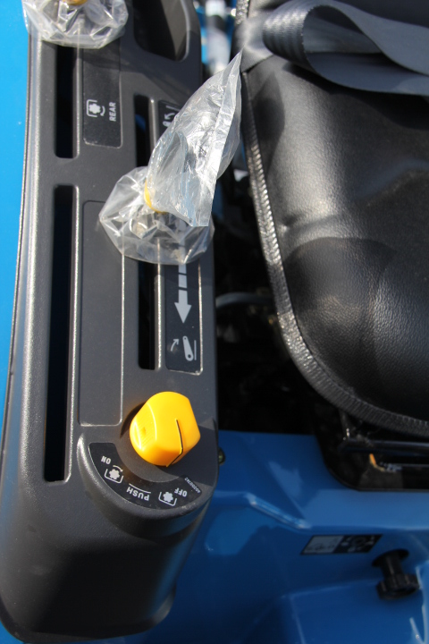

There's no way to rig any kind of position control for the J Series tractors. The 3pt lever works like an auxiliary hydraulic lever. There is no way to rig a stop that I can conceive. It really wasn't that big of a deal to me. I never used position control on my last tractor.
Ok. I'm back with photos of the G3033H position control. This is a manual position control with turn buttons. It mimics the old position control from the Farmall Cub, Super A, etc series of tractors.
First photo is of a G3033H with the manual position knobs. The knobs screw into some sort of threaded flat piece of metal that then locks in place.
Second photo is of J2023H's lift mechanism I think. From what I see, the same manual position knobs from the G3033H can be placed on the J20XXH's 3 point hitch setup and at least give you manual position control.
I checked with the dealer on this, and he said those parts are available. I didn't think to get the parts numbers for them.
Just thought it might help out some.

I don't think changing the knobs will make any difference in how the 3pt works on the J. With the manual style, when you push forward the 3pt goes down. How far forward you push only changes the rate at which it drops, not where it will stop. If you only push the lever forward a little bit, the 3pt will still eventually bottom out. You have to center the lever to stop the 3pt from further movement. The same is true for raising the 3pt, and pulling the lever back.
