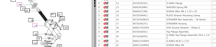

I located a hyd strainer(key 18) for a 6530 in parts catalog
Jim
Jim
Why thank you sir for the attention. Was out just now and had a good look at the pumping system. Fluid comes from the sump through a 1.5ish diameter pipe to a split, like the letter Capital F lying on it's back. As you asked, the pumps are ganged off one driven shaft and reading the manual, the steering just circulates fluid through the assembly, out through the cooler and back to the sump unless directed to a L or R position port whereby it does it's job then back to the sump.
Now that I know what is where, the "F adapter is attached to the input supply line and to the inputs of both pumps. Both had clamps on them and both clamps accepted screwdriver adjustment. After that I had leaking fluid seeping from the main pump input and noticed adapter deterioration on the steering pump input at the clamp. I don't know if it's plastic or sturdy rubber as it didn't deflect as a radiator hose would deflect when pushed with a screwdriver tip.
Now that things are evolving, it is occurring to me that had felt that my main hydraulics aren't as quick as they once were, but blew it off, and as quick as my 2400 being 9 years younger...assuming Branson designers had a lifting speed requirement for all loaders at a given RPM and sized the hydraulics accordingly....speculation but possible.
Anyway, I'm ordering the F today and after installation we'll go from there.
Thanks to you and the other guys for their inputs and your taking the time to find a filter screen for me.
