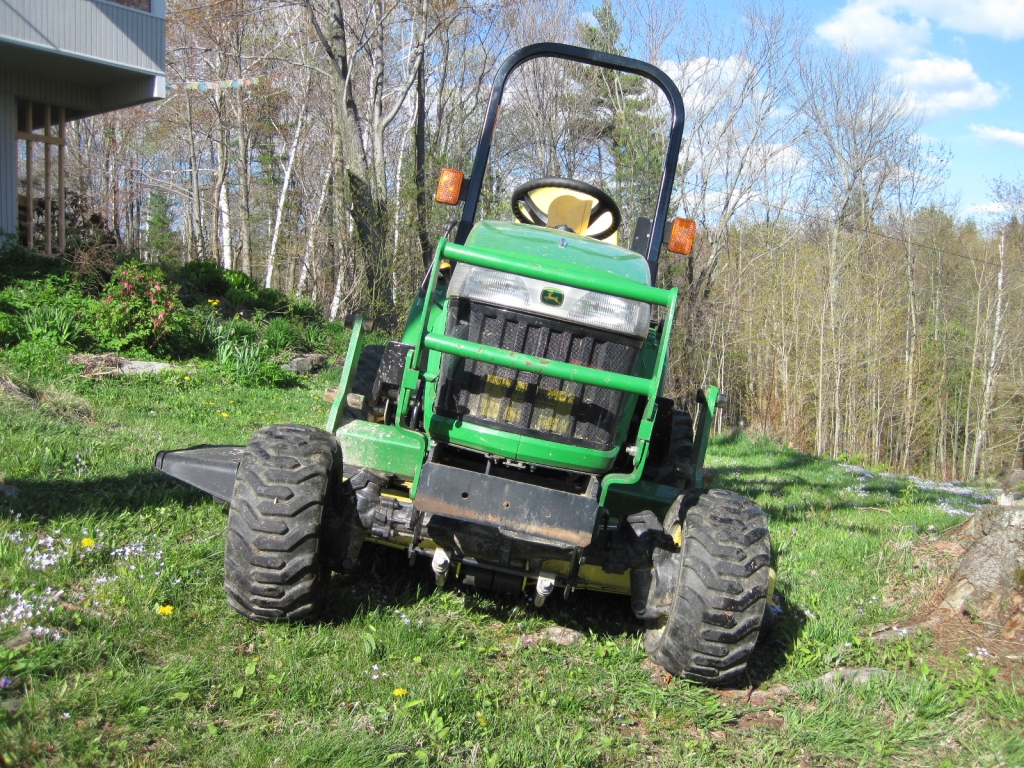

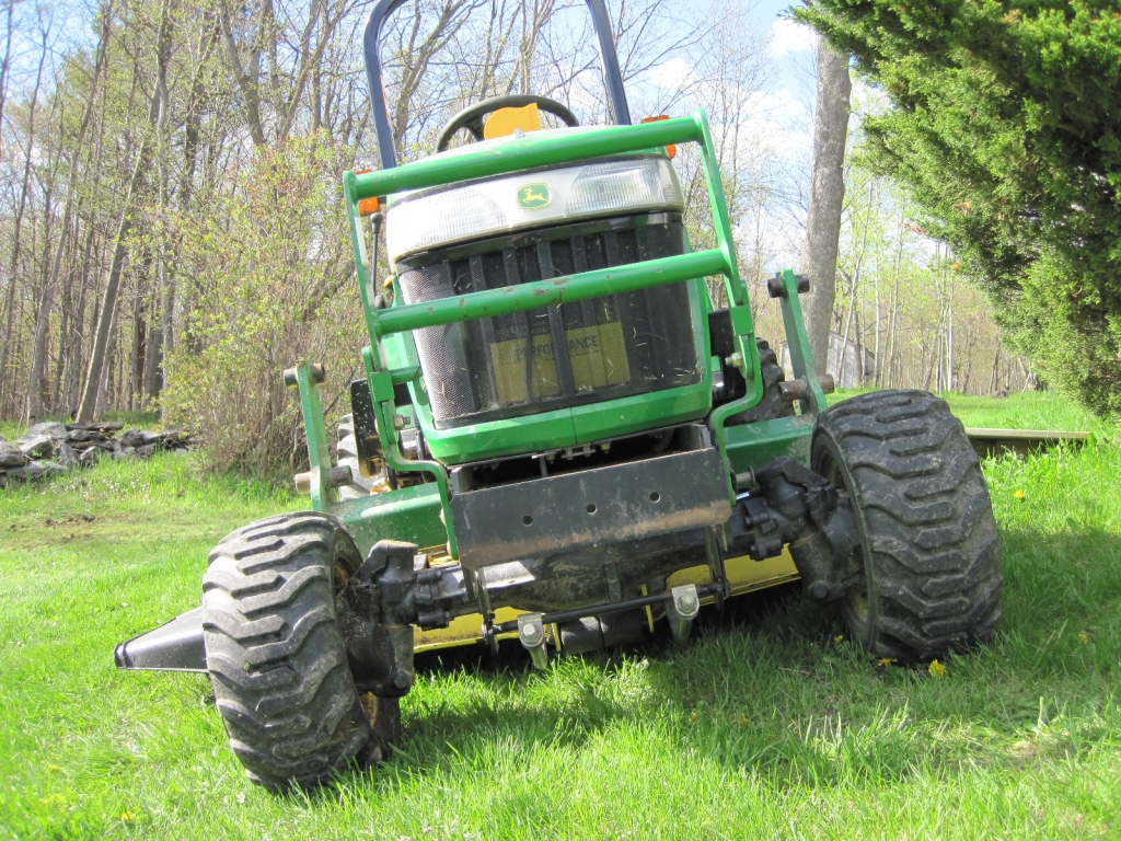

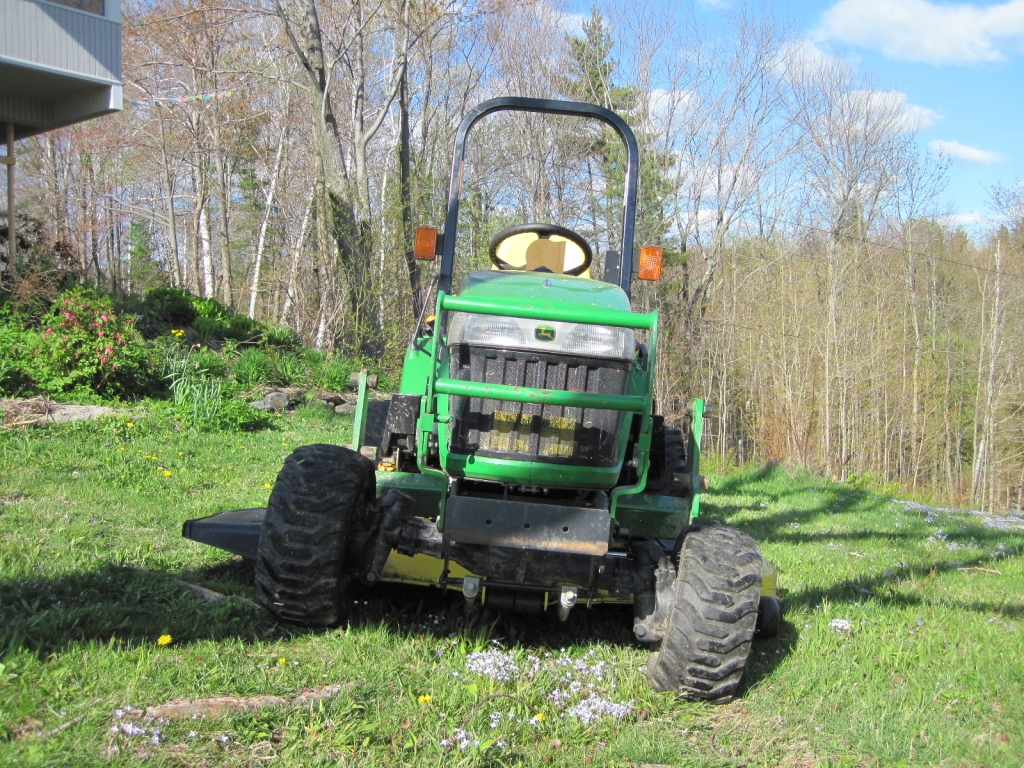

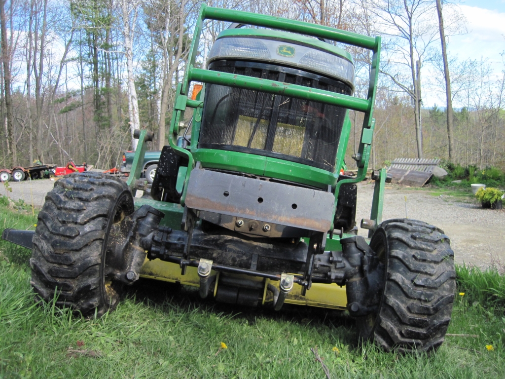

Pictures! I tried to hold the camera level, but you can see by the tree trunks in the background I tended to tilt it to make the slope look *less* than actual.
#1 is a 12 degree slope I have to drive any time I want to use the tractor.
#2 is an 18 degree slope. This is about where I start to "feel it" in the seat. I cross this regularly, but really get puckered with any load.
#3 is crossing a root I hate. I go over this very slowly with any load. The front axle is on the root and is pivoted away from it.
#4 is crossing the same root - the rear axle is on the root, and the front axle is pivoted the opposite direction.
Unless the ground is uneven, it doesn't look to me like the front axle pivots.

Uneven ground will make the front axle pivot. It's what it's there for. I tried to find some even ground for the non-pivoting front axle pics.
There's one other way you can get a pivoting front axle on even ground - look at the pics of these tires. Not too hard to guess which is uphill and which is downhill. This was on a 20 degree slope. The uphill tire barely has any tread grip at all.
