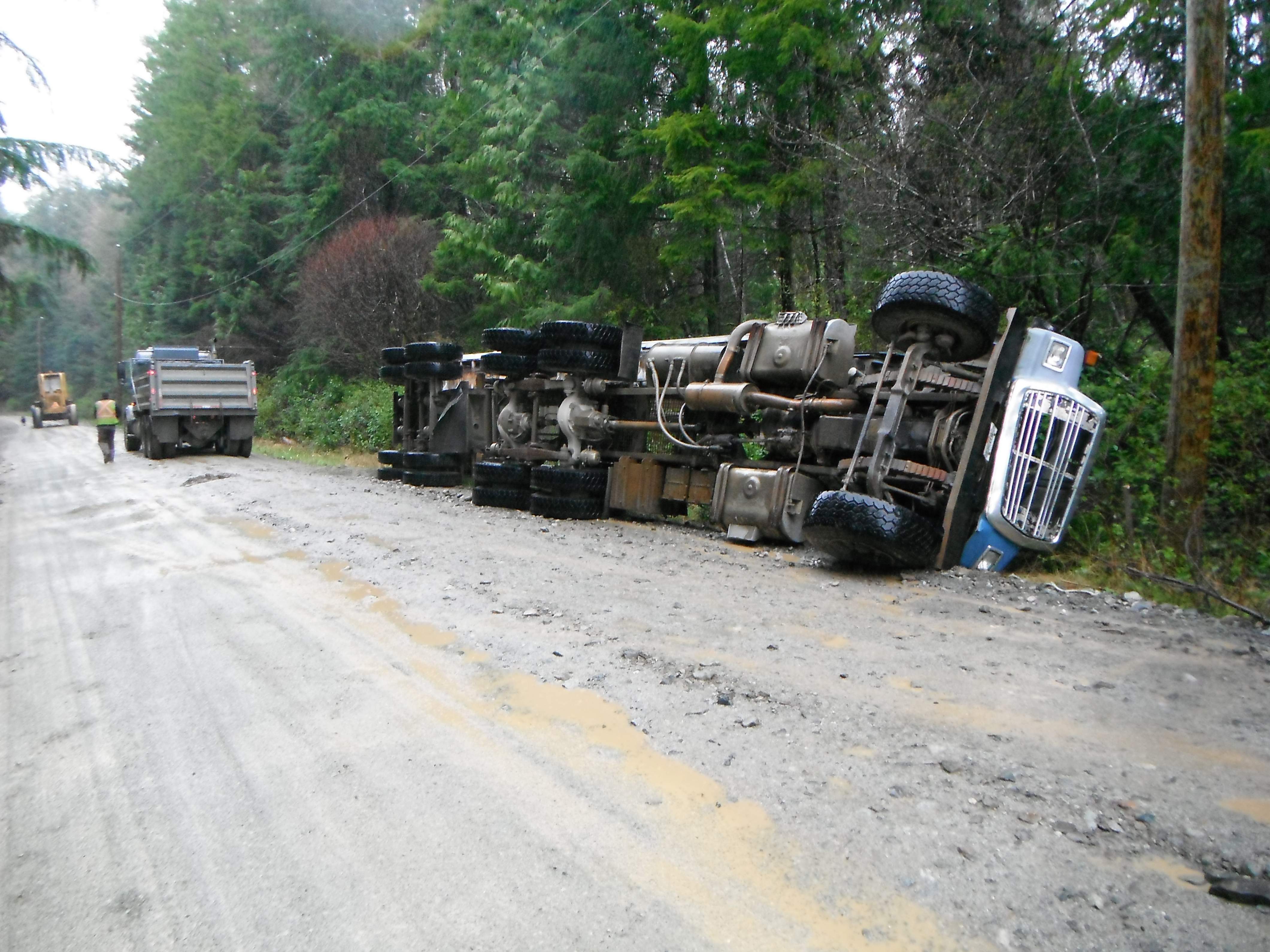

Never rolled my tractor But I did go for a wild ride in a 40 foot end dump. Heres a pic. DSCF0104.jpg

Never rolled my tractor But I did go for a wild ride in a 40 foot end dump. Heres a pic.View attachment 330652
