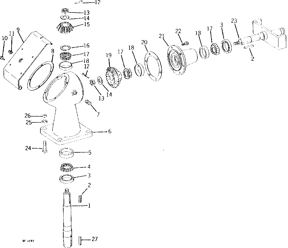

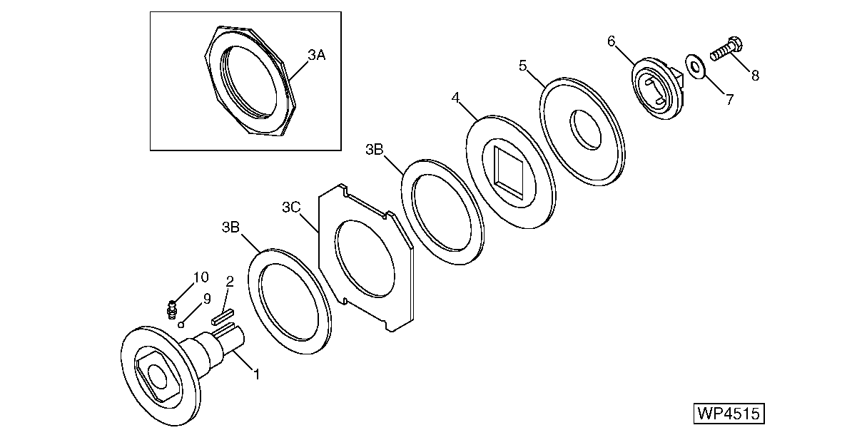

I think holder(parts key #1) is rusted(stuck) to gearbox input shaft. Have you applied liberal amounts of your favorite penetrating oil such as PB-Blaster or Kroil?

Dont see how that could be from the diagrams.
Yes, the large threaded portion has the wobble, as matter of fact from the plate next to the gear box all the way to he end of shaft wobbles, but im pretty sure that is one piece. the large threaded portion is connected to the plate. Yes there is a grease fitting that screws in where the large threads are, had to take it off to back off the castle nut. Yes the end of the shaft you are looking at is keyed on one side and the yoke slips over it and a bolt holds it in place.
I don't know if your model is the same or not but I worked on a deere rotary mower this summer. I forget the number but the slip clutch came off by taking out the grease nipple and pulling out the ball bearings inside. There's 9 or 11 ball bearings in there. If you go to John Deere Home Page Redirect and look up a parts diagram for your model it should give you clues as to how everything is put together. Parts are expensive.
Use your penetrant down the hole left by the grease nipple. The diagram calls for 12 balls in there. ... Apparently the [ shaped piece turns the input shaft to the gearbox. Hopefully there is a plain bearing between the two coaxial parts that is worn, giving the wobble.

I'm gonna try and fix it, but I'm probably going to buy a new one. You were right about the ball bearings. A good man who works at a local shop stopped by today and confirmed what you said. Problem is the clutches were rusted together and the hub's slight wobble. If the hub is worn its 500.00 not to mention the clutch plates. The real problem I have with it is I have new tractor and I'm worried that the cutter may damage it if it malfunctions. Oh, once you fish the bearings out do you put them or the new ones back the same way.

I know too from working on that 205 last summer that there are bushings in the slip clutch housing on the shaft. Maybe all you need to do is replace them and the wobble would be gone. Just another angle

I just did a bit of looking and my mower and the one I worked on were both 506 models. A bit newer than the one you have I believe. The bushings are not available from Deere but I just went to a farm supply store and bought generic bushings with the right outside and inside diameters. I also ordered new ball bearings as the ones I removed were garbage. I don't remember what I did to take the old bushings out as they are in a blind hole. I probably just made myself a cape chisel and split them with that so that they could be removed. If I look at the parts diagram for a 205 there is no drawing on part number W14799 that shows there is a bushing in there. If you look at the similar piece for a 506 in the parts book then you can see the drawing for a bushing. If there are no bushings in your holder (W14799) for the slip clutch I would just take that part and the input shaft from the gearbox to a machine shop. A good machinist should be able to bore part number W14799 for bushings that are a snug fit on your input shaft. He might have to clean up the input shaft a bit too or else build it up and machine it true again. Also lots of times a machine shop can make new shaft's cheaper than you can buy them at the dealer.
Just reread the post and realized I missed something. When I replaced the bearings I just lined up the grease zerk hole with the grove in the shaft and dropped the new ball bearings in. If you end up taking the parts to a machine shop make sure they realize that the grove for the bearings has to stay in the shaft and the holder otherwise they become useless as you have no way of keeping the shaft and the holder together. Hopefully I've explained everything well enough so that you know what I mean. Good luck.
