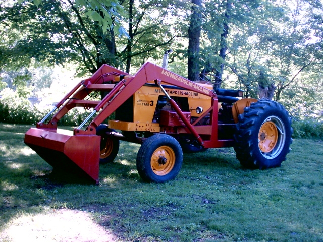

Metal has a memory, that’s why springs work. I spent my working life as a millwright in the sawmill industry. There were many times when a derailed log carriage was twisted so all the wheels didn’t touch the track. It took the better part of a day and a rosebud to heat and then allow to cool the “stretched” area in small sections. Slowly the carriage would return to its original shape confirmed with a machinist level. The trick was to heat the spot you were heating to “straw” just before it would begin to glow then let it cool. You will need to work in sections if it is a long bend. What is required is a good rosebud, not necessarily a big one, a straight edge, patience and persistence.
Or you could just bend the other side to match like I did on the Minneapolis Moline Jetstar 3 I restored, it was easy because there was no relief valve.
