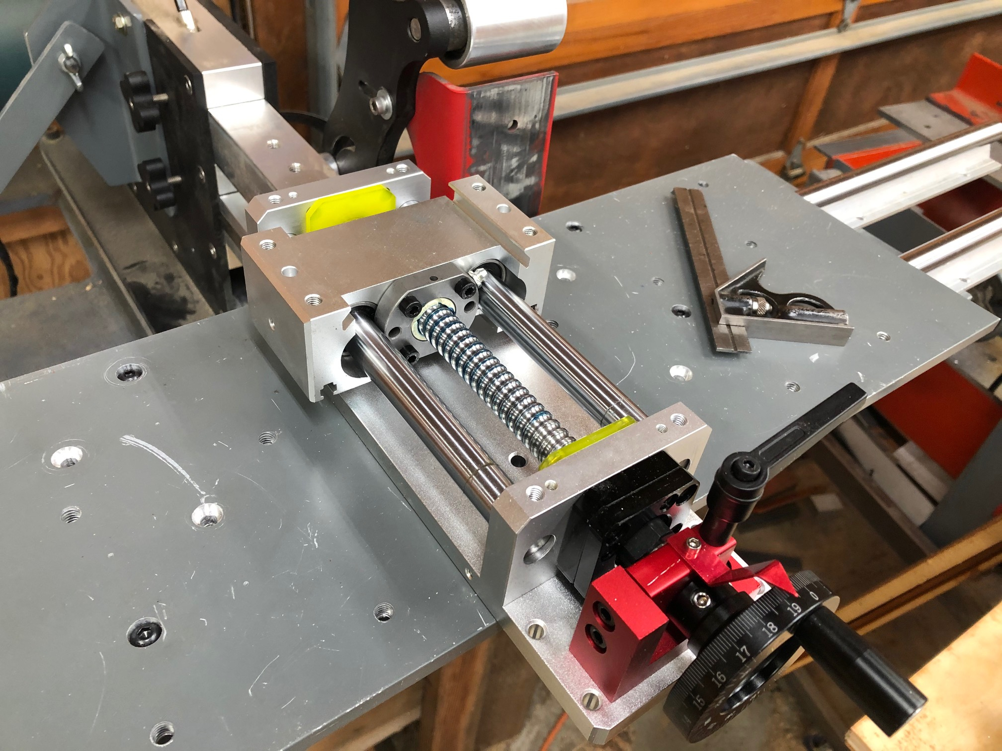

Photo 3 - the work table is 3/8" aluminum. I put a grid of threaded 5/16" holes so standard milling machine hold-downs can be used on large or irregular work pieces. It is also drilled to accept a sliding T-nut extrusion.
Photo 4 - T nut extrusion installed. I am making a long bread slicer knife from a power hack saw blade. It is fixed to the extrusion with three clamps made from 1/4" steel.
With this setup it is easy to get a perfect bevel on the 20" knife blade. As well as perfectly square and even finishes on other workpieces.

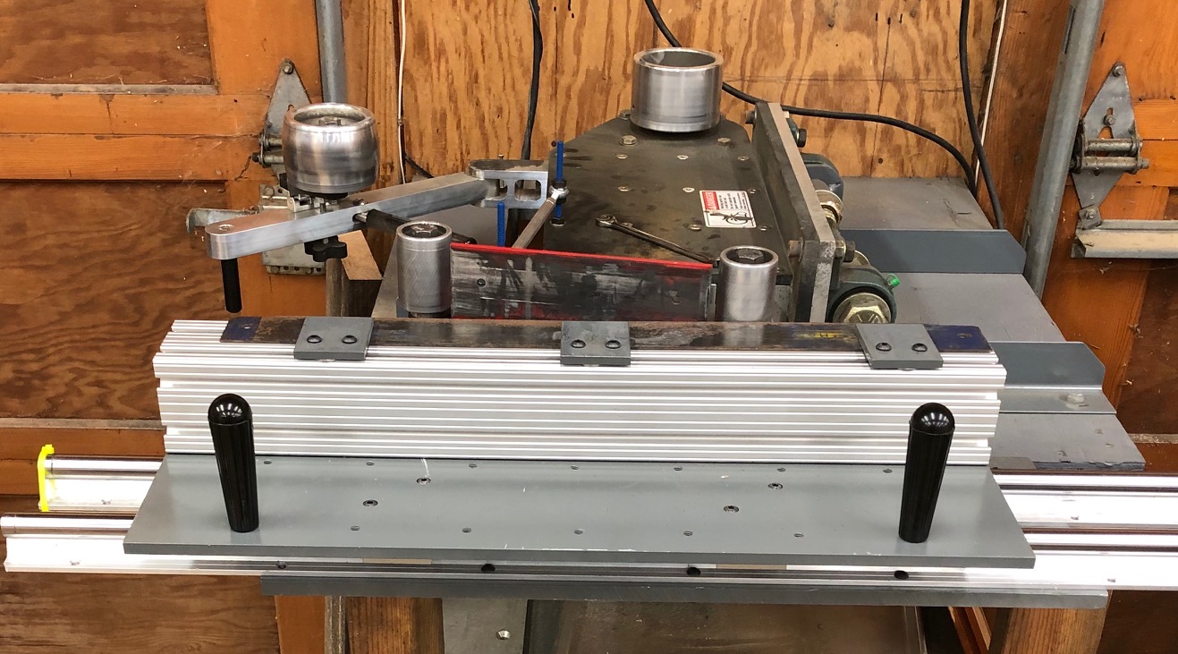

I got the sliding table set up to work with the grinder in the horizontal position. It removes material very fast and accurate. I debated making a fine adjustment mechanism to move the table toward and away from the belt, but decided for starters to just move the tool rest arm in and out. That works but is too clunky. So the next step is to make a screw in/out adjuster.

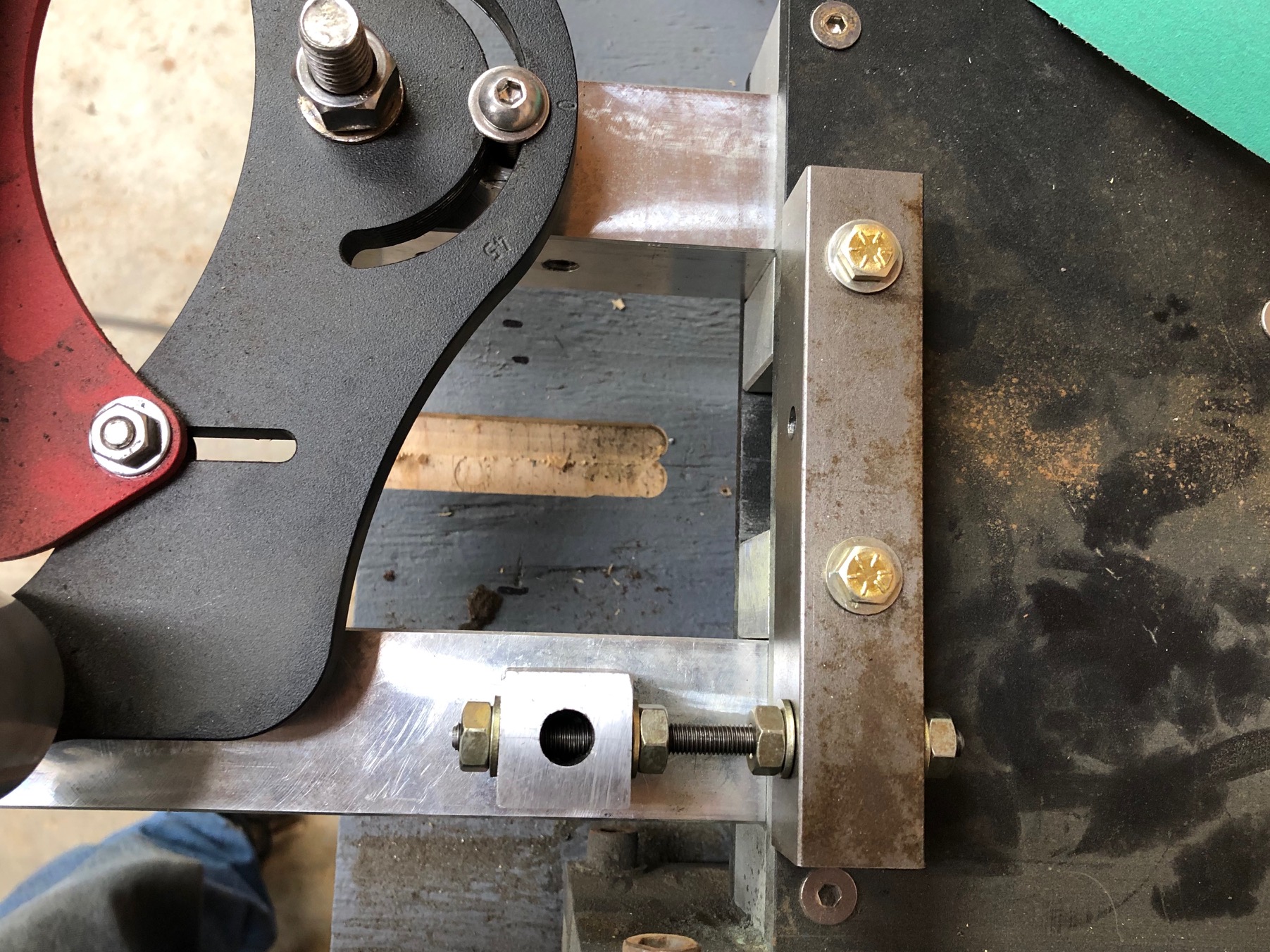

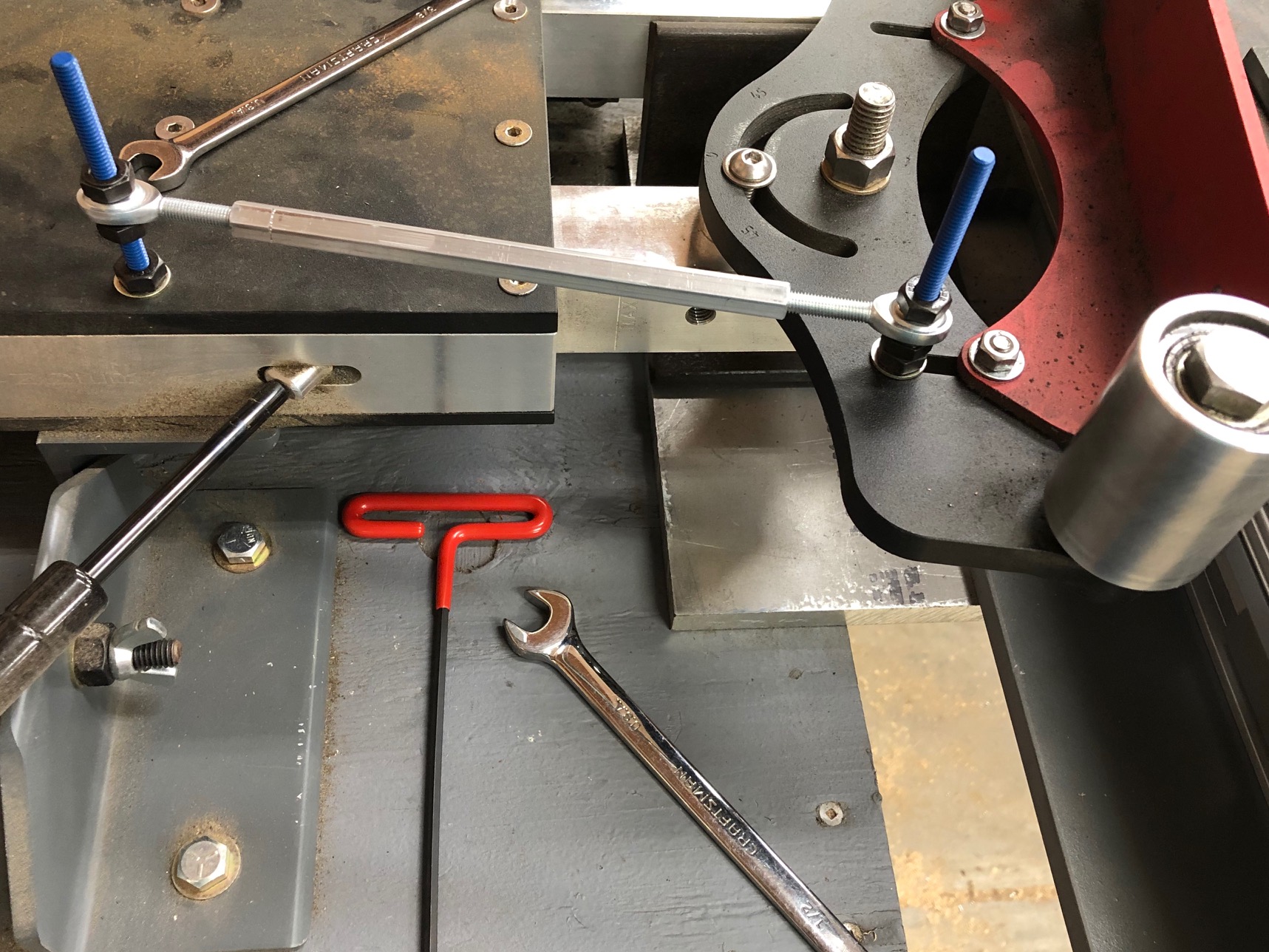

I had to order some specialized hardware for the fine adjustment mechanism so that took a couple days. Installation took two minutes if that. Didn't even have to drill any holes. I am using a sort of turnbuckle with ball ends. The threads are 1/4x28. I calculate that a 1/12th turn of the turnbuckle (half a flat) translates into about .011 movement of the roller. For this type of operation, poor man's surface grinder, the angle of the belt doesn't matter. What matters is engagement of the roller to the material.
Anyway it works well. I added a couple handles for ease of use, probably safer too.
I still want to add another motion to the work table (to get both x and y motions) but that can wait until I figure out a good way to do it.

This is my V2.0 adjustment mechanism. The first one worked on the belt wheel arm. This one works on the tool rest arm, in both upper and lower mounts. It also uses a 1/4 x 28 threaded rod. The fine adjustment for this machine only has to move 1/8" or so. More elaborate mechanisms are not needed.

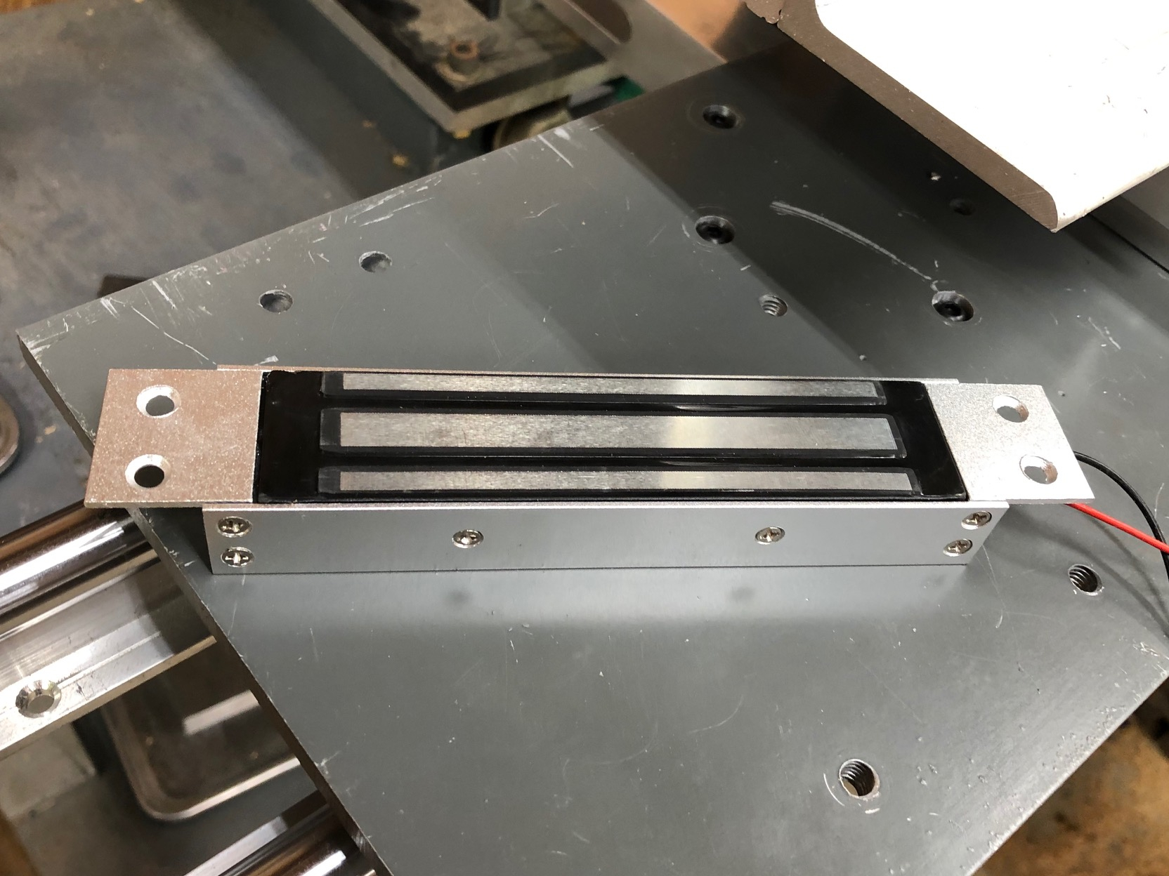

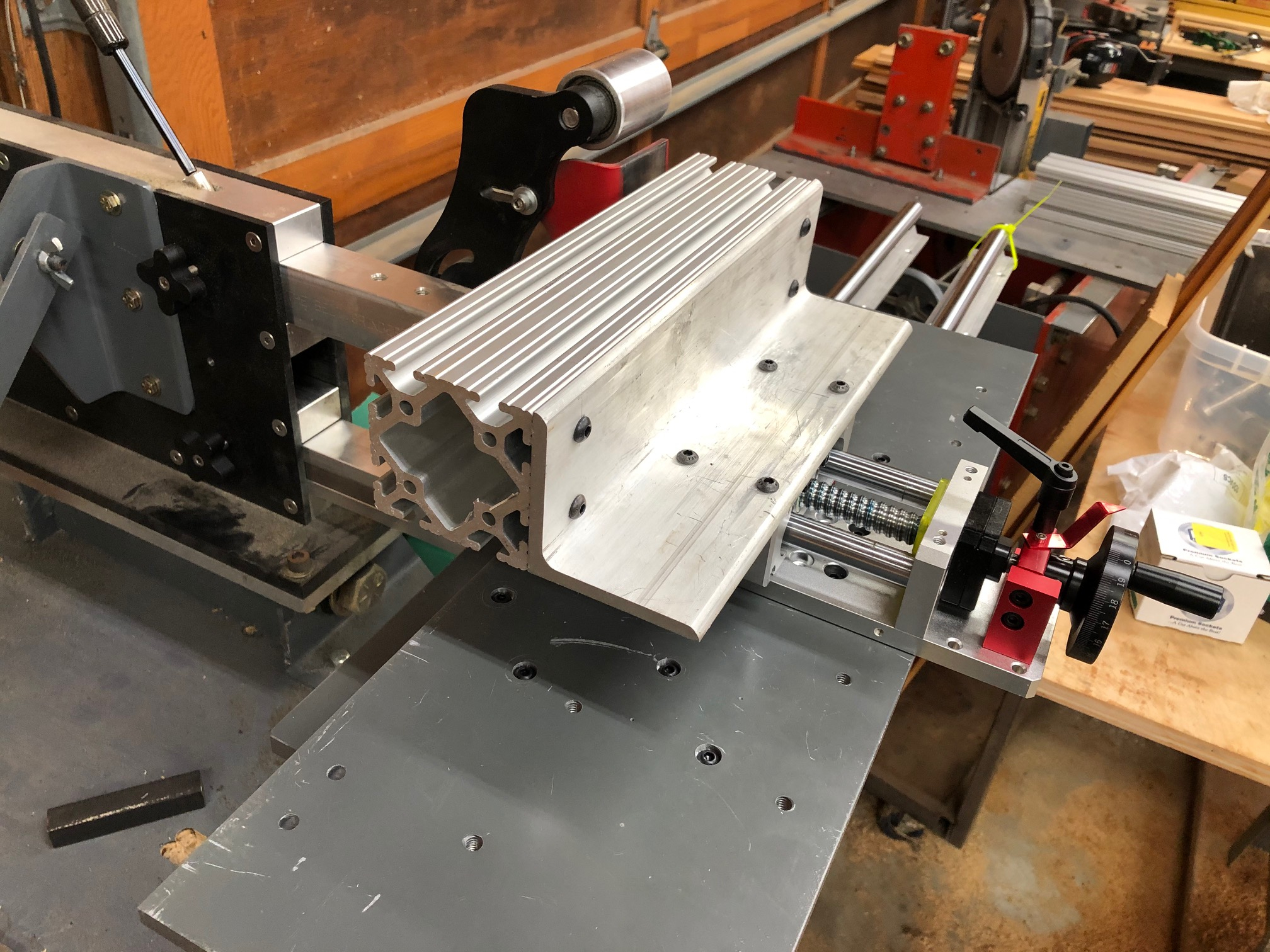

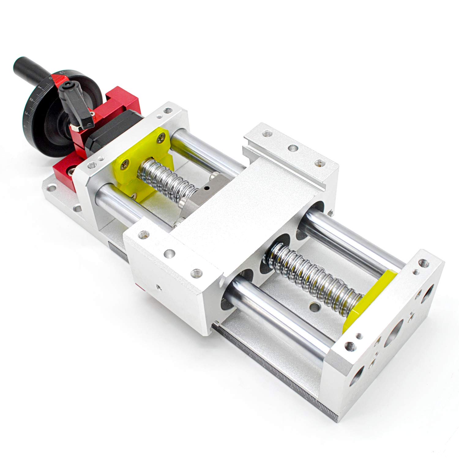

I decided to install a proper slide on the work table. It is from China and very well made. No play anywhere. Linear bearings for the slide mechanism and a ball screw for the movement. For $150. I could about buy the materials for that and then still have to make it. I also got a magnetic door lock for use as a magnetic chuck. I am still thinking how best to mount it. I need to keep everything interchangeable to easily switch from one work holding adapter to another, depending on the material and operation.
