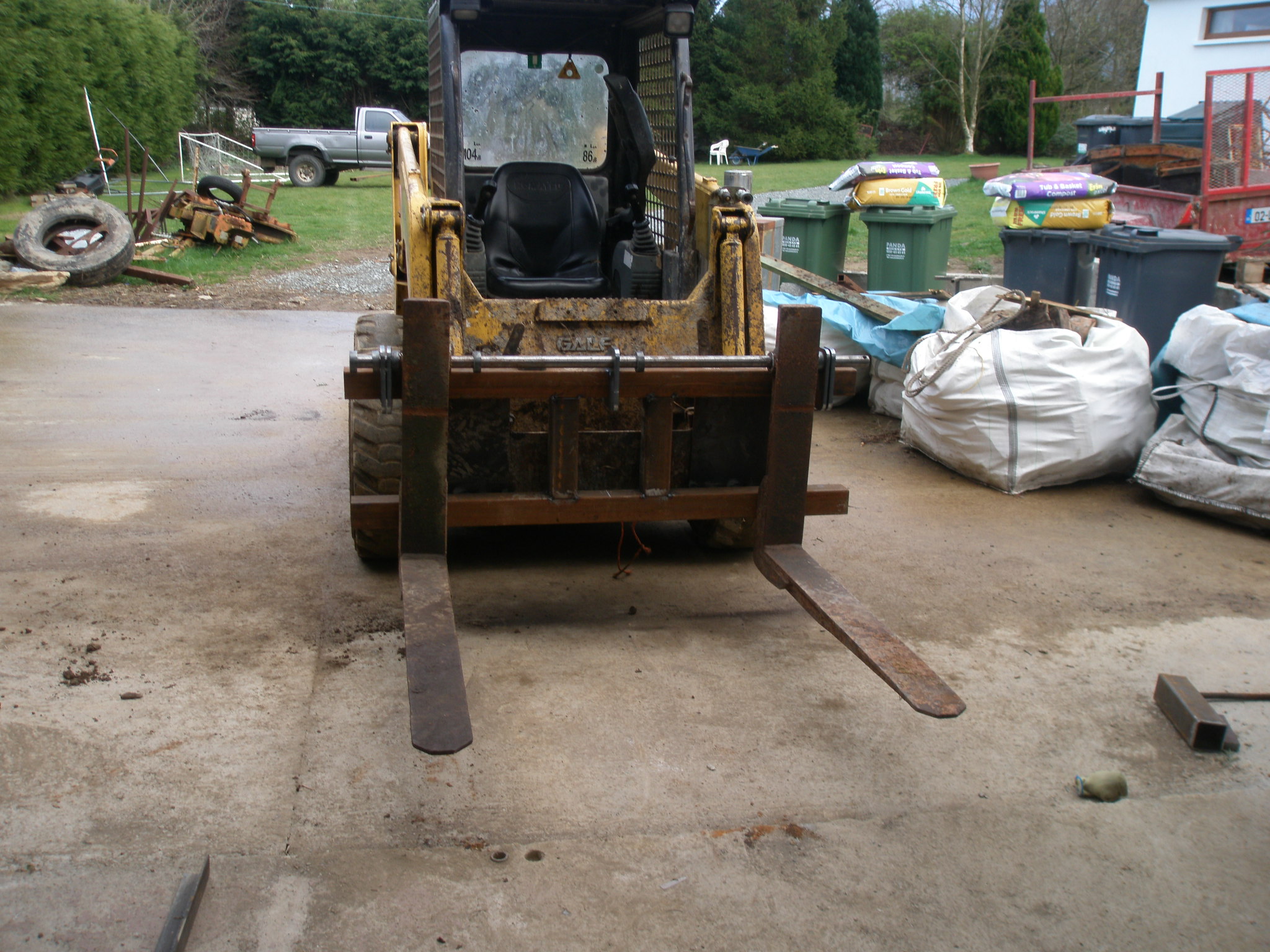

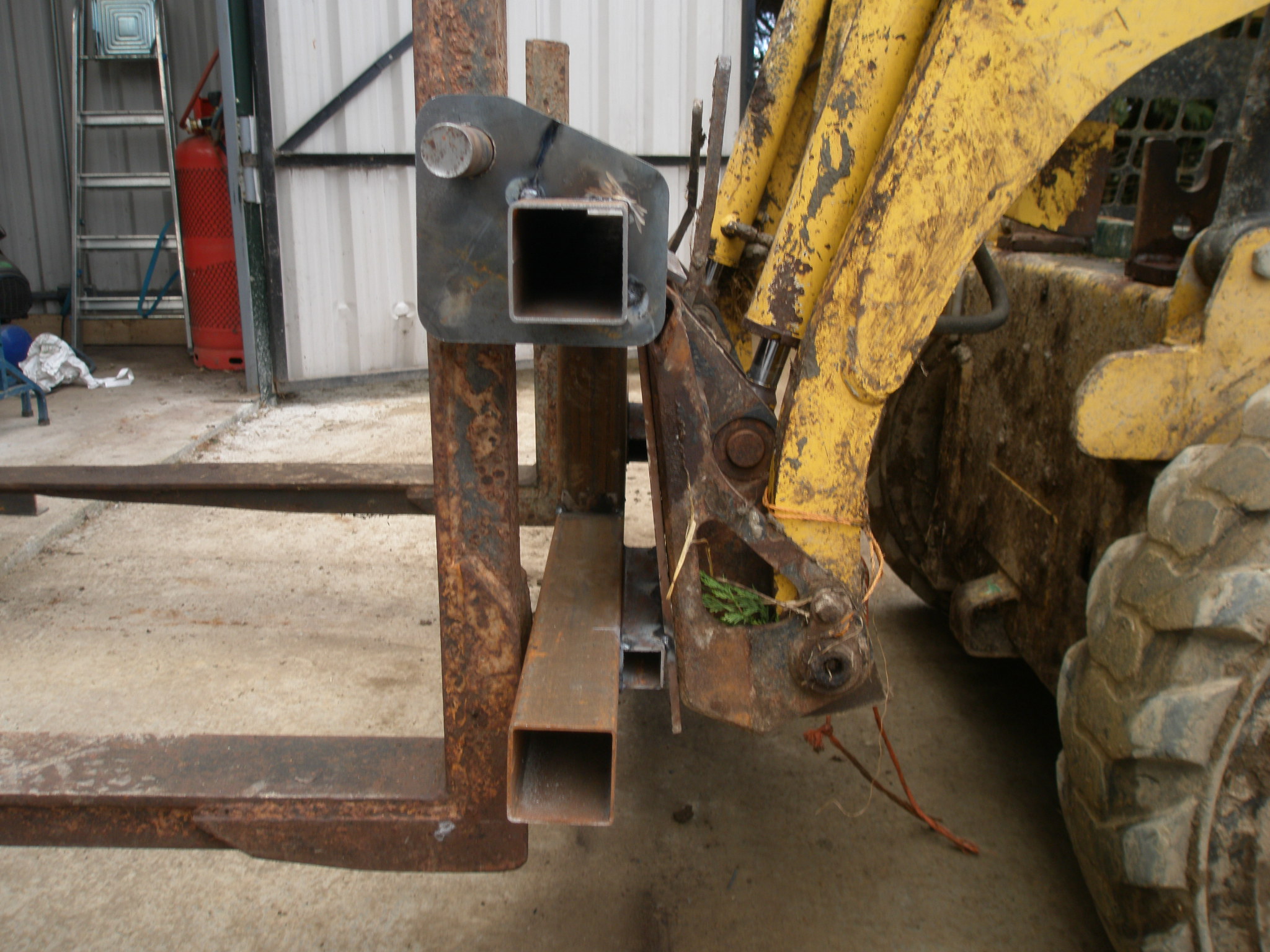

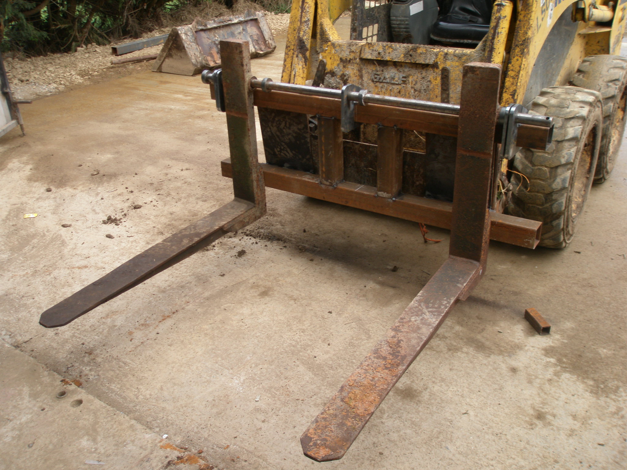

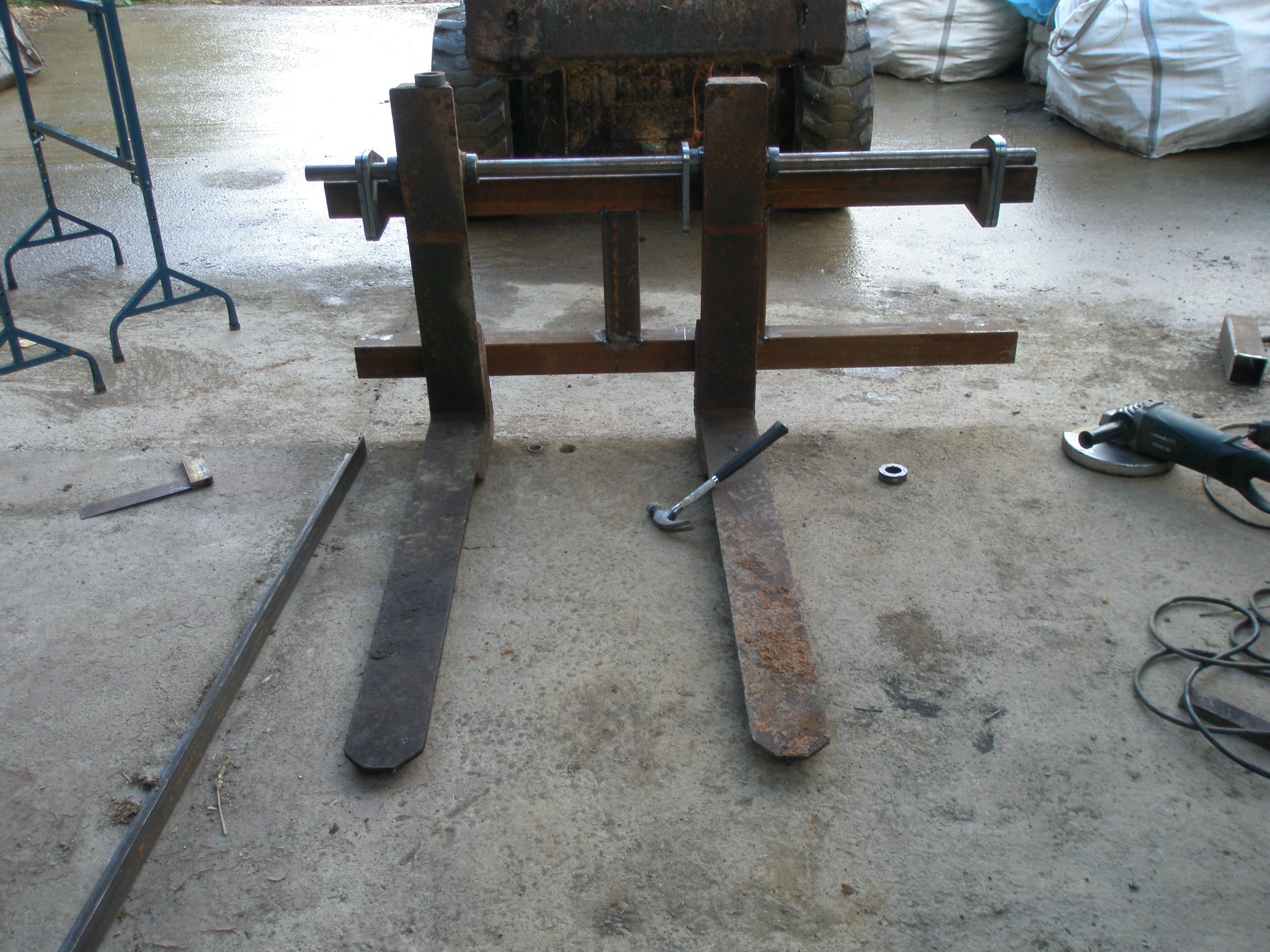

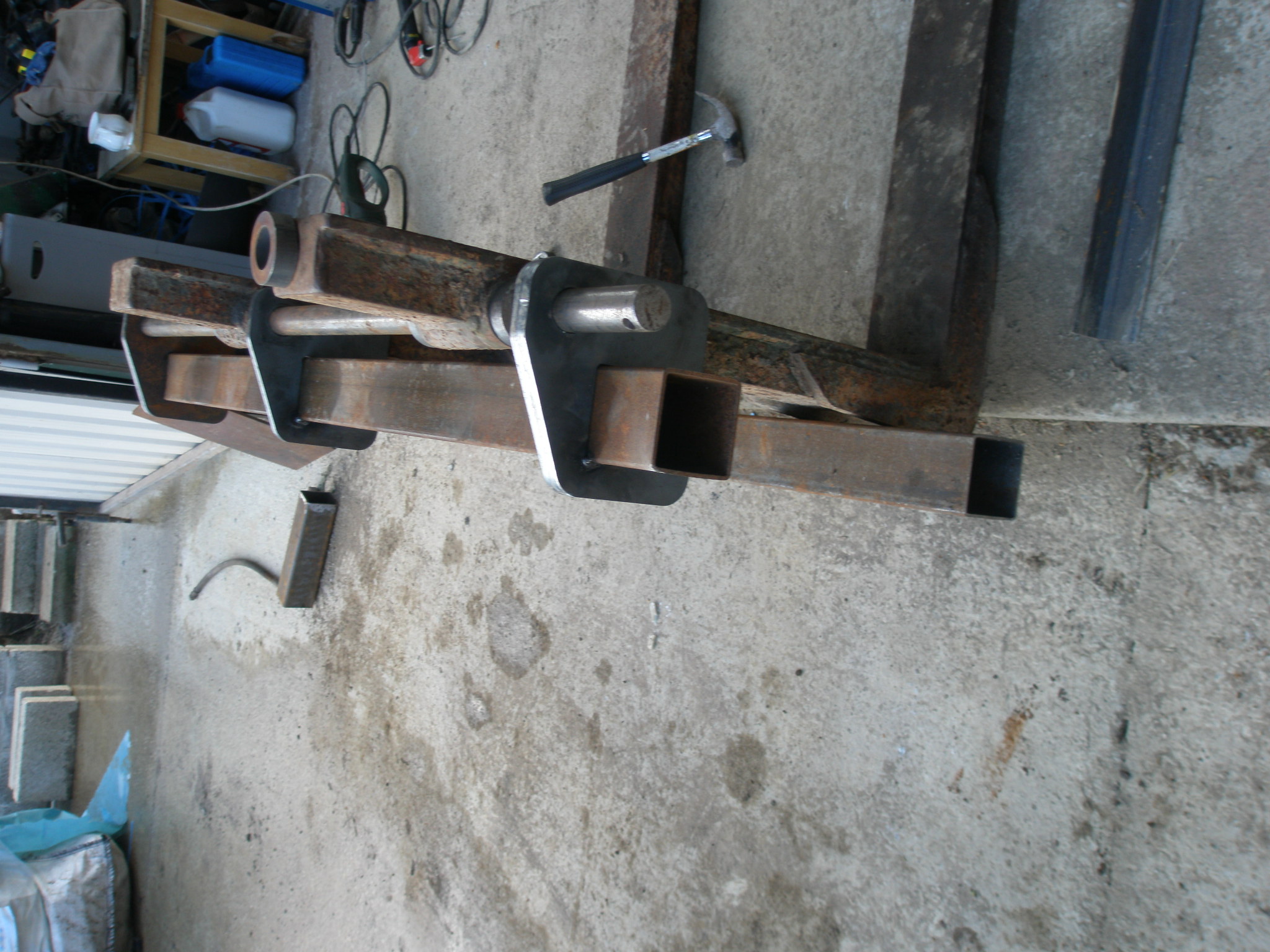

Progress so far.....
Have the frame tacked together. It is a little wide, so we will shorten it by 4" each side. Should get it finished by the end of the week...
