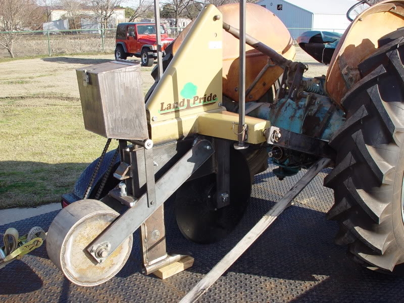

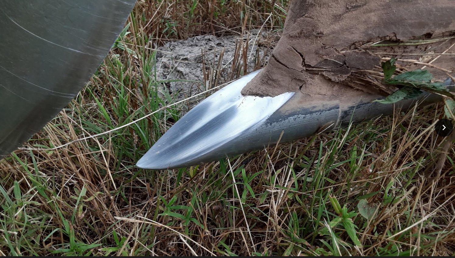

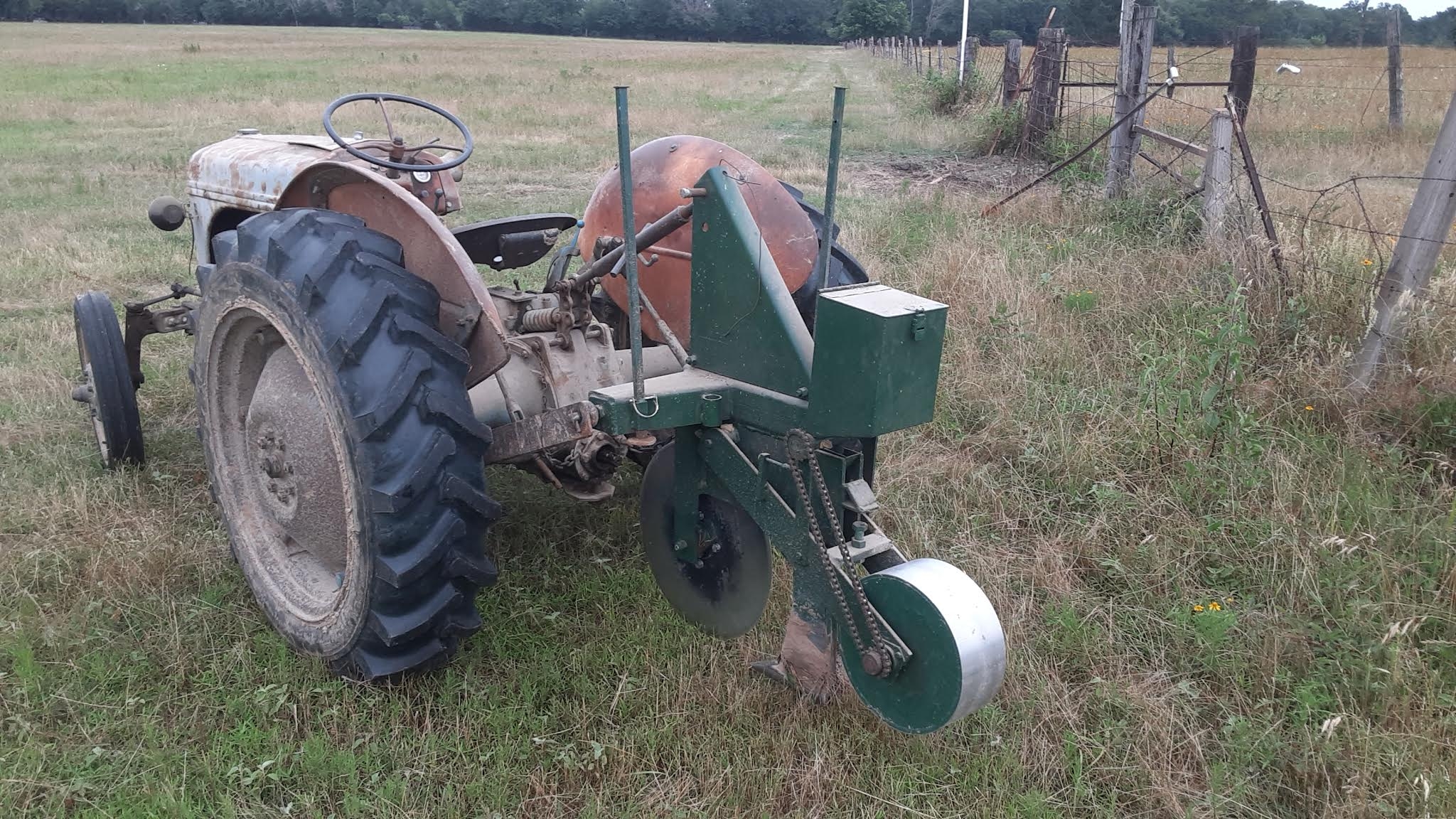

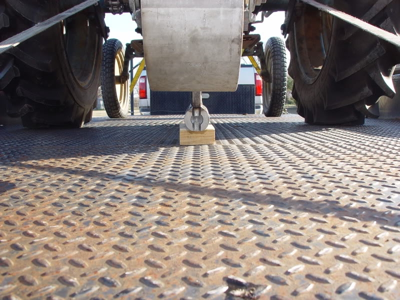

A gopher plow would be much more effective and faster. I made this one that makes a tunnel below ground and drops a thimble sized amount of poison seeds very 3ft at a presst but adjustable depth.
The 1" shaft below the hopper has a blind hole in it that rotates when the depth stop wheel is on the ground.
The 2" bar stock on the bottom makes the tunnel, the seed drops out behind it.
