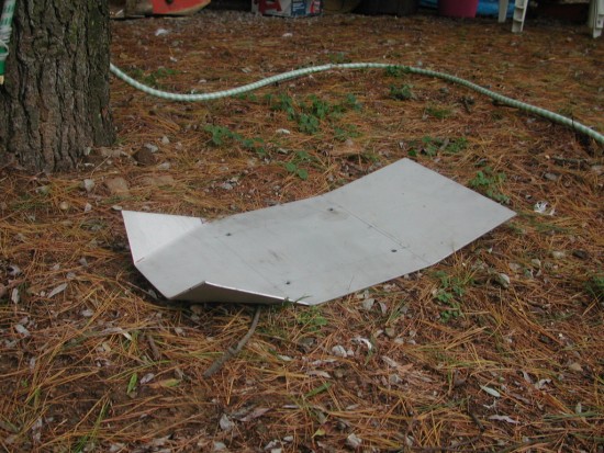

I'm almost /forums/images/graemlins/blush.gif to post it, but I made a small skid plate to protect the front driveshaft on my B2910, which has a plastic cover that the dealer replaced under warranty a month after I got the tractor...
I did not want any further problems, or questions as to whether I caused the failure if it happened a second time.
This plate is made from 1/8 aluminum. Works well and has left its impression on the dirt more times than I can count.

henro did you bend that aluminum on purpose or just working it hard?

<font color="blue"> henro did you bend that aluminum on purpose or just working it hard? </font>
SAR,
I bent it in advance. I thought it better that the corners be up out of the way. Otherwise I expected they would catch something and the plate would be ripped off...
It has worked good so far. Many scratches on the bottom now, but it is still in place.
The attached photo shows the shape "as bent" before I put it on the tractor. /forums/images/graemlins/smile.gif
