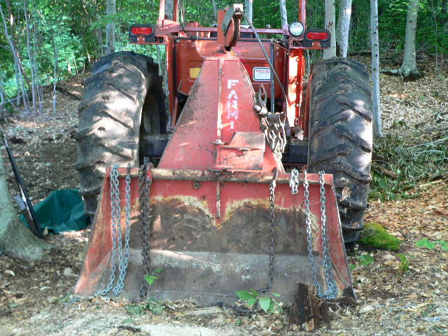

Also, FWIW, I can understand the winch jerking a tractor around some, specially with a hang up. How some ever, some basic fundamental rules apply!
First, your lanyard needs to be long enough such that you are well off to the side of your tractor when winching.
Second, watch the cable as it feeds into the top of the winch, NOT the log. You will be able to respond much faster with clutch control if you keep your eyes trained on the winch head.
Third, If you have "raised up" or nearly tipped over" your tractor while winching, you have NOT set the winch up properly. It will NOT do that, CANNOT do that if set up properly. The physics are all wrong.
Pull straight back (90 degrees) from the winch frame. Use a block if you cannot get the tractor angle right.
Larger farmi's have a movable pully mounted lower on the frame which significantly changes the direction of force, basically driving the winch frame into the ground. It is there for a purpose..... using it results in the force being applied to pulling on the lower links and pushing on the top link, rather than pulling on the top link, using the lower links and feet of the winch frame as a fulcrum..
Picture of said pully on a farmi 601, it is mjust below the farmi name. It is movable with pin holes on the center spine of the winch frame. The heavier the pull, the lower you mount the pully.
It is important to be sure you have a robust top link, in any case, wether tension or compression forces are at work.

...........First, your lanyard needs to be long enough......... Second, watch the cable NOT the log..........Third,set the winch up properly......be sure you have a robust top link.

Could be the same one!. I bought it from a guy near lake Placid. It needed a complete rebuild but that was about $150 bucks in bearings. It pulls like a locomotive, now.........
And set up right, it will NOT lift a Hesston 100hp, even with the FEL dismounted. Wit a heavy pull you use the down pully and the physics will not allow it to do that. The leverage is just all wrong. Plus, I run the trqactor at 1000 RPMs. There is absoutely ZERO need to run the tractor RPMs any higher than peak torque. On that Hesston, peak torque is 1500 RPMs, and I have not needed it, even with a pull of three very large beech trees up a steep slope.

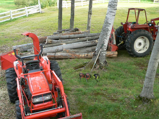

Like I posted earlier, with the new bearing in it, it pulls like a locomotive. Using the lower snatch block properly, it just tries to dig the dozer blade in deeper. Me and my hired hand did several up hill pulls with it yesterday..... big honking beech and a heavy old poplar that was about to blow over.
Last fall, before I rebuilt it, I pulled a 60 foot poplar up a steep rocky bank. The butt of the tree was 26 inches across. I just split that old sucker up this afternoon. Man, that is junk fire wood, but hey, it was down. No point in wasting it.
The bearings finally gave out a few weeks ago when I pulled a big Deere loader out of the mud. I guess 25,000# was just a tad too much for the old bearings! Ha! I got the loader out, though and did not stand my tractor up!
