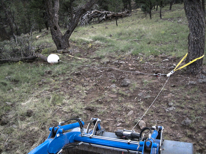

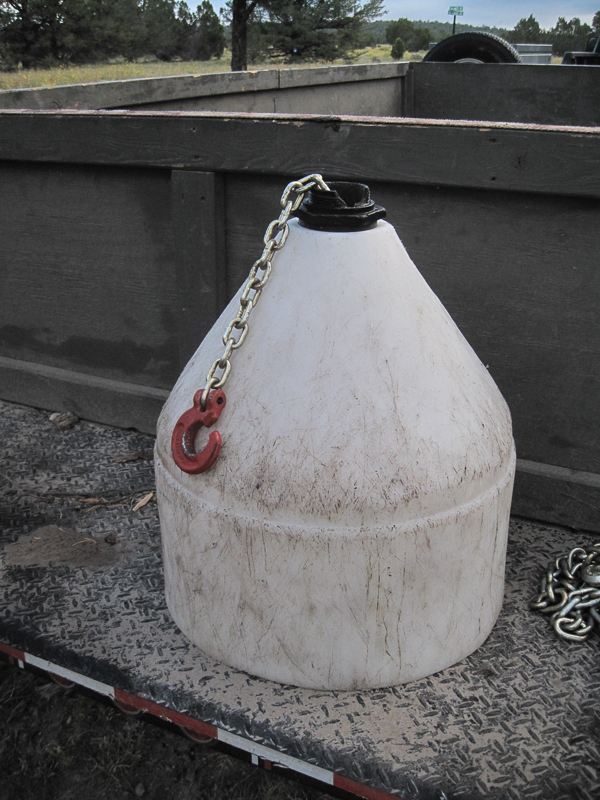

A skidding cone comes in handy, a Blue barrel https://northernwoodlands.org/articles/article/homemade-skidding-cone would work fine .
I definitely agree with the use of some sort of skidding cone, especially if you are dealing in a rocky area or going uphill. I found myself with a large mess on the back and side of my property from a tree thinning project in our community. The forest service did "lop & scatter" rather than removing downed trees and debris from the canyon area. This was a main wildlife corridor that greatly effected the elk travel pattern, which we loved to watch. So my wife and I decided to clean it up. Ended up being at least 5 overloaded trips with my 22' flatdeck to the slash pit.

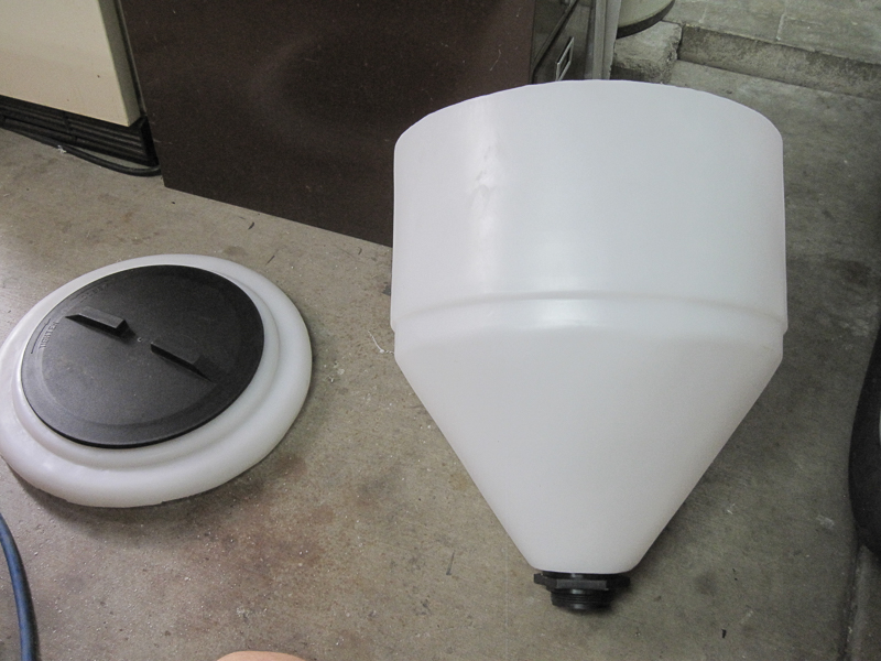

With a lot of exposed rock and stumps I needed to have something that would allow the timber to not get stuck pulling uphill. I purchased a 15G conical drum and cut off the top to use as my log skidder, along with a choker chain, multiple g70 tiedown chains and a 5000lb 12v HF winch we got to work. Another must have for the chains is the "locking end" clip type so that the multiple chain connections don't come undone until you want them too.
