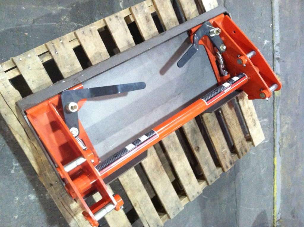

   / skid steer to ( fast attach) pallet fork conversion #34
Need pictures. Your 3rd picture is too close up to show the outside edge and angles.
I guess something like this is what you have:
FYI, my dad just bought a pair of those identical lockers. Made in china, and they need modifications just to work properly (or at all).

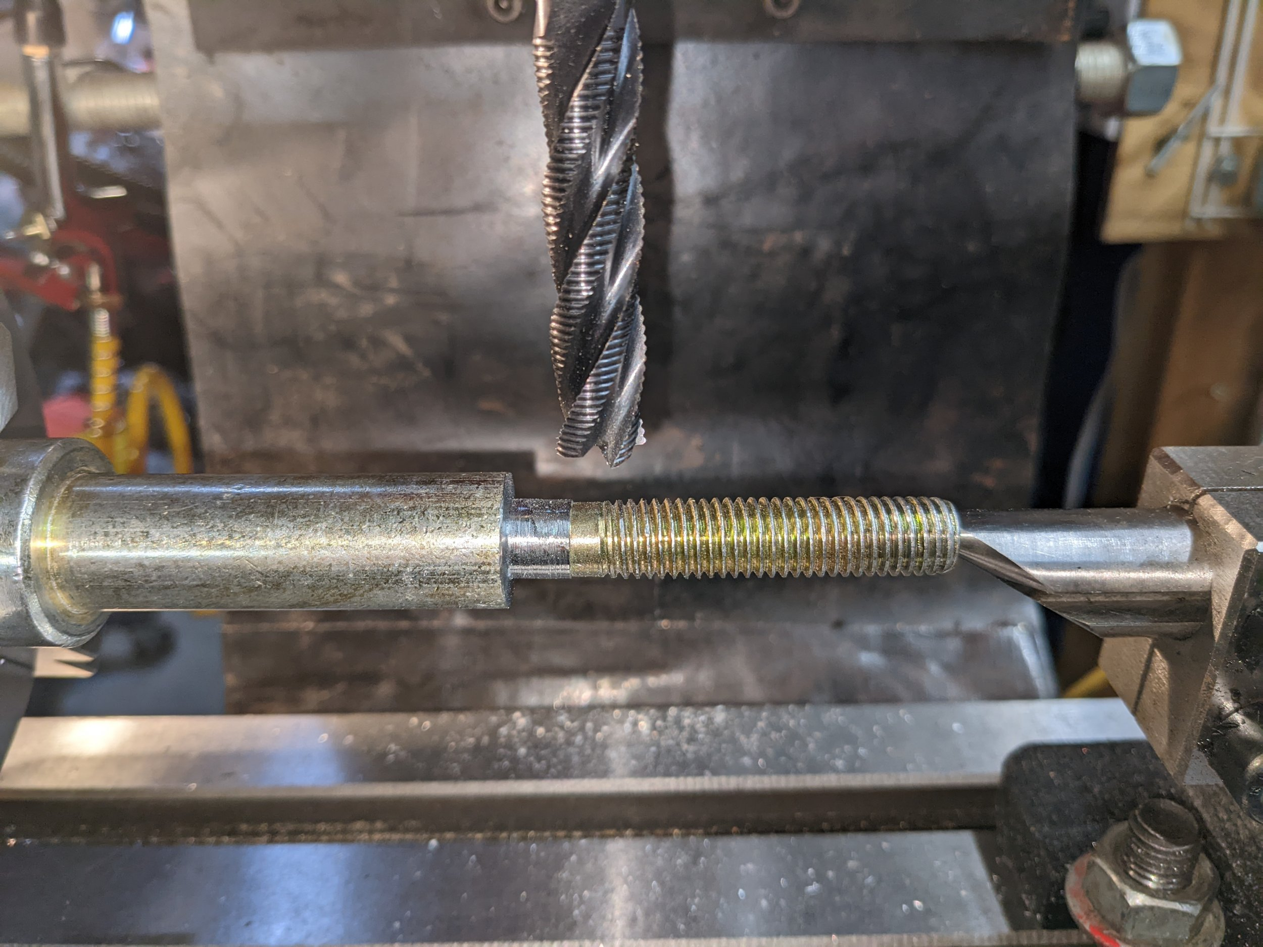

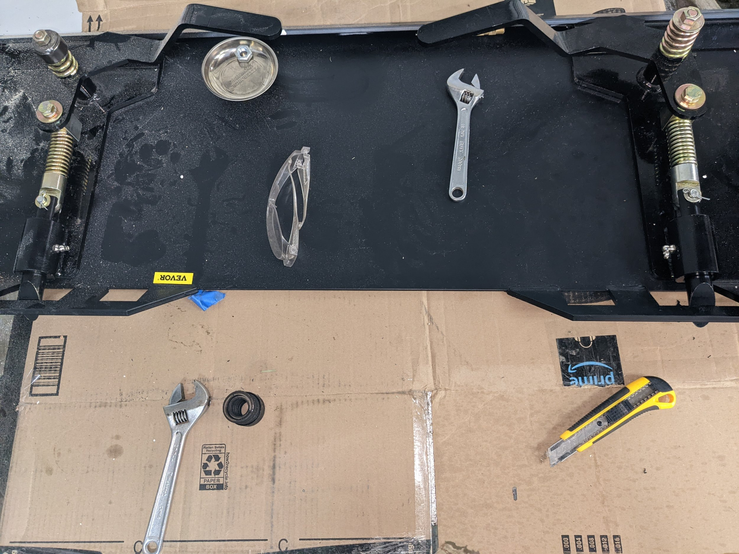

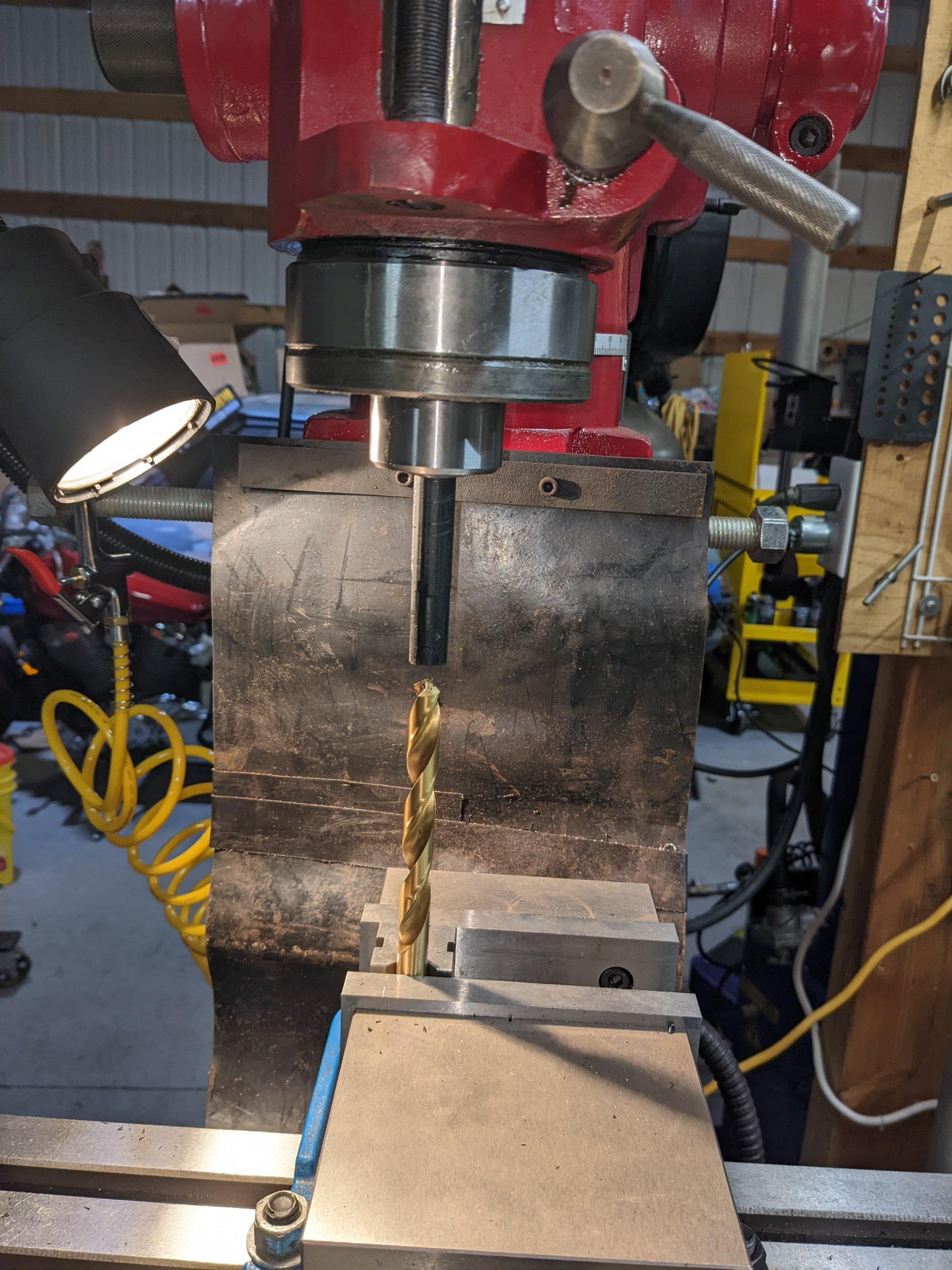

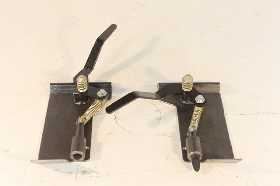

Off to a Rocky start.
They machined the QA spring actuator incorrectly to where the handles cannot be rotated over the break over point to lock them I am machining the shoulder down so it will work.
The actuator part that slides is either mis machined or machined for a bushing that is not included therefore when you push the lever the assembly binds on the threads that are used with a nut to keep the spring compressed.
I am trying to source or will have to machine those parts as well.
More to follow.
The QA mechanism plates are as advertised and well made. Just need to address some issues and move forward.
Just to follow up on my previous post, what you posted is exactly what we had to deal with. We made our own bushings, filed the throat of the steel block, and drilled and tapped in a grease fitting.
Without doing this, the mechanisms are completely inoperable.

I was going to enlarge the throat of the blocks if my bushings did not work.
The bushing walls were "thin" for sure. I will enlarge the blocks if the bushings I made fail.
