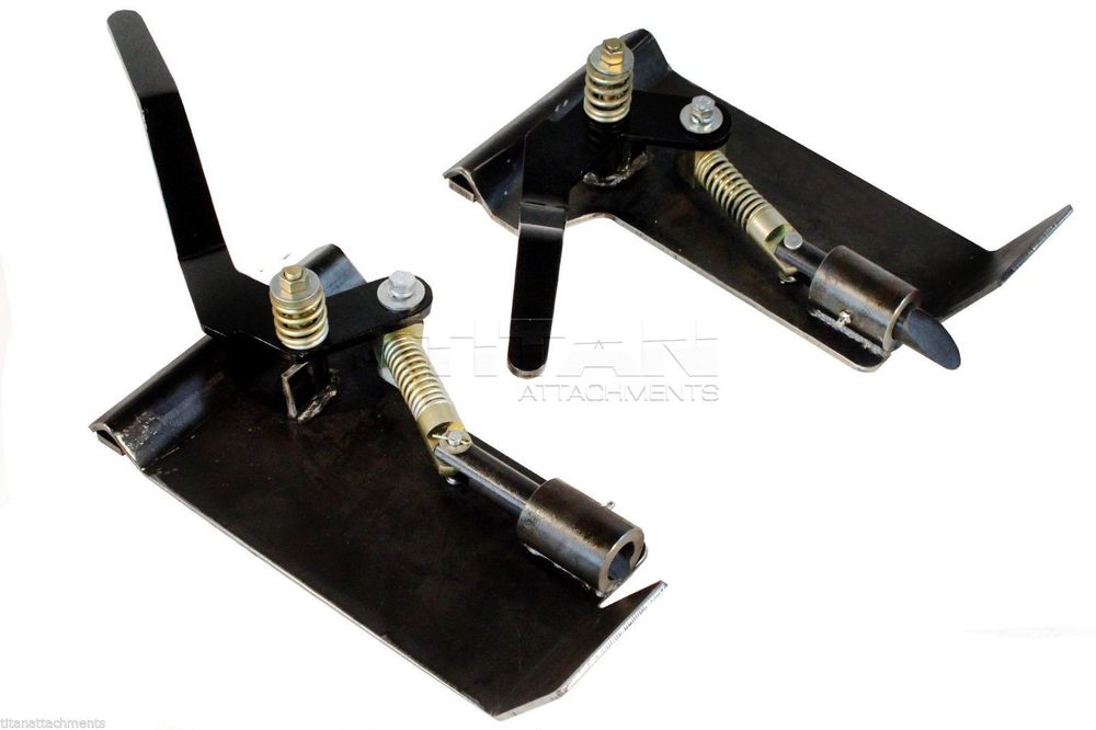

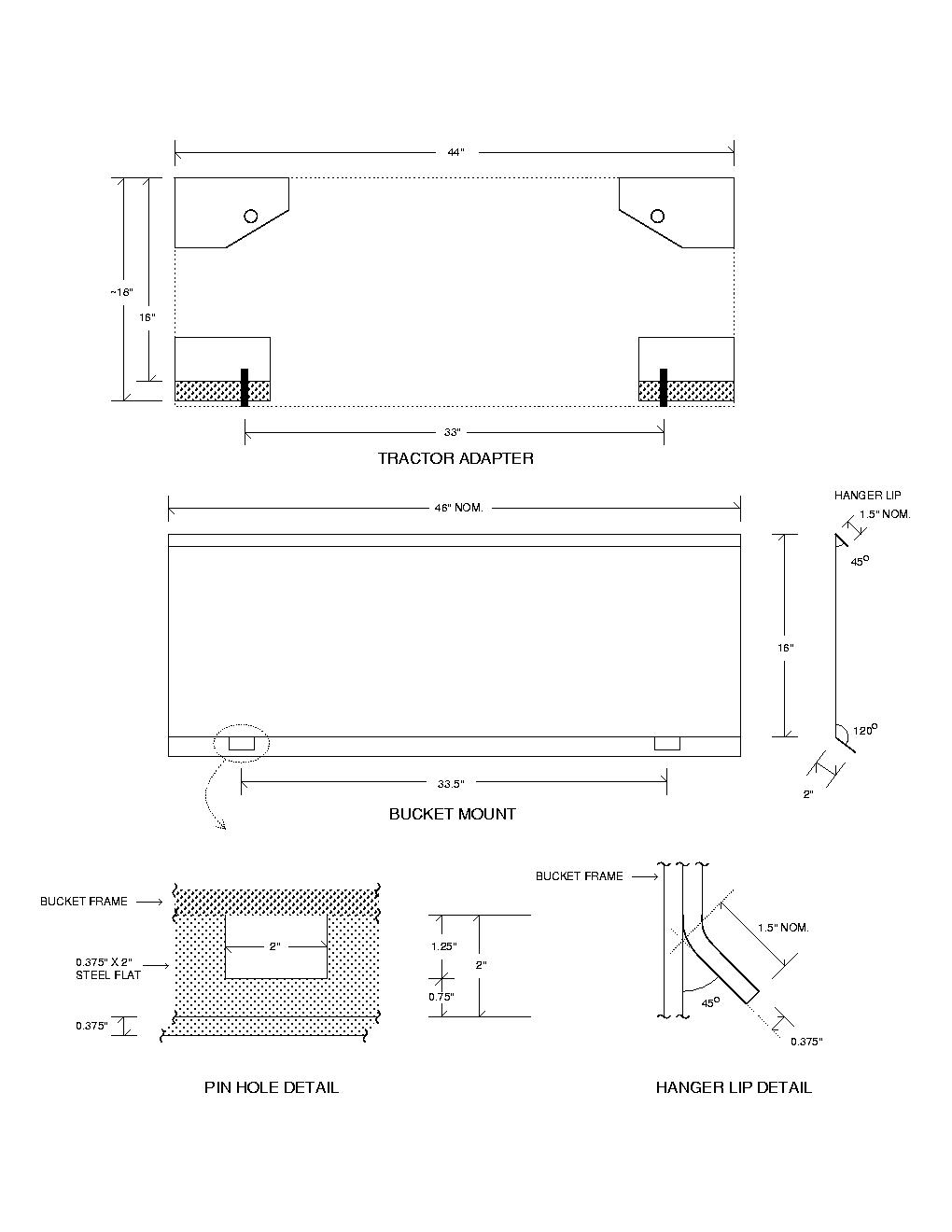

Does anyone have dimensions of Skid-Steer Quick-Attach Mount (Male Loader Side)? I'm trying to build one, saw uhmgawa and someone else posted dim's & pic's, but can't find 'em now. If anyone can help navigate to links or re-post, I'd sure appreciate it! Thanks,

It sound's like you're switching and you'll be needing a ssqa "plate". I'd just get one and do a little "reverse engineering". I've got a wooden template for the vertical dimensions and both angles (for building the attachment side) that I could measure it you like.

I'm building the male side that attaches to the loader arms, the part that has the levers and pins that attaches to the ssqa plate. Thanks anyway...

Borrow or even rent a good name brand bucket or forks, any attachment that mounts by SSQA and use it for a "JIG" to build the loader side That's the way I built the one for my kubota, and everything I've ever hooked it to fits very well.
That's what I meant with "reverse enginer" it. A plate (the fm side) should give you all the dimensions that you need to build the tractor or "male" side with the exception of the levers. If I were building one, I might try to locate some of the lever/springs & pins for the latching mech. from a skid steer or tractor and just buy those parts. Here is one place that might sell the whole part from a used machine Wengers Of Myerstown - Farm Equipment, Agriculture Equipment, Tractor Parts, Construction Equipment, Construction Parts and I'm sure that there are others around the country. What is your project? And :welcome:

Go to your local skid steer dealer and buy one (that they have in their junk pile) that they've replaced for some reason. I've bought two and they charged about $100 each.

This side is what he wants.
If it is in there junk pile, I don't think I would want it.
