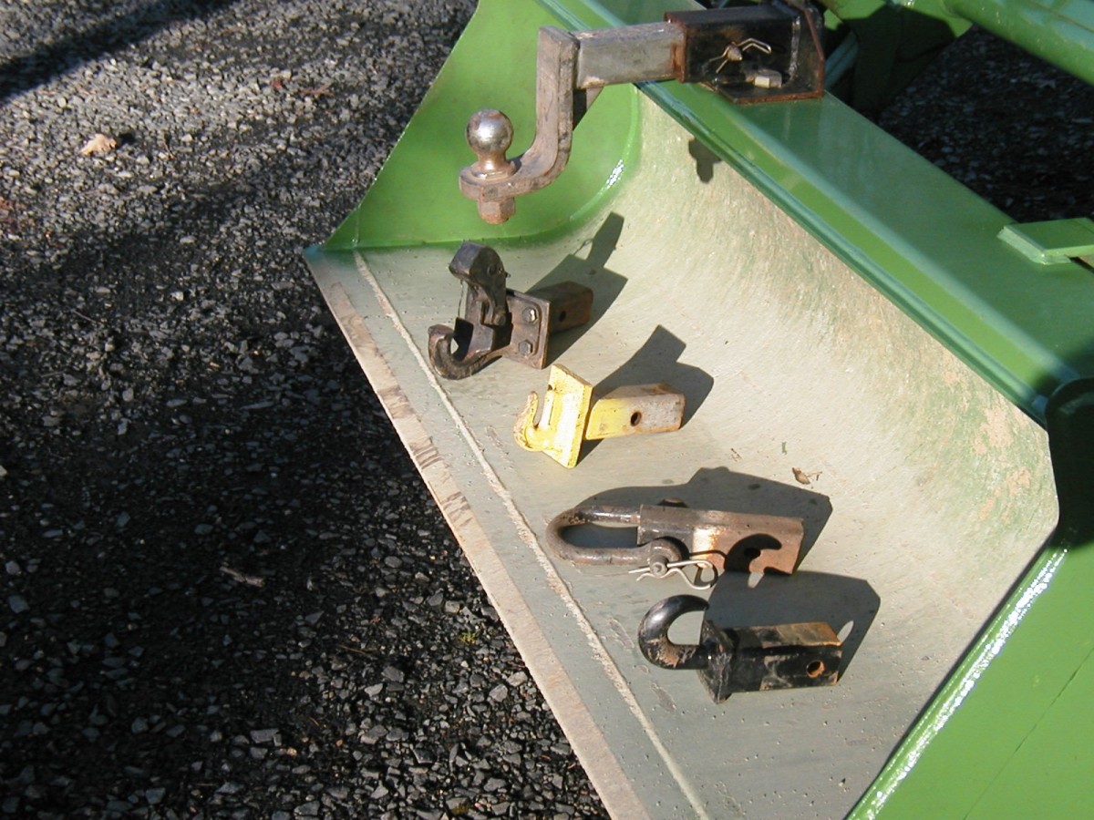

Alpha Dog ,
One of the TBN members built this setup.

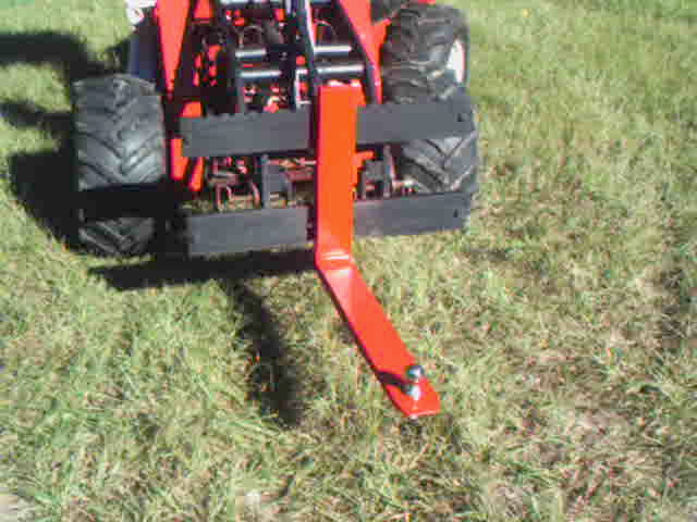

I installed a 2 in ball in the end of one of my forks to move trailers.
