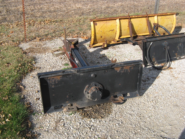

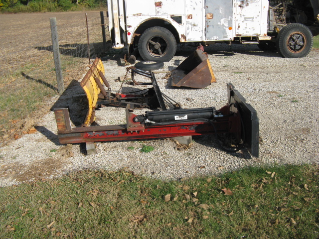

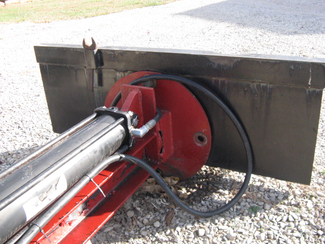

Here are some pics of my splitter.It rotates on A hub & spindle off A 3/4 ton pick-up.I didn't get pivot point just right,but I can still rotate it fairly easily.I can split most pieces at least twice, & some of the bigger ones even more. I split most of A cord & never get off the machine.With A little practice you can stack as you split. Mike
