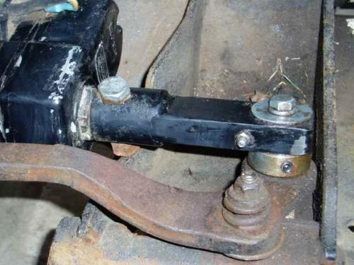

Here is an example .

This seems to be the post with the photos you attached. I think that it is the best way to go. The real reason is that the handles do get covered in runny manure and its not feasable to be running to wash the SS every time it gets dirty. this seems like a good cheap solution and I should be able to incorporate it into the panel and make it look neat.
