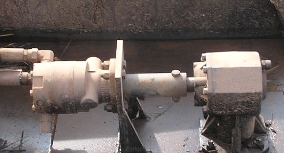

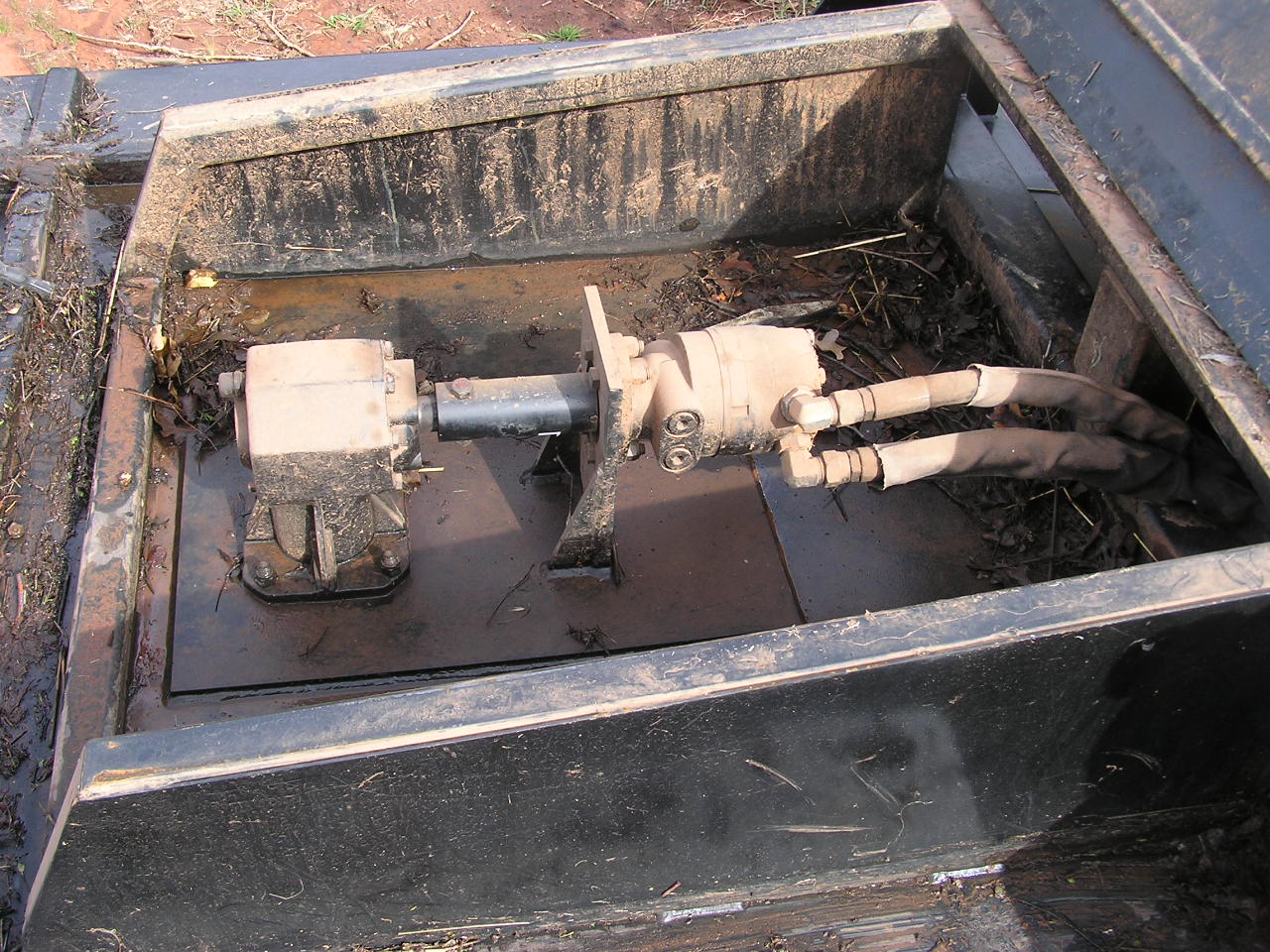

What is the best way to connect the gear box and motor? Thanks for any help
Ours uses a coupler and the shear bolt. The cushion valve is built in to the motor:
Note the 3/4" hoses:
