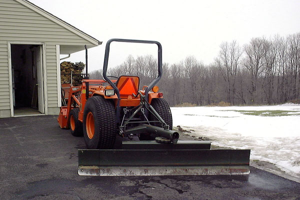

Mike,
I drive in reverse and push the snow. Here is a photo of my old tractor with the back blade on.
